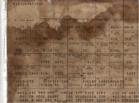

My 06D built (from trim tag) LS6 was actually completed in the 1st week of July and was fitted with an R79W. Nick, have you entered yr LS6 in the LS6 Registry ?
http://img.photobucket.com/albums/v6...ocs_0005-1.jpg

1 Attachment(s)
my LS6 is a late built April car with R79W
