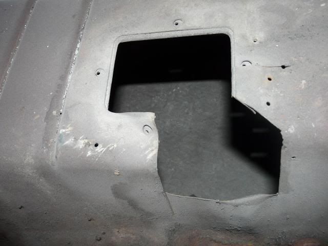

beater68427 02-07-2010 10:21 PM
Re: 4 speed location
This is a factory hole slightly modified in beater
