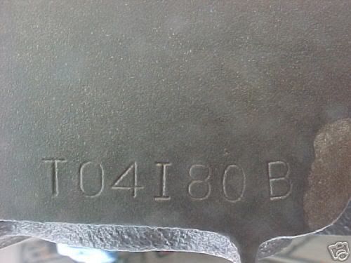

Does this stamped #1 look correct for Tonawanda
1 Attachment(s)
Just curious, since I have seen so many variations of the number one stamped as 1 or I, does the 1 in the photo look correct?
Thanks
BARRY 09-13-2009 10:32 PM
Re: Does this stamped #1 look correct for Tonawanda
restamped
SGC 09-13-2009 11:00 PM
restamped
Thanks Barry. Have had some members disagree with you and show correct stamps with the same #1. Why do you think it is a restamp?
JRSully 09-14-2009 04:25 AM
I's instead of 1's have been used/seen/verified many times on Tonawanda BB's

BARRY 09-14-2009 05:49 AM
hi the 1 and i are not the problem the024 is not right in my opinion

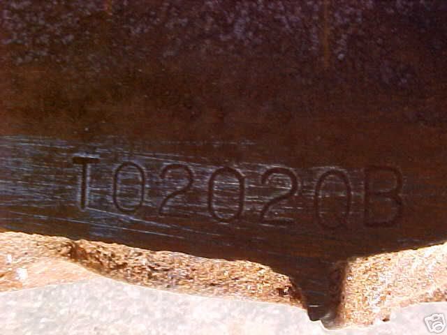

SGC 09-14-2009 06:26 AM
1 Attachment(s)
Thanks for the opinion Barry. The 024 is correct. I assume your not an authority on the issue; however, I appreciate the opinion. Received lots pictures to confirm the stamp is original. Including the one attached above. Thanks again.
SuperNovaSS 09-14-2009 06:36 AM
How can anyone tell one way or the other when it is painted?
Jason
Kurt S 09-14-2009 07:03 AM
Unless you're comparing to another pad pic with a very similar date and same suffix, there's no way to tell for sure. Add it that it's out-of-focus and painted and any guess is just that - a guess.
I have several close TKO pics, this one looks OK, but there's a couple of things that may be a problem. Can't tell without a better pic (preferably with no paint...).
Verne_Frantz 09-14-2009 08:01 AM
Here are some 0s, 2s & a 4 for comparison. These are confirmed originals.
http://i83.photobucket.com/albums/j3...e/assydate.jpg
http://i83.photobucket.com/albums/j3.../Assystamp.jpg
