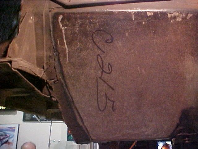

I'm getting ready to put the engine back in my 66 Corvette and was cleaning the engine compartment when we noticed these markings on the firewall. It is "f431".
Initially, I thought that it stood for F41 suspension. Does anybody know for sure?
[image]http://i422.photobucket.com/albums/p...u/IMG_8002.jpg[/image]
Thanks, Ed

Could be the "Job No.". Check to see if the vin# is within 5 digits of "431" or "931" to be sure.

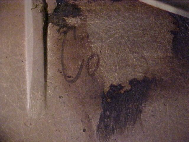

It’s the job number. One letter and three numbers. Located on the engine side of where the passenger’s feet should go. Below the heater box. You will also find the same job number on the back tube. I've posted a few reference pictures for you.
http://img.photobucket.com/albums/v4...gsAssembly.jpg
http://img.photobucket.com/albums/v4...assMarking.jpg
-Dave

That is very typical of all Corvettes. Heck, we just finished working on an '82 coupe, 37k original miles that had its job on the firewall too. Nice find, I remember talking to you about the car Ed.
