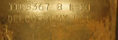

It's wierd, I thought that the date code on a starter always read as "year, month, day"
Example http://i271.photobucket.com/albums/j...08367_8l14.jpg
68, 307 starter, Dec 14th

Mr70 08-18-2009 09:44 PM
Re: Starter Date Question
I'm not sure of it's date,but it's not uncommon.
The seperate number 1 or 2 afterwards stands for shift.
Your two picture examples are actually L=November,(They skipped the letter I,cause it resembled a 1.)
And the F=June,not May.
