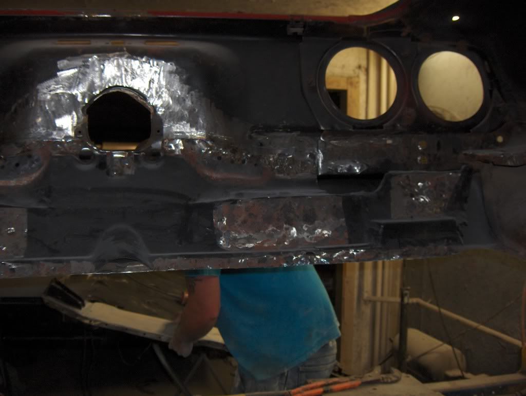

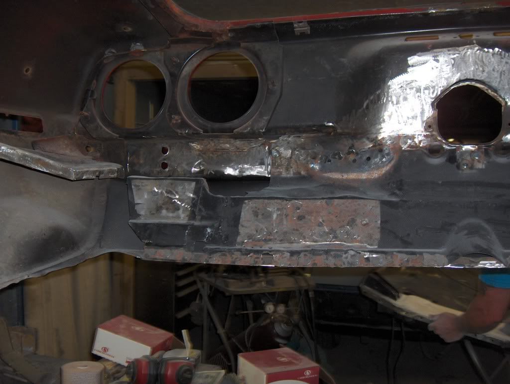

I looked for a used one for over a year and never found one so we made one from scratch using the rusted original as a guide, also no one makes toeboards or inner rear wheelhouses so we fabbed up those also. I wish you luck.

Try Desert Valley Auto Wrecking in Phoenix, if they have one they will cut it out and ship it to you. They are the the cheapest but they typically come up with nice dry western sheet metal.
When doing my 71 I was lucky enough to have a panel that was could be saved. These things take a beating and are usually hacked up by the previous metal butchers trying to do bodywork.

Something to think about with the western salvage yard, in order to get the inner valance you either have to drill all the welds on the outer valance, trunk floor/drop offs and frame at $$$ per hour (and there are alot of spot welds) or bite the bullet and pay the big bucks and have them plasma cut it out which will trash the trunk floor/drop offs, rear frame and quarters and you will pay for it like you bought all those pieces. A good fabricator can make one of those in a day.
http://i293.photobucket.com/albums/m...D/HPIM3067.jpg
http://i293.photobucket.com/albums/m...D/HPIM3068.jpg
