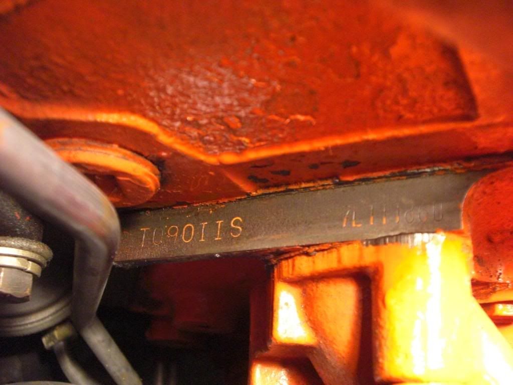

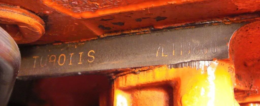

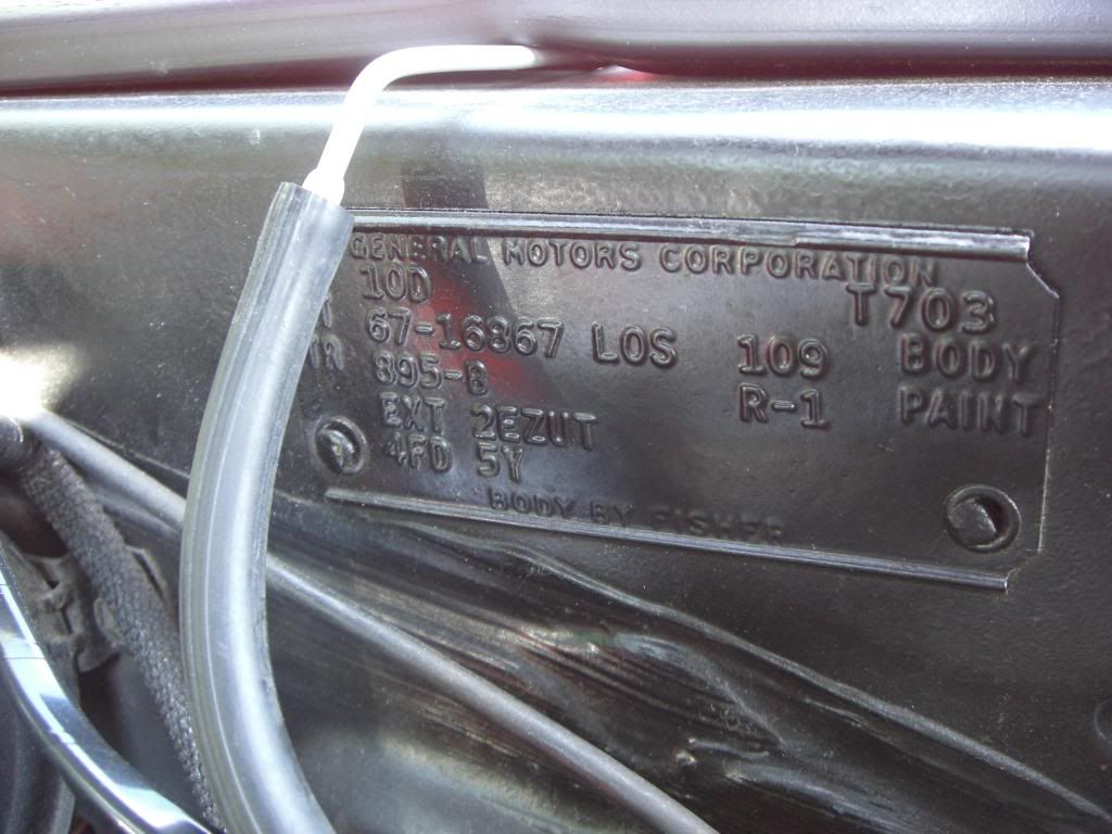

Stefano 06-19-2009 04:41 AM
What do you guys think of this pad and trim tag?

budnate 06-19-2009 06:35 AM
Re: What do you guys think of this pad and trim tag?
cool piece, trim tag fonts match my Los tags, lets see some pic's. https://www.yenko.net/ubbthreads/imag...ins/3gears.gif
-----Broach-marks appear good as well......Bill S
427425 06-19-2009 07:53 PM
Why the scratches on the water pump and head by the vin# They look recent compared to the engine paint.
Mr70 06-19-2009 07:59 PM
I was looking at that too.
Stefano 06-19-2009 08:43 PM
The water pump has original casting marks/lines and the paint was removed when the pad was cleaned up with a razor blade and some steel wool. The restorer had repainted the engine pad. This engine was to have never been taken apart?
YENKO DEUCE REGISTRY 06-19-2009 10:03 PM
To my untrained eye; the TT looks real, the engine assy date looks real, the vin stamp look suspect - especially the last 3 digits.
Zedder 06-20-2009 03:08 AM
Pad looks good to me and the water pump comments from Stefano are accurate. I'd want to see the other side of the trim tag before making a call on that.
