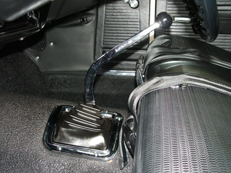

m22mike 06-16-2009 04:41 PM
Re: Shift boot trim plate
Chrome,as already stated.
8400 mile rubber mat car
http://i18.photobucket.com/albums/b1...e/DSCF5041.jpg
https://www.yenko.net/ubbthreads/imag...iggthumpup.gif
