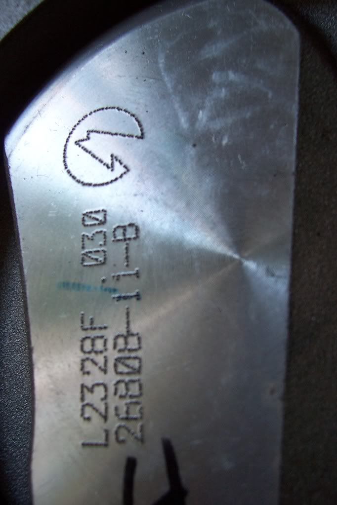

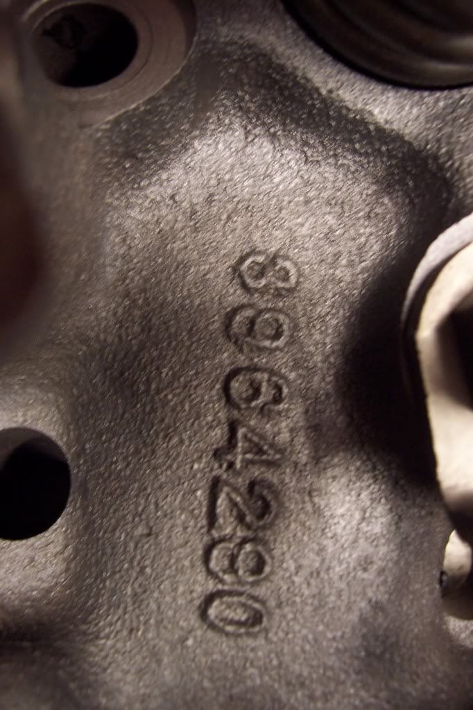

What brand and part # are the pistons? Which heads (casting #) are on the engine?
Eric, here are pictures of the head casting numbers and the new pistons (Federal Mogul) with the part numbers... Everything is basically stock and there were no issues with clearance.. The lifters are just regular hydraulic lifters as far as I know...

VintageMusclecar 06-07-2009 07:10 AM
Re: What is wrong with my motor? Figure this one out!!
Rich;
Bad news...I think that may be your problem. Those pistons are the L78 style replacement pistons. While they are listed as "closed chamber" pistons, note that the chambers are not the same between rectangular port and oval port heads. The L78 pistons are known to just slightly hit the corners of the chambers on an unmodified oval port head. I've ran into this issue myself in the past, and another member on here ran into it a few years ago as well.

VintageMusclecar 06-07-2009 07:35 AM
Rich;
Normally the pistons don't hit very bad, just enough to leave witness marks in the domes that are maybe .010-.020" deep...but that's still more than enough to create a h*lluva racket when the engine's running. Needless to say this isn't good for the engine, so I would strongly advise against running it any further. I would advise discussing this issue with your builder before doing anything else.
If there is any "good news" to the situation, it's that the problem can be alleviated by slightly relieving either the domes or the chambers at the point(s) of interference. Other than that, the only choice is to remove the L78 pistons and install the correct L34 style units with a smaller dome which is designed for the oval port heads.
One other thing to consider is that the L78 pistons will give you close to 11-1 compression, so you'll have to run good gas should you decide to leave them in.
