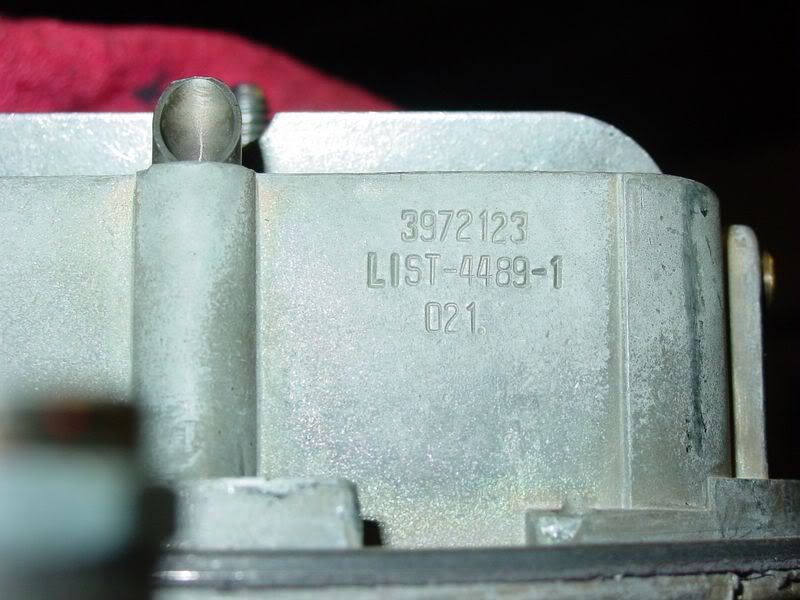

anyone decode this carb?
4489 021A

From my research, it is a 70 camaro 302 california.
What is the carb on a 70 Z28 california 4sp? 4555?
Johnny Horsepower 02-10-2009 08:25 AM
Re: carb identification
ok Nasty z28 says the 4489 is for a LT1 califonia manual tranny
http://www.nastyz28.com/camaro/z28lt1.html
this makes sense, since this carb is on my cal sold 4sp 70 Z
I was thinking it should be the 4555 but I guess my carb is right.

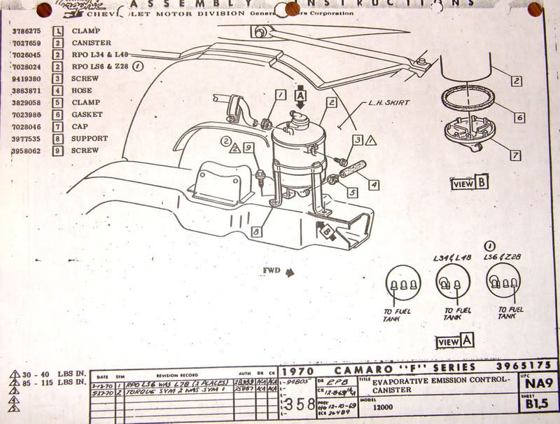

If you are running a 4489 I think you should be running a heat shield and a 7028024 canister????
http://i271.photobucket.com/albums/j...8/P2240051.jpg
I dont have the sheet to load showing the shield but I can do it later If you need it.
I'm not the ultimate authority on this but my car runs the 4554 and assuming yours was set to go to a calf dealer you would be running an NA9 also.

Ill send a copy of the applicable sheet tonight for you to review.
Carl

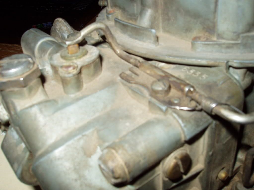

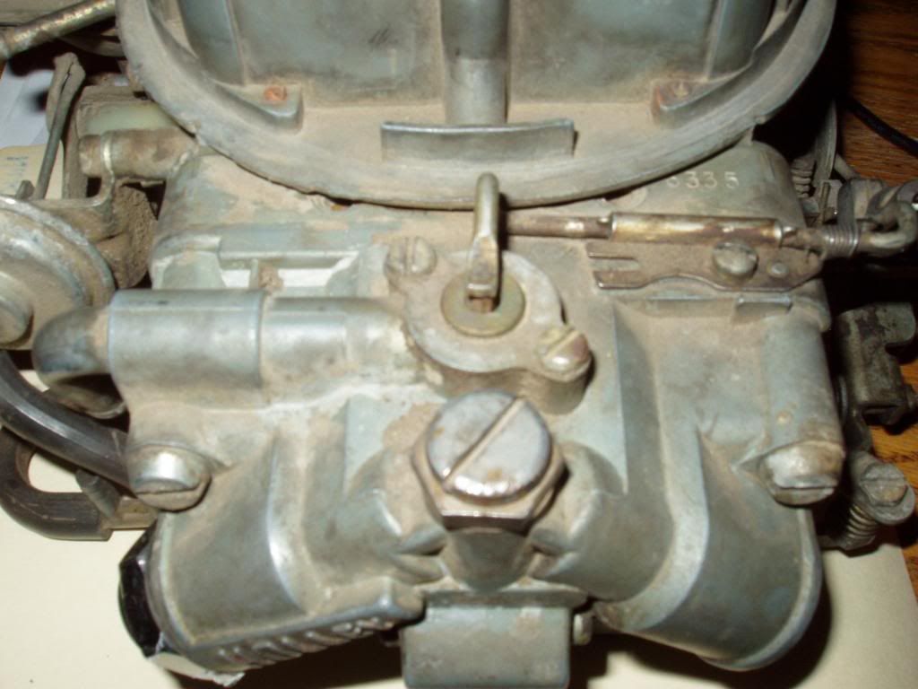

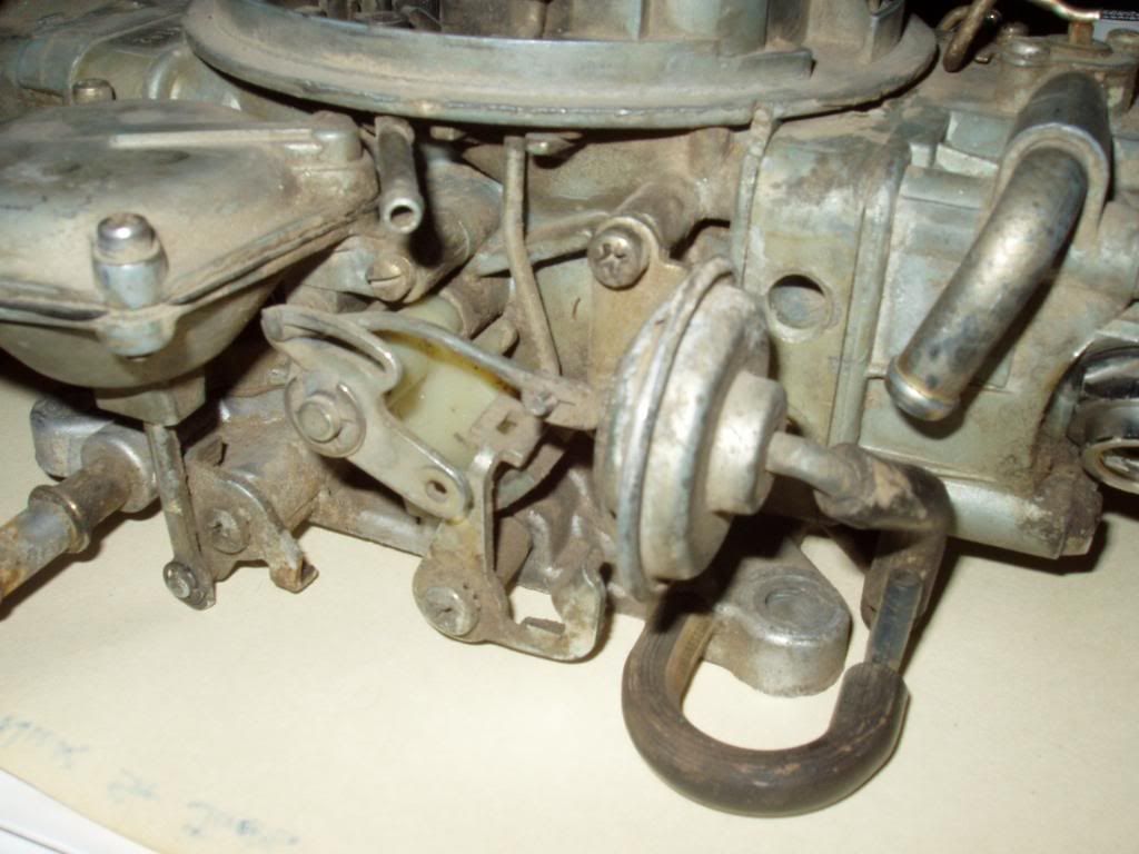

This is the NA9 bowl
http://i271.photobucket.com/albums/j...2050089006.jpg
http://i271.photobucket.com/albums/j...2050086003.jpg
http://i271.photobucket.com/albums/j...2050088005.jpg
Much different than the 4555
This carb is a 4554
