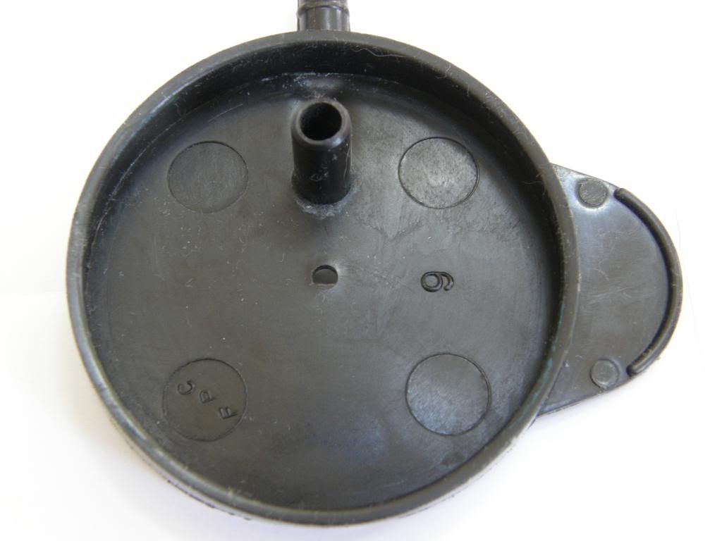

I was wondering about these caps. I have two I assume they are originals and not repops thee are slight differences between the two.
Any input?????

COPO 70 RS/Z28 12-30-2008 06:04 PM
Re: Washer tank caps
OK,
Here is the question....
Assuming originality (I dont have a clue about these) Cap one has a ridge partial on the lift tab but cap two has a ridge all the way on the lift tab.
Does anyone know the application of these or any other info. one is off a 67 and one is off a 70. What about the different numbers underneath??
Thanks
https://www.yenko.net/ubbthreads/imag...mlins/hmmm.gif
https://www.yenko.net/ubbthreads/imag...iggthumpup.gif
JohnZ 01-03-2009 04:58 AM
The numbers are cavity numbers - those caps were shot in multiple-cavity injection molds, and each individual cavity was numbered for internal traceability.

The partial ridge cap is correct for 1969 and previous years; not exactly sure how far back. The full ridge cap is correct for 1970 and up.
