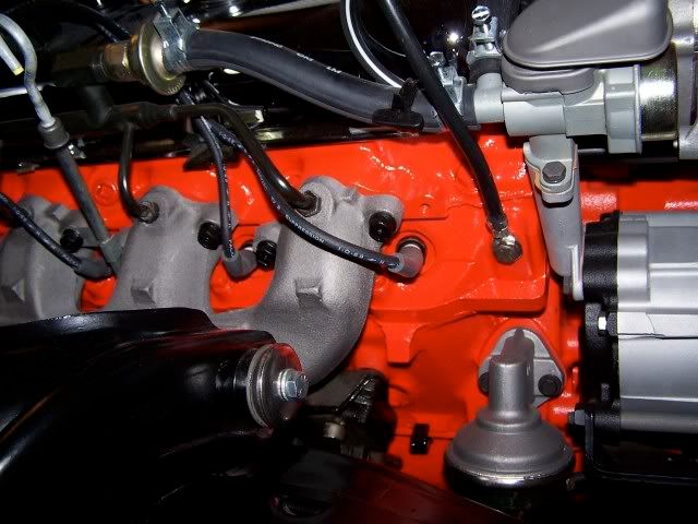

Bill Rose 11-30-2008 02:53 AM
Re: Neg battery cable
I should have said head, not block. Anyway, thanks for the help. I think this is correct.
http://i533.photobucket.com/albums/e...e/100_2077.jpg
Mr70 11-30-2008 03:04 AM
Yep.
