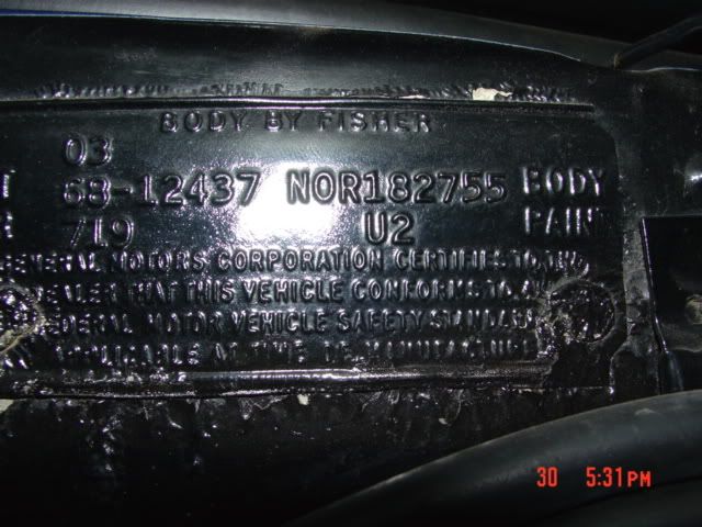

It sounds as if the "03" is really "08" since that would make more sense. Could it be a light stamp with the 8 or maybe someone grabbed the 3 instead. Some guys can tell you if the body number and VIN are in line if you post the numbers.

Howard, my '68 Z is a Norwood-built car with an "03D" build date and VIN of 402672. Hope that helps. Tex Timberlake

Your car was built in July 68.
see this chart at CRG ," 1967-1969 LOS/NOR End-of-Month Monthly VIN Report:
http://www.camaros.org/geninfo.shtml
scroll about 1/4 way down that page.
Mike

rubbinisracing 12-01-2008 09:22 AM
Re: 68 Camaro questions...
Trim Tag picture
http://i142.photobucket.com/albums/r...8Camaro006.jpg
