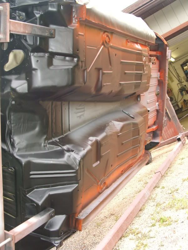

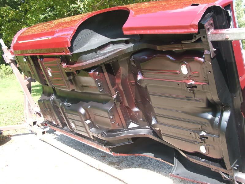

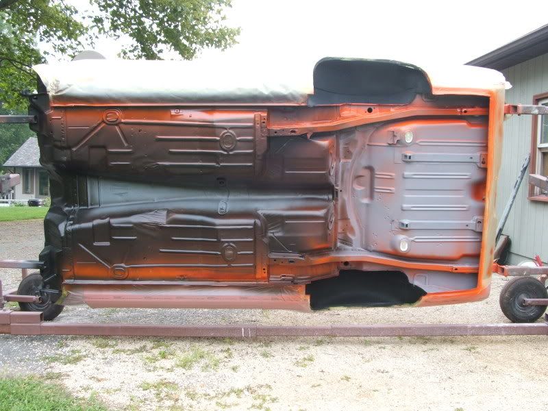

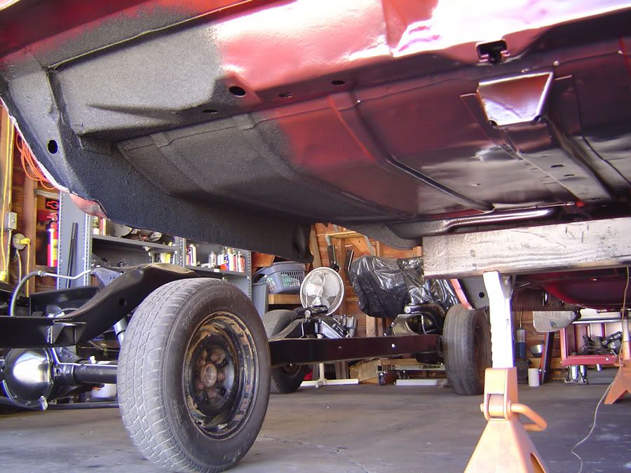

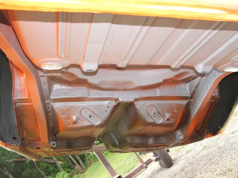

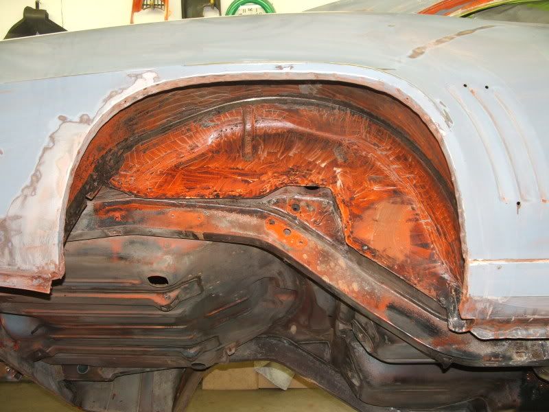

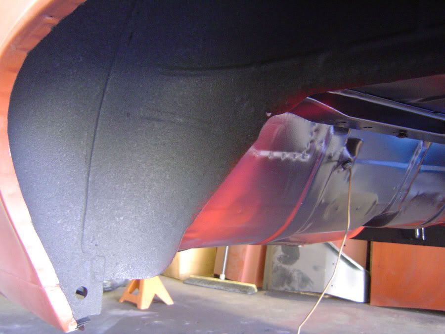

Here are some of a Hugger Norwood car I did. And one shot of a Nova for grins, the Nove shot shows the undercoating detail pretty well.
http://i18.photobucket.com/albums/b1...Paint032-1.jpg
http://i18.photobucket.com/albums/b1...POPaint038.jpg
http://i18.photobucket.com/albums/b107/m22mike/109.jpg
http://i18.photobucket.com/albums/b1...POPaint035.jpg
http://i18.photobucket.com/albums/b1...Paint105-1.jpg
http://i18.photobucket.com/albums/b1...POPaint106.jpg
If you are doing the overspray thing to the floorpans, the floor plugs should be in place for the final body color, I forgot that on this car.
Also do not try and do the OS with base clear, have a pint of Single stage mixed up and use that.

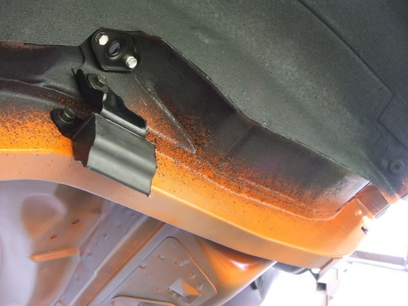

Yup, every one was different. And it is hard to capture in a restoration just how sloppy these cars could be.
I will be the first to admit that the cars I have done are nicely "overestored".
The overspray detail is, at best, a interpretation of what was there at build.

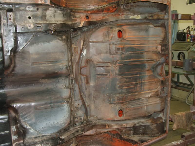

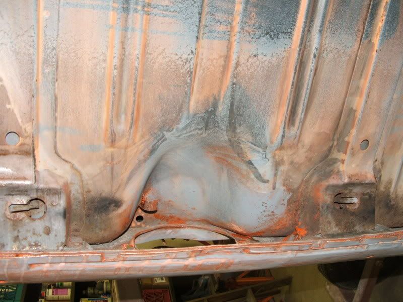

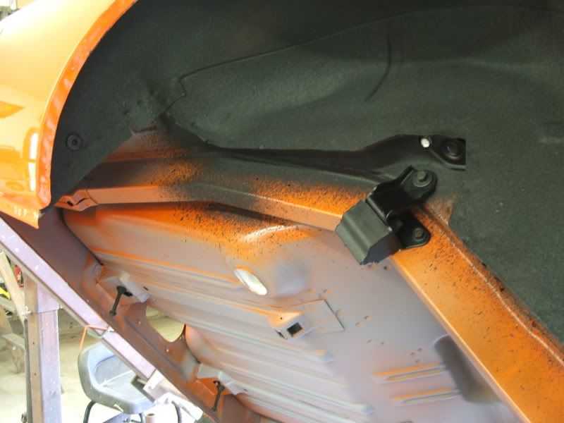

Here are a few shots of that same car during the first clean up.
http://i18.photobucket.com/albums/b1.../copo188-1.jpg
http://i18.photobucket.com/albums/b1...ke/copo192.jpg
http://i18.photobucket.com/albums/b1.../copo196-1.jpg

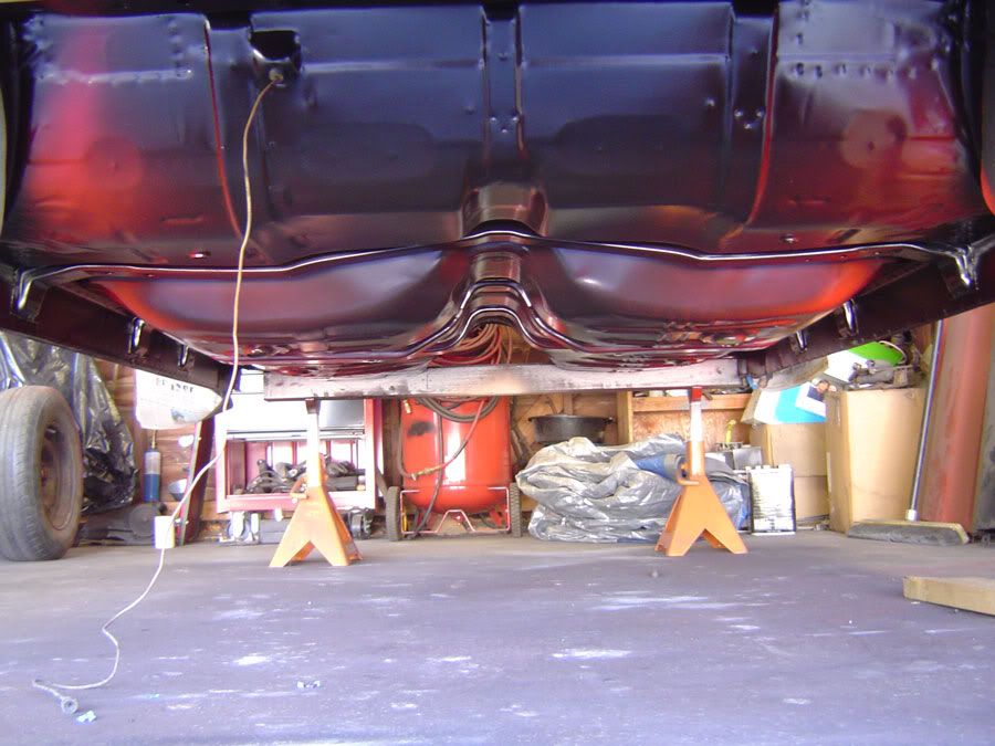

Nice. I think adding the overspray is so cool. Real nice detail feature that makes a car that much better. Mines not a Camaro but I did redo the overspray...
http://img.photobucket.com/albums/v3...doneunder2.jpg
http://img.photobucket.com/albums/v3...doneunder4.jpg
http://img.photobucket.com/albums/v3...doneunder5.jpg
