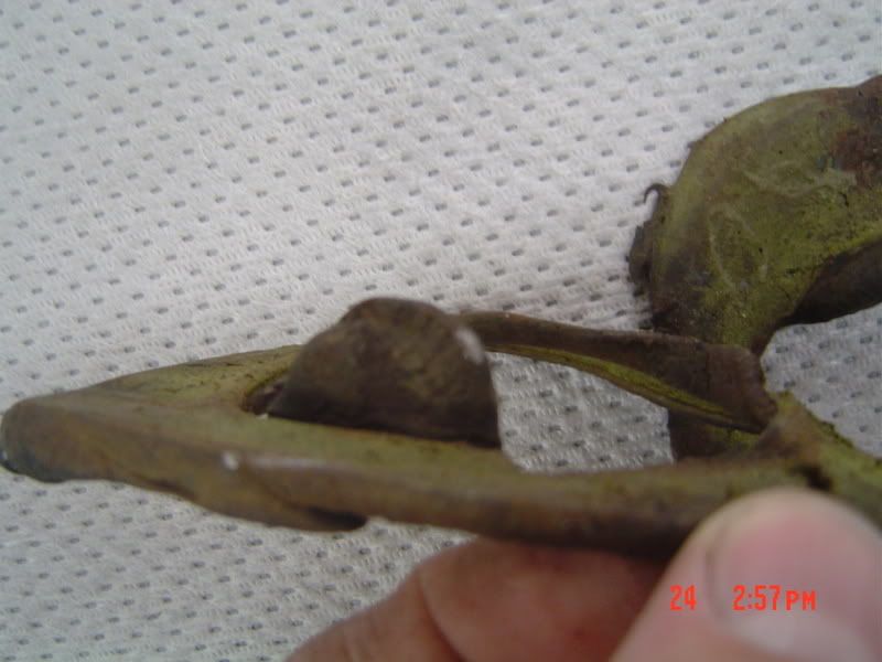

bkhpah 04-26-2008 07:31 AM
Re: Drain plugs on floors
Here is the green sealer as removed from my 69' Nova. You can still see the sag that fell though the hole, sort of frozen in time. Here are the original drain plugs back in place, re-galvanized with Franks own special green sealer. A dead on match. Not one plug on my car has a date, and I was the first to ever remove them...BKH
http://i61.photobucket.com/albums/h5...h/DSC04343.jpg
http://i61.photobucket.com/albums/h5...h/DSC04344.jpg
http://i61.photobucket.com/albums/h5...h/DSC04340.jpg
Paul_S 04-26-2008 07:27 PM
Looks Great. Where did you have them re-galvanized?
