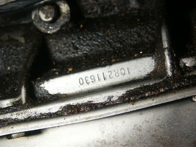

Here's your Trans Stamp !!
http://img.photobucket.com/albums/v4...p/LS6trans.jpg
ssl78 03-06-2008 07:05 PM
Re: Survivor LS6
I think it probably is the original stamping. It looks like there are some broach marks under the rust on the engine. With the amount of surface rust on the engine it would have had to been stamped a long time ago. The digits look real close between the engine and trans of coarse they would be more deeper and look a little wider in the trans since its aluminum
ORIGLS6 03-06-2008 07:47 PM
Re: Survivor LS6
Stamped upside down. Same as my Arlington car.
PeteLeathersac 03-06-2008 08:04 PM
Re: Survivor LS6
The 5'th digit '1' appears to have been a slightly longer piece in the gang and the resulting deeper hit on both is a good sign too!.
https://www.yenko.net/ubbthreads/imag...lins/beers.gif
~ Pete
firstgenaddict 03-06-2008 10:35 PM
Re: Survivor LS6
Both Vin stamps display the same characteristics... they look good to me. https://www.yenko.net/ubbthreads/imag...iggthumpup.gif
