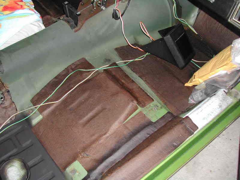

I have a LA built 70 Z28, Citrus Green, and noticed that the underneath has been undercoated. There is no red oxide primer as in the Norwood cars but a dark green primer color of sorts. This same color was painted inside the car sheetmetal as well. What would be the correct color for resto on an LA car? What was their normal practice for painting the undercarriage? Thanks,

The 2nd Gen L.A. Camaros were primered in a shade of BLACK.
I doubt if anybody could explain why your car has DARK GREEN on it ?????. Could you explain where your underbody is undercoated and/or to what extent. At Camaros at Carlisle 2005 the judges had a involved discussion about 1970 Camaros receiving NO factory undercoating other than the rear wheelhouse area and some of the trunk extension..

The underneath may be a shade of black. I will remove some of the undercoating and check. Under the carpet is definitely a green color, darker than the Citrus green exterior. I will post some pics tomorrow.

Here are some pics of the floorboards from my Citrus Green LA built Z28:
http://i3.photobucket.com/albums/y86...6/DSCN0390.jpg
http://i3.photobucket.com/albums/y86...6/DSCN0392.jpg
Pass Side
http://i3.photobucket.com/albums/y86...6/DSCN0394.jpg
Drivers Side
Looks like there may be some dark grey/black primer there.
