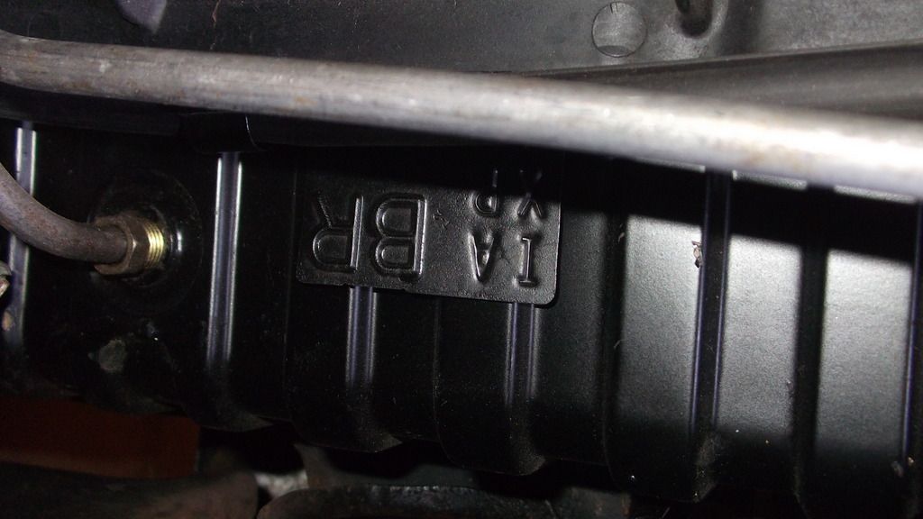

Woj 01-08-2016 12:43 AM
Re: COPO Chevelle radiator
<div class="ubbcode-block"><div class="ubbcode-header">Originally Posted By: wheelhop</div><div class="ubbcode-body">BR is the code for an automatic trans copo or L78 </div></div>
Jim is right. Here's the tag off my COPO.
Phil Woj.
http://i262.photobucket.com/albums/i...psudc8usxt.jpg
mockingbird812 01-08-2016 01:18 AM
That's a clean tag Woj!

Woj 01-08-2016 01:53 AM
<div class="ubbcode-block"><div class="ubbcode-header">Originally Posted By: mockingbird812</div><div class="ubbcode-body">That's a clean tag Woj! </div></div>
Sam,
I'm lucky on many levels with this car. The original radiator being one of them. This car spent a good portion of its life off the road.
I did blast and paint the tag when I had the radiator flushed. Amazingly, it was all original and not one leak. The radiator did get a fresh coat of paint, since a good portion of the original paint had worn away.
Phil Woj.
