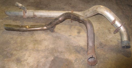

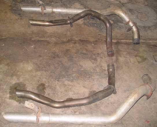

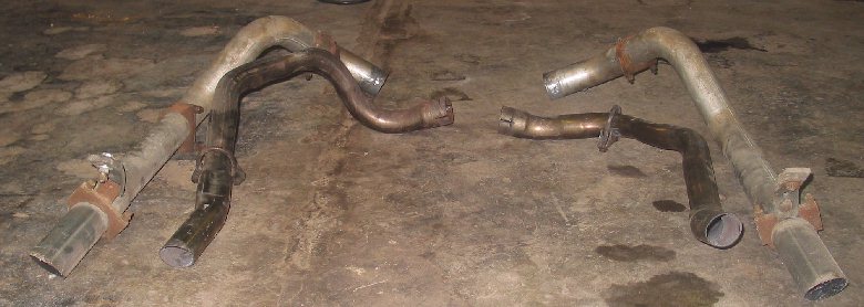

I finally got the "straws" off the Camaro yesterday. Check out the stock chambered tail pipes (which we have been running) compared to a set of 2.5" Flowmaster tail pipes (which everyone else has been running):

A lot of the places in the chambered pieces weren't even 1.5" in diameter! The Flowmaster pipes look like sewer pipe compared to the stock stuff!

We had a local speed shop dyno test a stock exhaust but for headers on a warmed over 454 LS5 Chevelle vs a 3" inch mandrel system and it meant just over 50 rear wheel HP and 4O foot pounds of torque. Those stock systems with all the crimps and bends are very restrictive.
