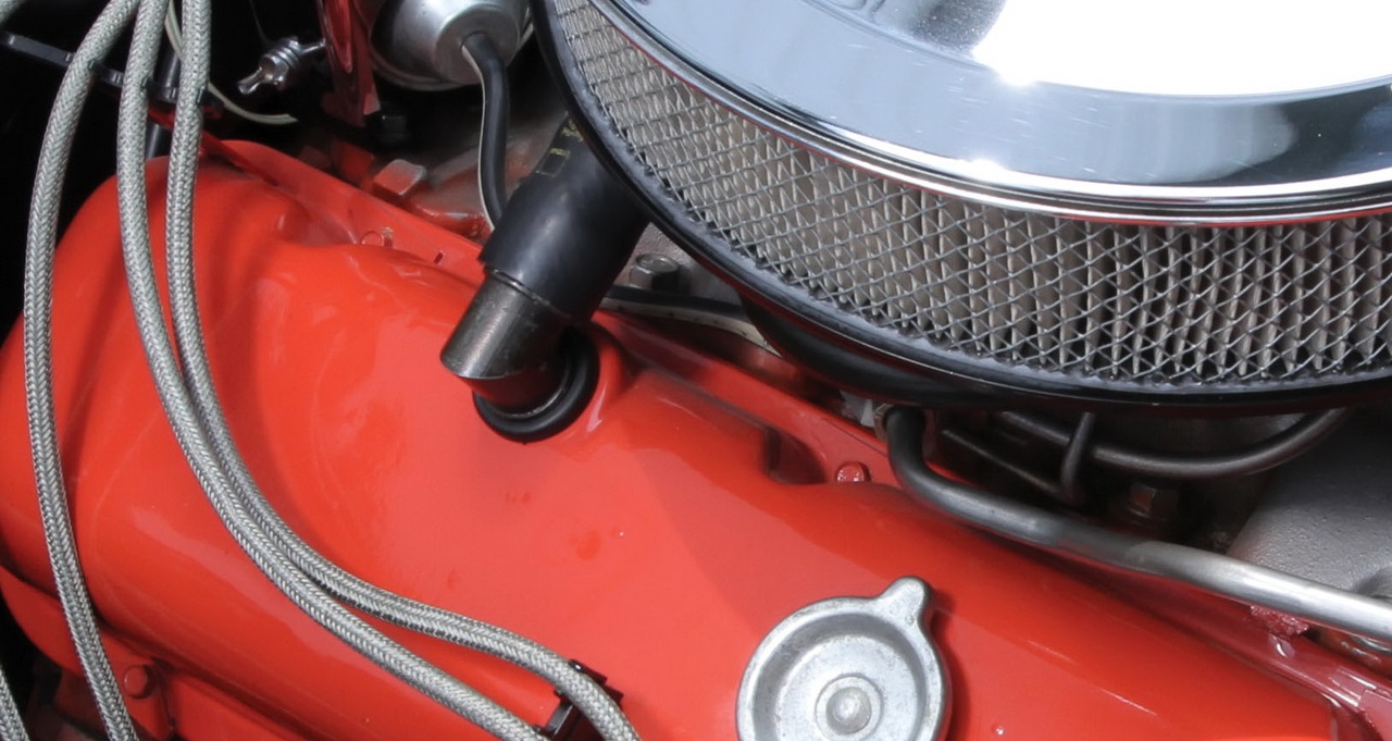

m22mike 12-03-2020 03:44 PM
1 Attachment(s)
Originally Posted by DW31S (Post 1525192)
I stopped looking when I saw the brake booster.
Yea, I got that
So does this mean the front engine hook was installed after the engine was painted......:haha:...I am sorry had to do it :grin:

olredalert 12-03-2020 04:21 PM
----Not only the bypass hose paint but way, way too much orange on the intake......Bill S

m22mike 12-03-2020 04:48 PM
Bill
That was my jab on the paint when posting the photo. Lots wrong with this car.

WILMASBOYL78 12-03-2020 04:51 PM
69 Nova...
Originally Posted by m22mike (Post 1525303)
Yea, I got that
How about those french locks on the exhaust manifolds...must have been a mid-year option :cool2:
olredalert 12-03-2020 04:54 PM
----Did not notice the french locks. Good catch, Tom! Shouldn't this 69 have a smog set-up?.......Bill S
WILMASBOYL78 12-03-2020 05:35 PM
69 Nova...
Yes...all the 69 4 spd cars had smog.
Exterior; headlite bezels are incorrect, there should be black paint between the rocker moldings, also missing the pinstripe that goes with that trim package, no trim rings on SS wheels, looks like chrome edge is absent from fender louvers...not sure why they left all the pieces of labels on the tires ???
Interior; door panels are re-pop [no Nova emblem], Muncie shifter should have a black knob, not sure what's up with the spare...looks like a used radial on steel wheel not in the right position.
Engine bay; The radiator support rubber flap has 70 style buttons...should be the T-clip version, negative cable mounts to the engine, hood hinges are incorrectly painted black, dip stick should not be painted, lots of little hardware issues.
underside; the completely painted bottom is not correct, orange oil filter???, and the list goes on.
Could be a nice car with some major cleanup of the problems seen and others we haven't noticed yet.

olredalert 12-03-2020 09:32 PM
Originally Posted by RALLY (Post 1525332)
Agree detailing is not real good. Overspray shouldnt be there. Painting the engine correctly on the engine stand and then bolt on intake afterwards. That catches your eye right away when you pop the hood and the engine lift brackets should of been sprayed too. Price is way to much for this Nova.
----Rally,,, To paint an aluminum intake engine the Tonowanda plant used masks or covers made out of pressed cardboard (I think). It would just sit down on the intake. After painting they piled up and were returned to the beginning of the line and were reused. They didn't fit too tight and overspray would creep around the edges. To add to that since the masks were reused they would suffer some deterioration and more overspray would get on the aluminum. On every original aluminum engine I have ever seen over the last 40 or so years there was some amount of Chevy orange but it varied from engine to engine. You can duplicate it pretty easily with a little thought, but installing the intake after the paint job would not appear factory correct. Hope this helps......Bill S
RALLY 12-04-2020 02:22 AM
Thanks for the info. Understand how that overspray could happen. That picture of this intake with the overspray is what was duplicated to look factory correct?
1971ls6 12-04-2020 02:22 AM
Heater hoses should be ribbed with no stamp. UPC bar codes did not exist in 69, alternator must have come from pep boys.
The corvette boys like to see some overspray from the mask, but they went overboard. Temp sensor in head looks like the wrong fitting.
Not a fan of the color and that will bring the price down. What’s up with the positive lead going over the battery to get to the junction block on the core support

olredalert 12-04-2020 04:34 AM
----No, that's somebody's incorrect take on Chevy orange intake overspray. It would never have been fogged over the first two inches of the intake runners. There would have randomly spotty orange missteps along the edges of the intake up against the heads. We are going to have to ask for some pics to explain what I'm getting. Hopefully someone can rummage up a few pics that show what I'm trying to explain. Help!......Bill S
Lee Stewart 12-04-2020 05:54 AM
https://i.postimg.cc/cCbjZJ7v/34z.jpg
https://i.postimg.cc/XNHt92Mn/34.jpg
Kurt S 12-04-2020 06:20 AM
I thought the masks were a molded plastic. But Bill's explanation is spot-on and Lee's pics show it. :)
