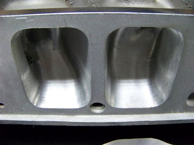

Motor is a 427 Bored to a 439ci, heads are 990 rectangular ports that were completely opened up by brandywine many years ago, cam is a bullet solid roller still waiting in intake to order it. Its going to be a fun street/ strip car. Depending on time probably not to much strip haha but want the power for when I need it. I'm sure I can get this car into the mid 10's with 4.56's. I've built a few race cars but nothing this old school.

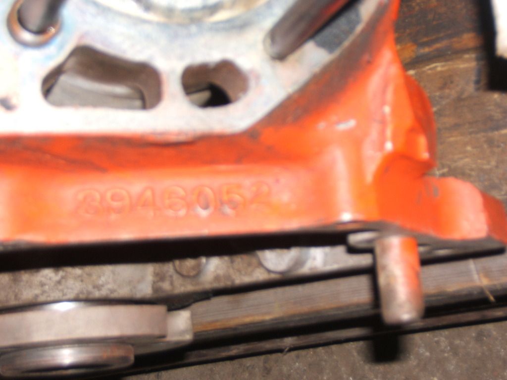

YES PAINTED &quot;052&quot; block, owner was sneaky

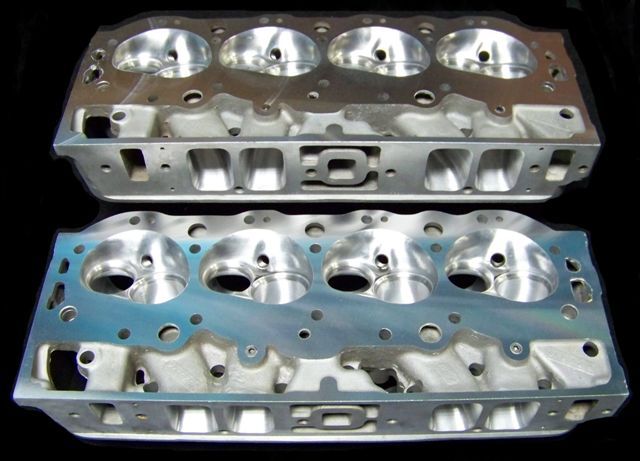

Some new/updated &quot;074&quot; heads
http://i1285.photobucket.com/albums/...pse58a33ea.jpg
http://i1285.photobucket.com/albums/...ps9389076e.jpg
http://i1285.photobucket.com/albums/...pscbf82b40.jpg

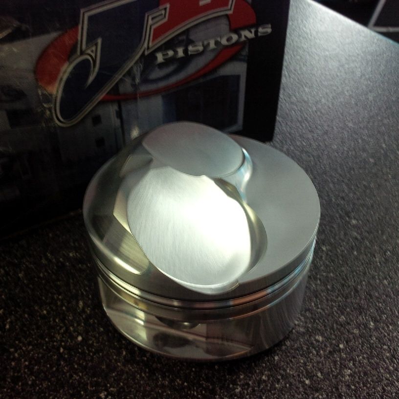

The FULLY CUSTOM STREET friendly piston, 14+-1 and 740+ &quot;street&quot; roller
http://i1285.photobucket.com/albums/...pseb27778a.jpg
