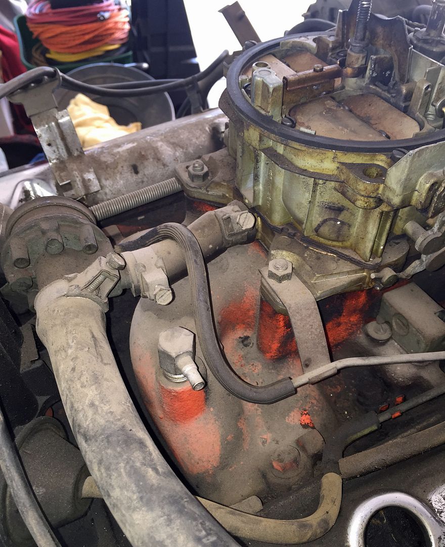

Yes, it has that cradle bracket for the smog hose (that goes to the back of the carb) to rest on.

427TJ 01-24-2015 11:47 PM
Re: 1967 L35 SMOG question
Choke and behind the carb:
http://i12.photobucket.com/albums/a2...psj3knhfmr.jpg
http://i12.photobucket.com/albums/a2...psgf7uaz2i.jpg
http://i12.photobucket.com/albums/a2...pstjpx6c6y.jpg
http://i12.photobucket.com/albums/a2...psllftme8i.jpg
Yeah, it isn't L78 or L72 cool but I'm digging it.
