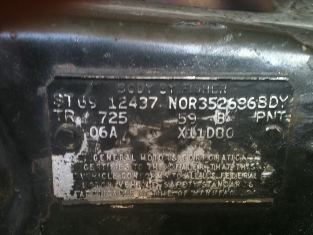

The BDY number/ vin is in line with other documented Copo cars. Curved neck radiator looks original, no RS backup lights in tail panel?, interior sprayed black. If that is a real BE its hard to imagine a coincidental swap with a date that is a known BE date and one that fits with the car date wise. I would expect this will be found out to be a real Copo, but being frost green/deluxe green interior it will take a dedicated person to restore this one. The selling dealer information that is imminent will be very helpful, if it turns out to be a known Copo dealer of course.

As I pointed out in the AprilL thread, it has a TH400 crossmember. X11D80 on the tag it shouldn't have a TH400 crossmember unless it is a COPO.

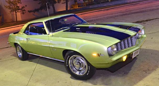

This car would be a real killer COPO if it checks out, and it has a lot of traits in place. IMO a very rare Frost Green COPO with a black vinyl top with X11 style trim, D80, and black pin stripes would be stunning. I do not recall ever seeing a FG COPO, plenty of Fathom and Rally green ones. This fresh Frost Green/ green interior Z/28 is a great example of just how cool that car could be....BKH https://www.yenko.net/ubbthreads/pics..._5601_copy.jpg

That green Z is beautiful. A shame &quot;off&quot; colors such as Frost Green, Fathom Green, and Gold get a bad rap, they look great when done nicely. Plus, those were THE colors bitd.

&quot;As I pointed out in the AprilL thread, it has a TH400 crossmember. X11D80 on the tag it shouldn't have a TH400 crossmember unless it is a COPO.&quot;
Jan, when you state this .... is that because if the car came with a big block motor and turbo 400 transmission and it was not a COPO then there would be a DIFFERENT &quot;X&quot; Code on the cowl tag?

Again other dates are good also rear stamping although unclear is a known BE date too.
Being a drag car its whole life it's lucky the cowl tag is even still there!

VIN 124379N664166
ST69 12437 NOR352686BDY
TR 725 59 B PNT
06A X11D80
