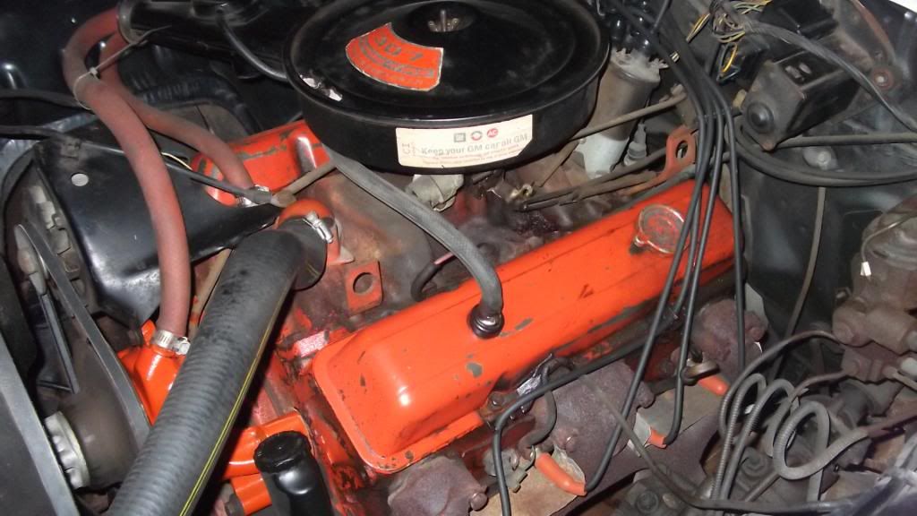

mockingbird812 06-05-2013 04:11 PM
Re: PVC Hose type
<span style="font-size: 14pt"><span style="font-family: 'Times New Roman'">I recently realized what appears to be a part number and date on my PVC hose. The date of &quot;<span style="font-weight: bold"><span style="font-style: italic">03 18 9</span></span>&quot; is consistent with the build date of 06A for my '69 Chevelle. Here is a shot of the top of the engine shortly after I bought the car in 2006...</span></span>
http://img.photobucket.com/albums/v6...sf0320ea6.jpeg

Mr70 06-05-2013 06:43 PM
Re: PVC Hose type
Sam
Leaks like you need some new fuel bowl gaskets.
That PCV hose you show is a current modern day issue,that should have the last 2 digits showing the year..example &quot;03 18 98&quot;.
Someone then wiped off the last digit &quot;8&quot; to make it appear as though it was 1969,which,to be from 1969,woulda shown &quot;69&quot;..not &quot;9&quot;.
That,and other things on it are a dead give away.
mockingbird812 06-05-2013 06:56 PM
Re: PVC Hose type
Aha! Other dates on hose are the same way. I'll take a closer look to see if they were tampered with. Nice pun (&quot;Leaks like...&quot;) Like I said, that foto was when the Chevelle was &quot;new&quot; to me.
