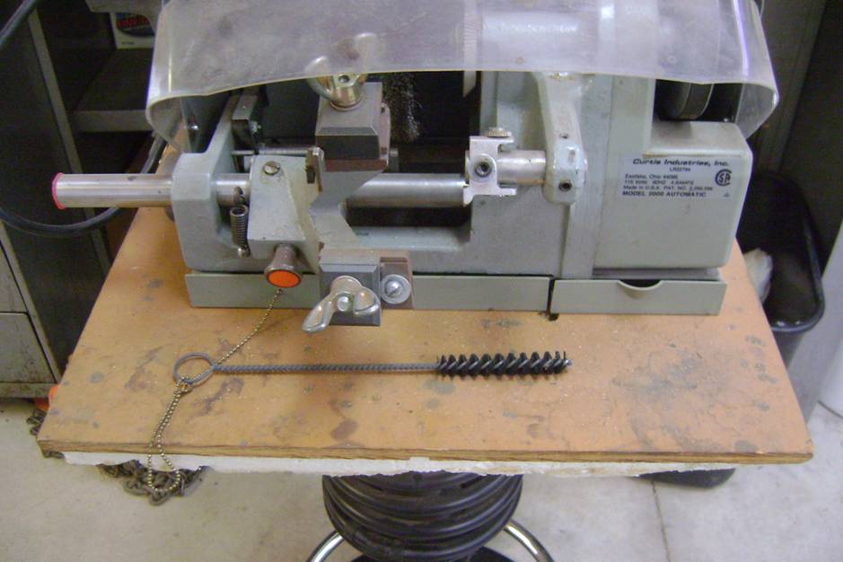

I have access thru a friend to Curtis Code Books that lists all the keycodes for different GM cars/yrs, same for Ford and Mopar. He also has a lot of key blanks, not all blanks are the same. He has a key machine to cut them as well.
https://www.yenko.net/attachments/use...rtis_book4.jpg
https://www.yenko.net/attachments/use...is_machine.jpg
https://www.yenko.net/attachments/use...ey_blanks1.jpg
https://www.yenko.net/attachments/use...ey_cutter2.jpg
