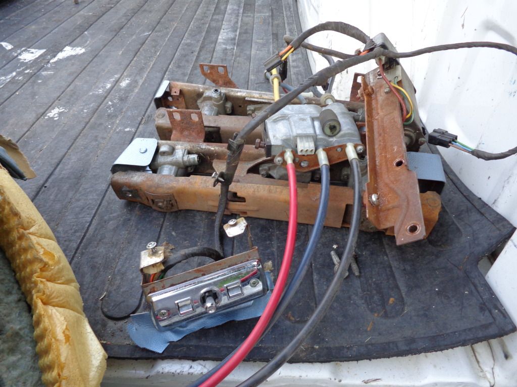

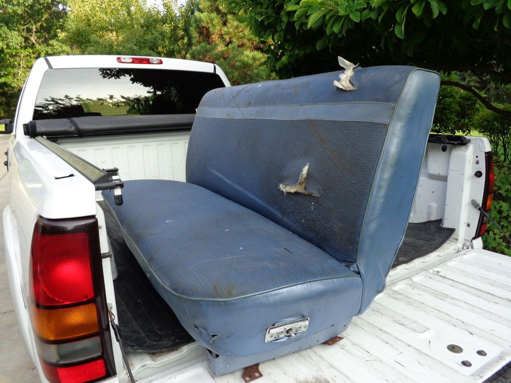

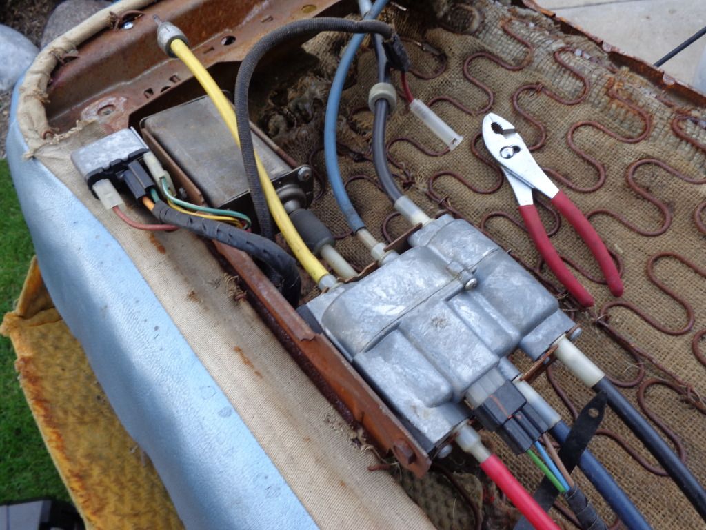

The education continues...........I bought a Power Bench seat out of a 4 door car off ebay.....and my thought was that maybe the bench seat bottom would be close enough that I could modify it to work with the Strato seat back.......went and picked it up and it was in pretty good shape with just minor surface rust.......and as a bonus the seat motor and mechanisms worked.....so...I took it apart and realized that the seat frames weren't even close.....Oh Well!!! At least I got a good Power unit and some spare seat springs that might come in handy later.....And I found another Strato-Bench for a 4 door car (Non movable seat backs) ......So I bought it as I should be able to piece together one seat out of the three....LOL......Don't ya just Love it when a plan comes together..........Time for plan &quot;C&quot;......
