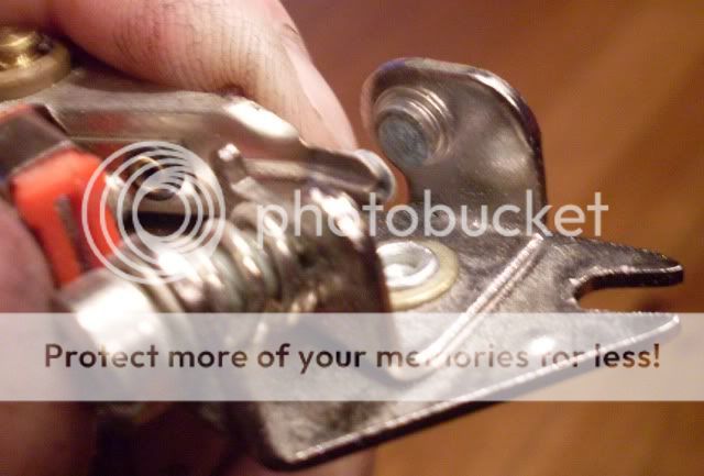

Pulled it out in the driveway and then it wouldnt start - no spark. Turned out I burned up another set of points. I think I'll go back to a stock Delco ignition coil. The Pertronix FlameThrower coil seems to be flaming my Accel points every six months or so. And it was even the model they recommended for points ignitions.

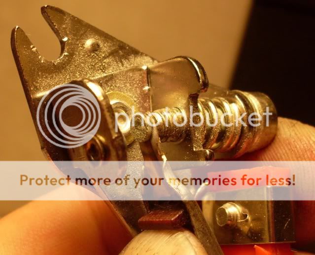

And the third set of points I've replaced in the three years the engine has been up and running.
Both contact surfaces on the lever arm pad and the base pad have been crystalized to the point that they wouldn't conduct electricity any more. (Ignore the dust - I had it sitting on the sanding table when I was prepping the coil for paint). I guess I will stick to the stock ignition parts from this point on and forget the aftermarket crap.
http://i466.photobucket.com/albums/r...8b/points2.jpg
http://i466.photobucket.com/albums/r...8b/points1.jpg

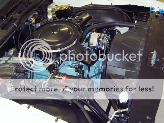

Engine running nicely now that the original coil is back in place and the new set of points are installed.
http://i466.photobucket.com/albums/r...b/S7004499.jpg

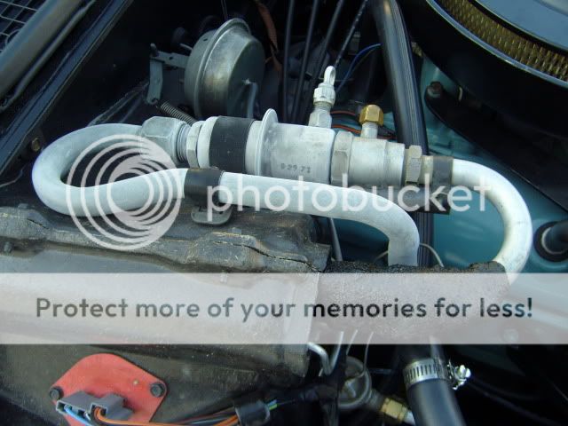

Even the A/C is working nice and cold...now that it's nice and cold outside. https://www.yenko.net/ubbthreads/imag...lins/smirk.gif
http://i466.photobucket.com/albums/r...b/S7004500.jpg

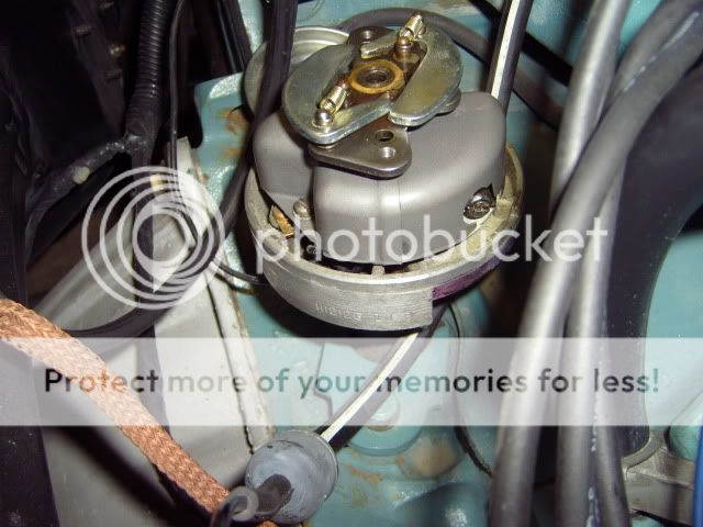

Picked up another random part I needed: the RFI shield for the distributor. This is the two-piece metal shielding that goes over the points to reduce the static interferance on the the radio. It does actually seem to work, since I ran the car after installing it and the radio noise was reduced significantly.
