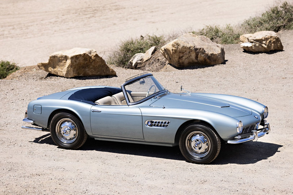

A12pilot 08-21-2023 12:27 PM
1 Attachment(s)
Attachment 246582
No sale at $1.7mil. Which is what it sold for at Kissimmee earlier this year.
