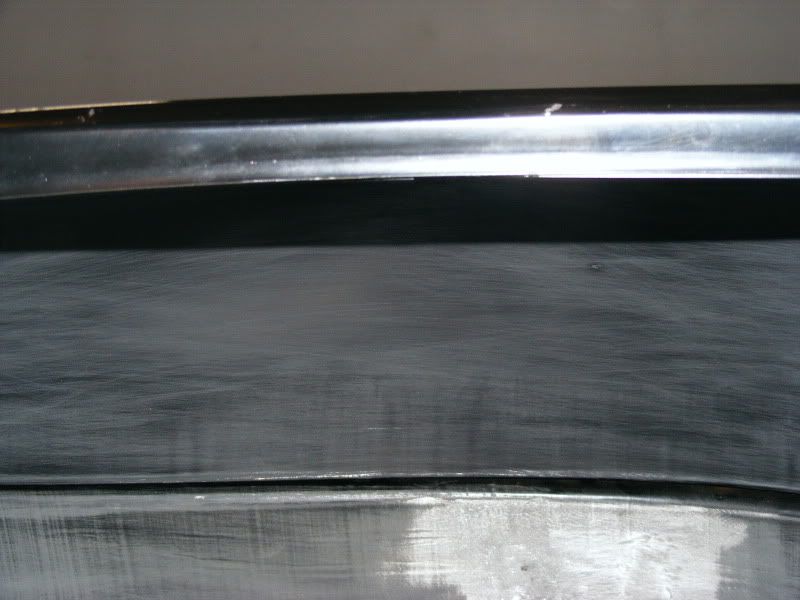

The issues with the rolled edges on the quarters at the trunk channel have been fixed as well.
http://i33.photobucket.com/albums/d73/VMCP777/C-1.jpg
http://i33.photobucket.com/albums/d73/VMCP777/B-1.jpg
