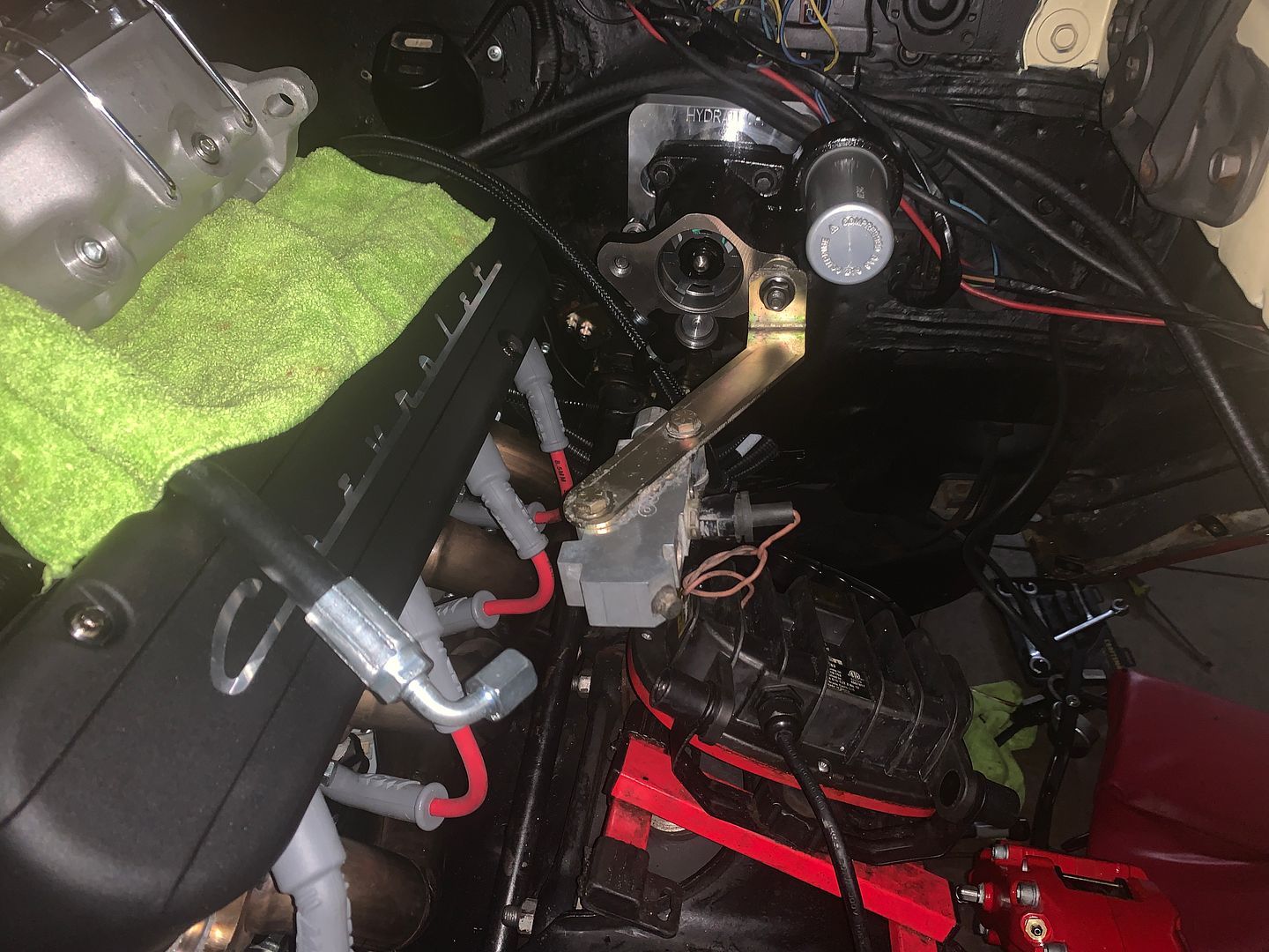

Finally got the Hydro Boost and got it installed..... Had the high and low pressure hoses made and installed.... Had to reposition the proportioning valve...... LOL..... Had to take the fender well out to get at the brake lines to make new ones to suit....another one of those simple things that turned into a multi-hour fix......Anyhow got the reservoir installed and hooked up .........filled the system with fluid and have to go thru the process of bleeding all the air bubbles out of the hydro boost system...... Then all I need to do is bleed the brakes and put the Hood on.....Then it needs to go for a Dyno-Tune to get the system balanced.......Another one finally finished......
