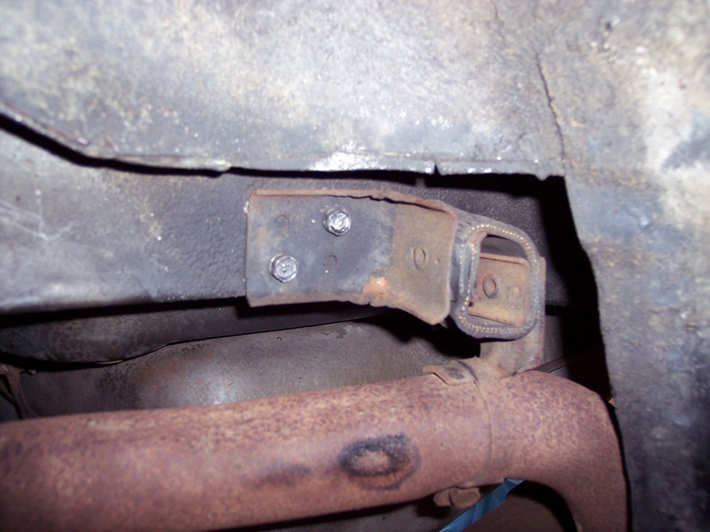

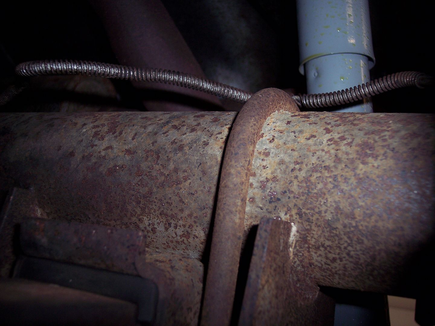

The rust remover process did not work as well as I thought is would. I can only assume it is due to dirt.
http://i1043.photobucket.com/albums/...psa012387c.jpg
http://i1043.photobucket.com/albums/...ps0de60ec7.jpg
http://i1043.photobucket.com/albums/...ps11f80610.jpg
http://i1043.photobucket.com/albums/...pse80b2992.jpg

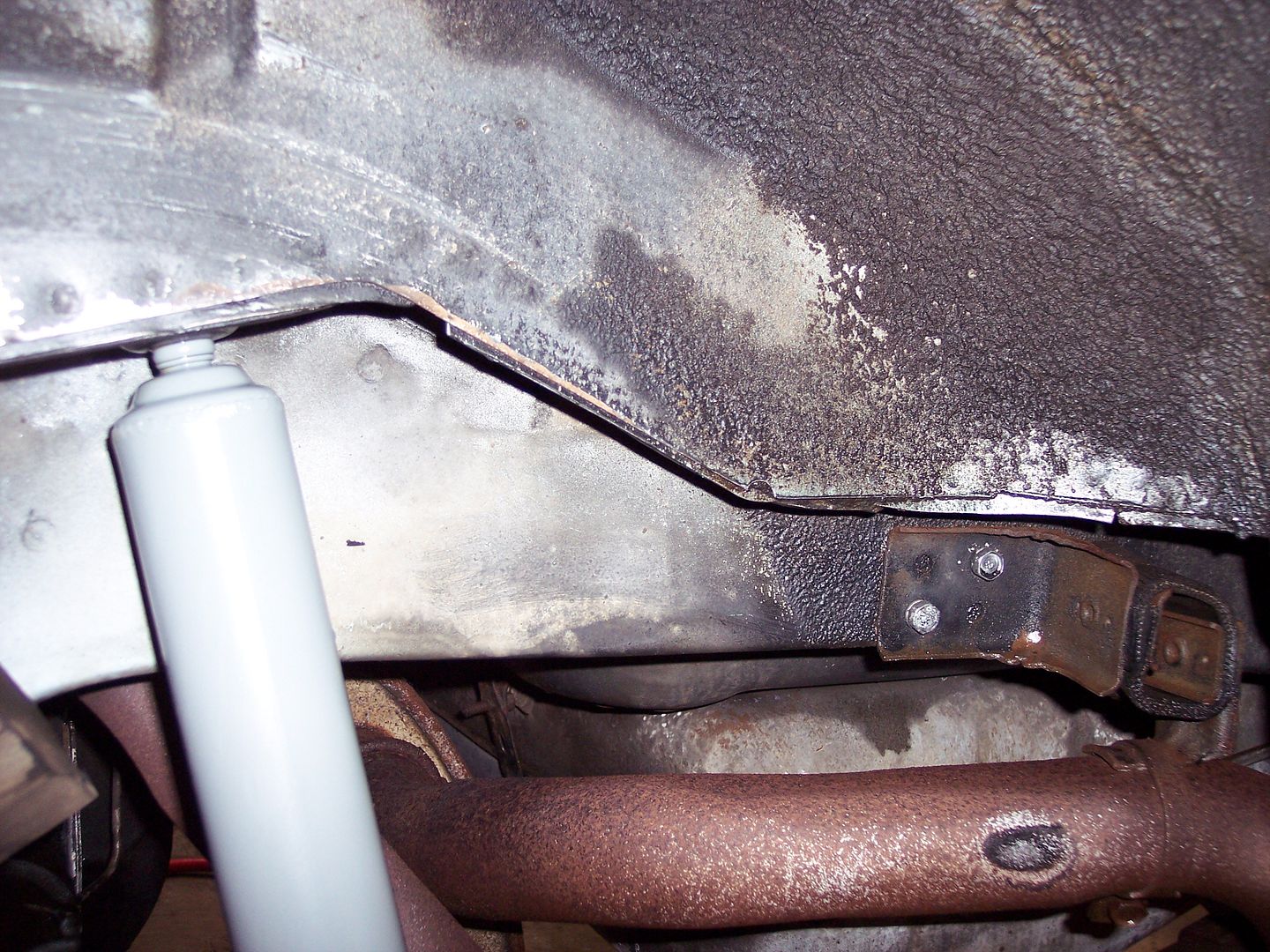

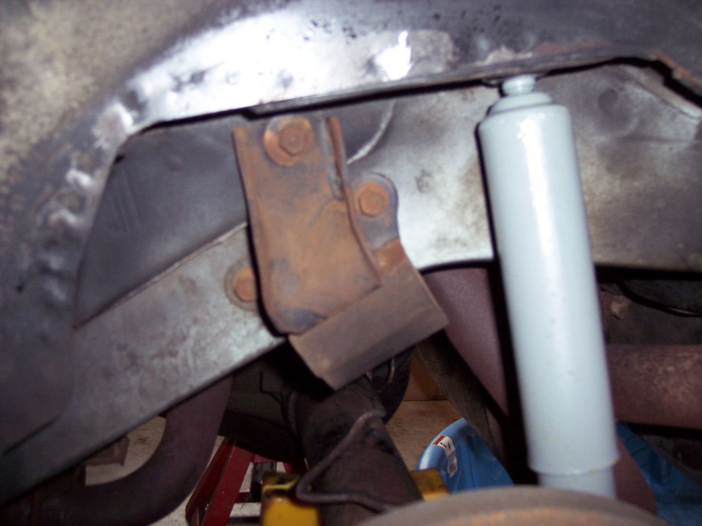

I then started to clean the wheel wells and degrease the front control arms. I suppose a gentle steam cleaning will take this quite a bit further.
http://i1043.photobucket.com/albums/...ps0ed22b19.jpg
http://i1043.photobucket.com/albums/...ps719d4521.jpg
http://i1043.photobucket.com/albums/...pse43f3b19.jpg

njsteve 01-25-2015 12:14 AM
Re: Harry Mann 68 L78 / L88 Camaro
You really have to do the steam cleaning/degreasing first. All that dirt and oil contaminate the derusting fluid and render it inert before it can even get a chance to work. That was why I pressure washed the underside of my car first. It cleans all the contaminants off of your parts and provides a clean (non oily) area to work with.
Any oil on the parts basically acts as a protective shield preventing the derusting liquid from touching the surface. If I were you I would rent a steam cleaner or a pressure washer (using hot water) and then buy a new batch of derusting fluid.
What does it say on the shampoo bottles? LATHER, RINSE, REPEAT. [img]<<GRAEMLIN_URL>>/biggthumpup.gif[/img]

Interesting...looks like the driver's side upper ball joint is riveted and the pass side is bolted??
Wilma
very cool car!!
napa68 01-25-2015 04:44 PM
<div class="ubbcode-block"><div class="ubbcode-header">Originally Posted By: WILMASBOYL78</div><div class="ubbcode-body">Interesting...looks like the driver's side upper ball joint is riveted and the pass side is bolted??
Wilma
very cool car!! </div></div>
You are correct. Kinda surprised me for a 25k car. Judging from the caked on grease from one side to the other, it must have been that way from early on.
