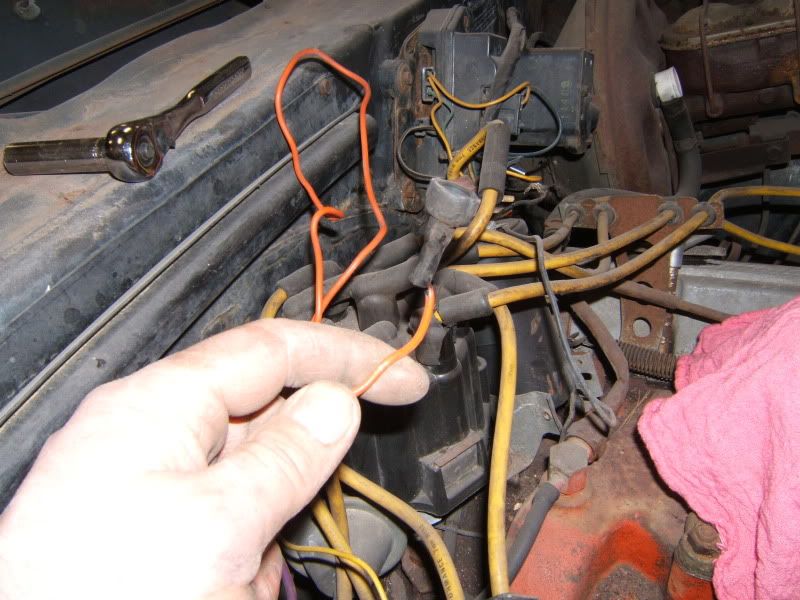

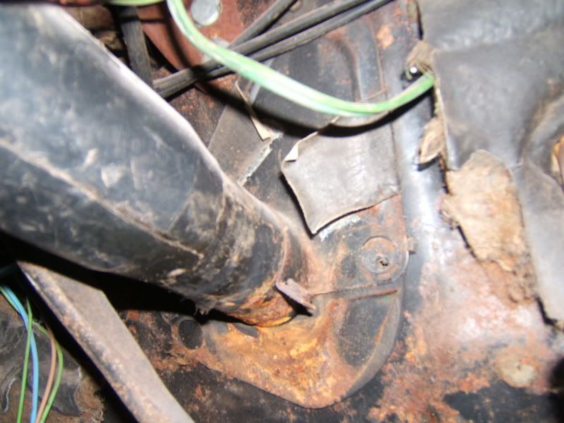

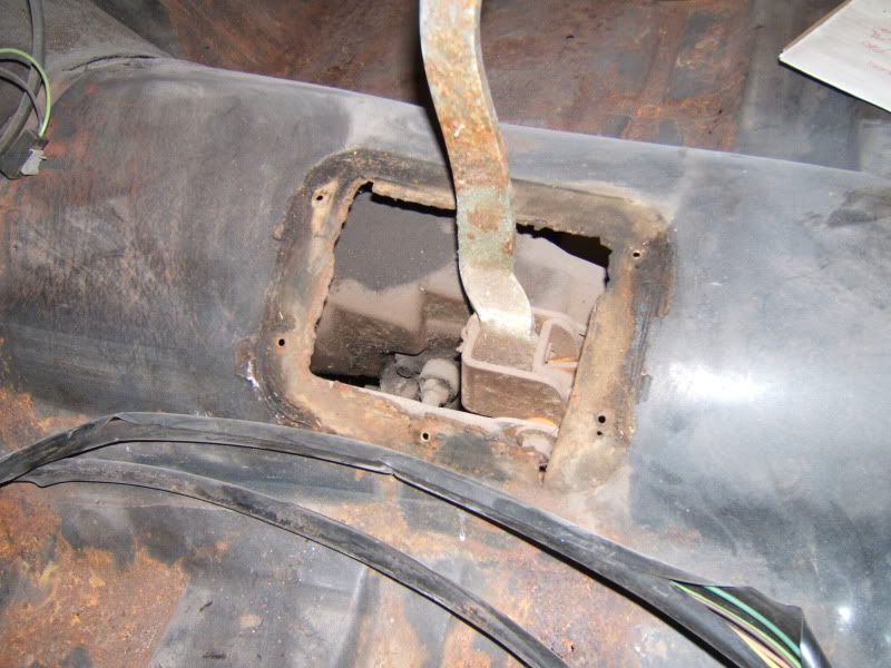

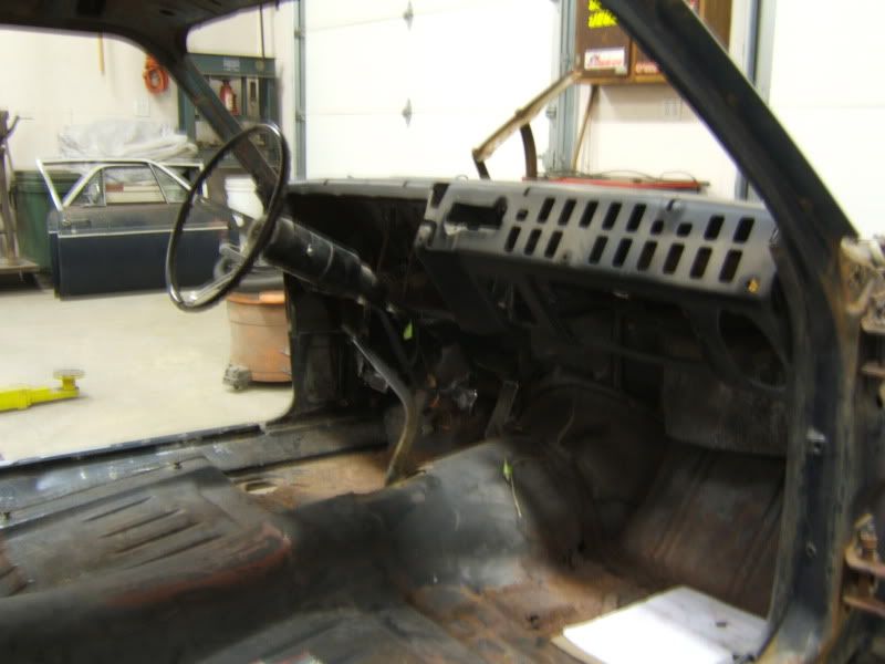

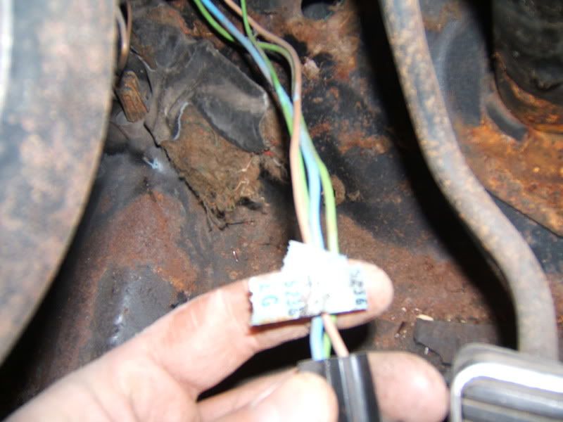

I spent the day taking the dash apart it will be fun putting all the Ac parts back together. Thank god for digital cameras. One thing I noticed was the tape to hold the gasket on the steering column seal bracket. I also found the part number on the rear wiring harness. The date code on back of the speedometer housing looks like C-18-68. I wouldn’t think the shifter hole would look this bad but I guess this is how they did it back then? The one thing I found interesting is the heater box wire for a non Ac car was behind the motor all rolled up. On an Ac car this wire isn’t used. Another wiring harness comes through the fire wall and one of the wires goes to the heater fan motor.

Nova Jed 02-22-2011 03:47 AM
Re: My new 1968 Nova L79 project.
Somewhere on the site someone had talked about the shifter hole. GM just torched them out. Yea the hours are crazy, but the rust is why I usually replace it all. I figured out that time is money and I rather pay the extra cash instead of making patches. Somehow I've lucked out on some of the hulks that I bring home. I haven't had to replace everything. Ha ha. Jason, this is where the real fun begins.
kwhizz 02-22-2011 12:04 PM
Here's a picture of my original 66 Nova......Shifter opening cut out with a torch..............

MIKE STONE 02-22-2011 05:35 PM
http://i35.photobucket.com/albums/d1...20nova0039.jpg
I had that (mystery) wire folded over inside the gutter with a taped end, no plug.
RPOLS3 02-22-2011 06:07 PM
Here is a thread where we discussed the orange mystery wire as well.
https://www.yenko.net/ubbthreads/ubbt...646&amp;page=1
Jake
jasonL78 02-22-2011 06:42 PM
I also found the three wires for the resistor on the non ac heater box cut. I think the colors were yellow,blue, and orange. I was a little worried seeing the harness cut but it makes sense now. Thanks for the link.
