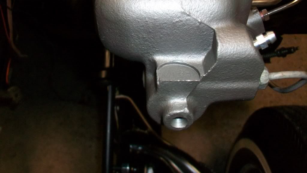

The original &quot;BA&quot; master cylinder.

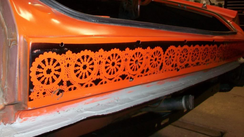

No black tail panel so Jerry did his own lace paint. There are 2 extra holes for the Dickhoff dealer emblem....which he still has.
