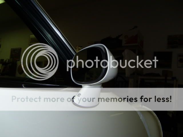

Assembled and installed the mirrors. (Thanks Charley for the reference photo from your 70 Z on the unpainted mirror mounting screw.)
http://i466.photobucket.com/albums/r...b/S7003604.jpg
