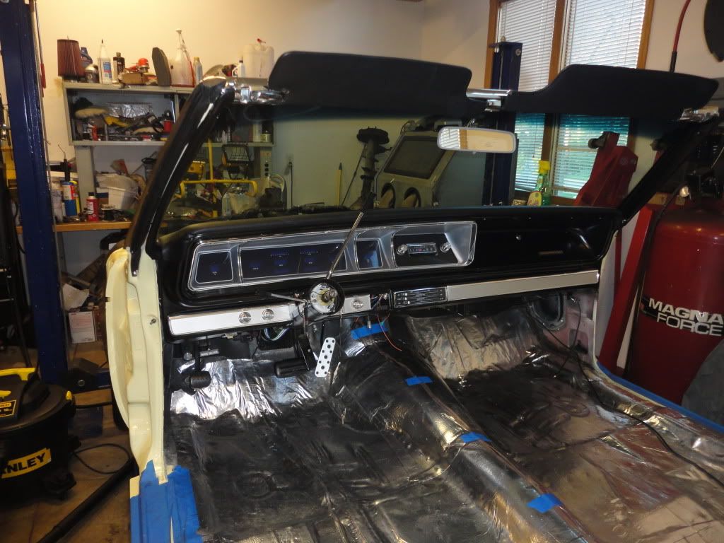

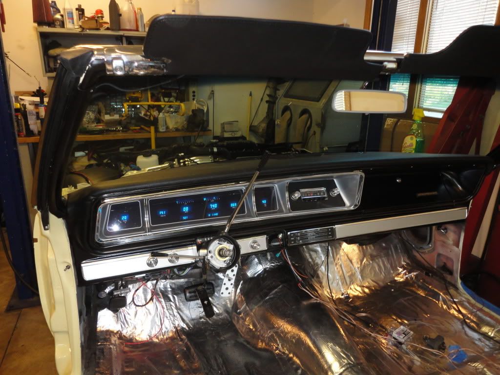

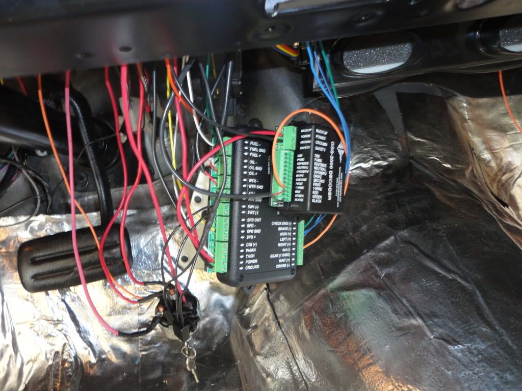

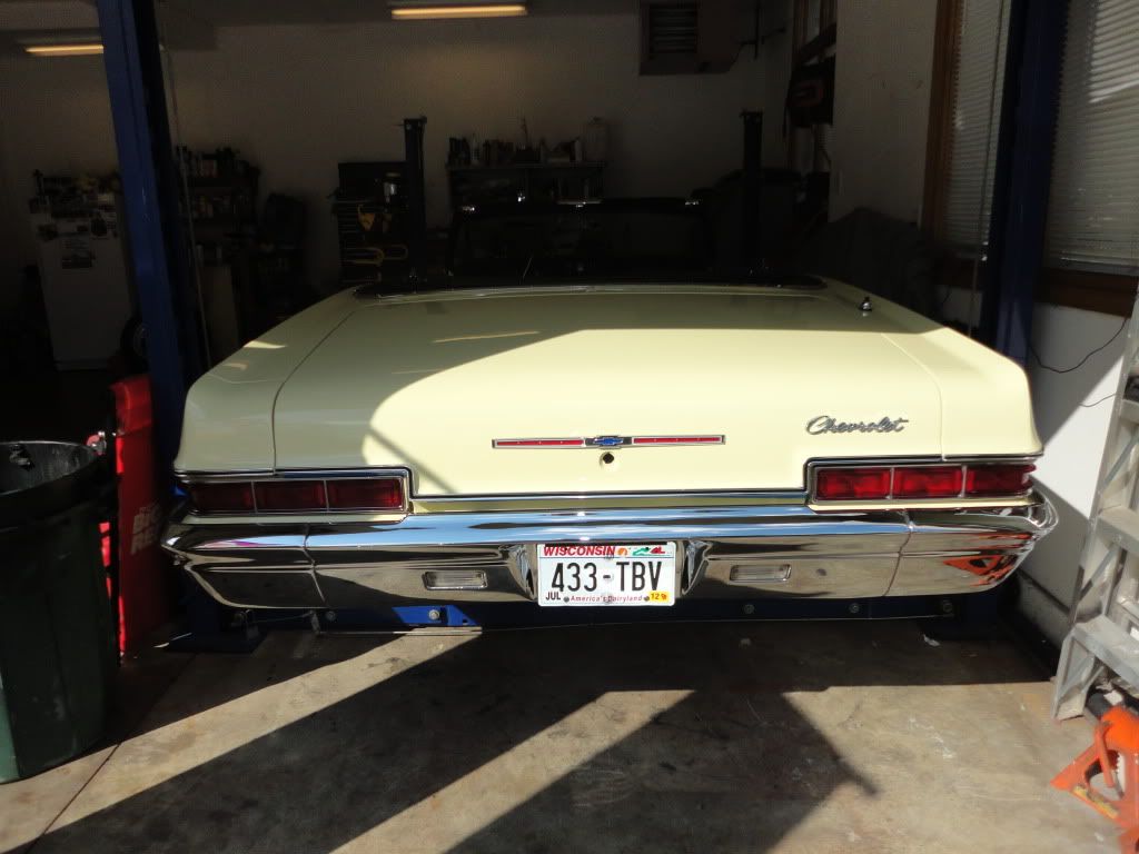

Got the trunk trim installed today......Got the new turn signal switch installed, got the final wires hooked up to the Dakota Digital modules.....and programmed the module so the correct values come up on the display.......also got the Spal- PWM fan controller just a couple of wires away from being operational.....Then time to get all the wires neatened up....

Even though pictures wouldn't show any visual progress, I got a lot finished over the weekend....Got the Spal fan controller installed and programmed (Thanks Chad).....I had a couple of nagging electrical issues that had me pulling my hair out....one was I couldn't get the headlights to work.....I had power to the parking lights and turn signals but nothing to the headlights (new forward light harness).......Ended up being a loose connector in the headlight plug......so simple yet so difficult to find........(Big Smile)......I also had some issues with the Dakota Digital Tail lights.....the passenger side turn signals and brake lights didn't work.....even though I tested everything while installing them and they worked fine....I spent a lot of time cleaning contacts and still no luck.....got out the circuit tester and found that as I was cleaning up the harness and trimming off the old bulb connectors .......I trimmed off a wire that fed the Turn and brake lights....simple fix.....Duhhhhh!!!......
I also got the transmission gear selector module programmed and working to show what gear the trans was in on the dash display....pretty cool......I also will be putting the dash back in today or tomorrow and after getting the wires all neatened up under the dash, I got the radio speakers all wired up and ready to go.....Exhaust and Front end alignment this week....

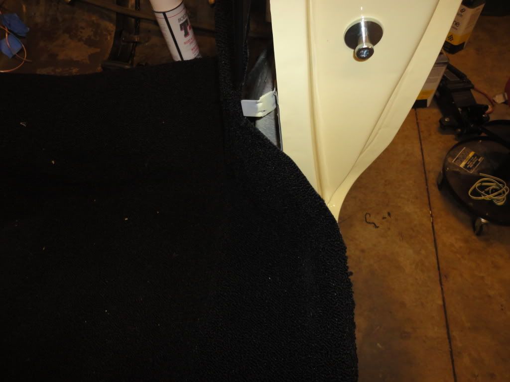

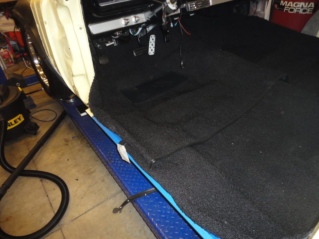

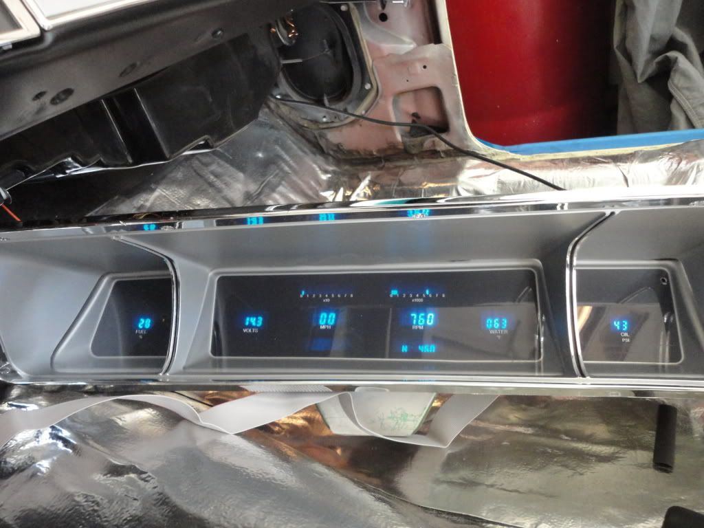

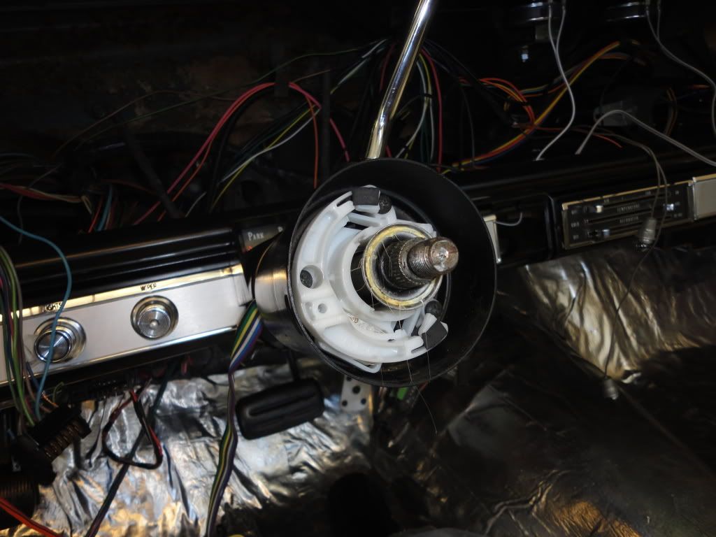

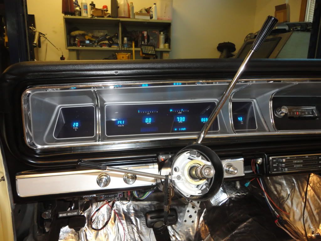

I went and picked up the seats and rear panels today.....new seat buns in the front seat along with new covers.....I also got the wiring under the dash all finished up and got the dash and gauge cluster installed..........I also started to install the carpeting.......they sure leave a lot for trimming......should have the Interior installed tomorrow.........getting closer
http://i13.photobucket.com/albums/a2...t/DSC06363.jpg
http://i13.photobucket.com/albums/a2...t/DSC06364.jpg
http://i13.photobucket.com/albums/a2...t/DSC06365.jpg
http://i13.photobucket.com/albums/a2...t/DSC06366.jpg
http://i13.photobucket.com/albums/a2...t/DSC06367.jpg
