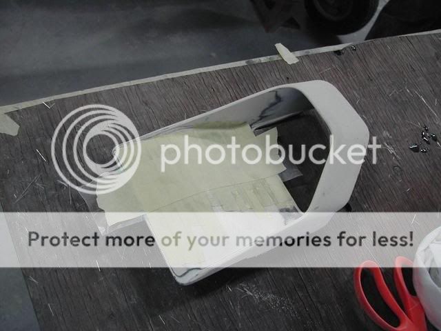

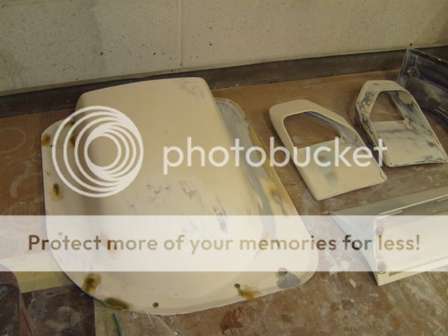

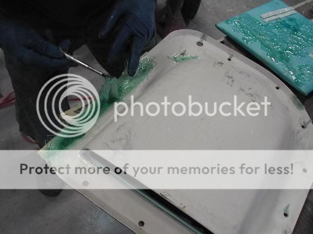

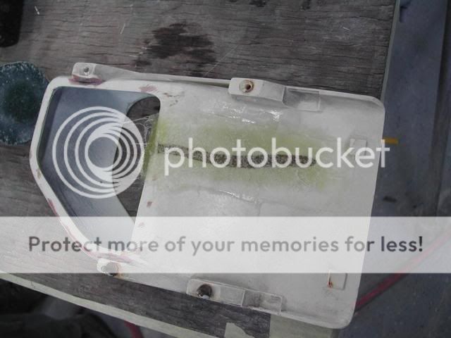

Went out to the shop today to bring over the upper door stainless trim so he could drill the screw holes for the clips. Better to do it before the paint goes on.

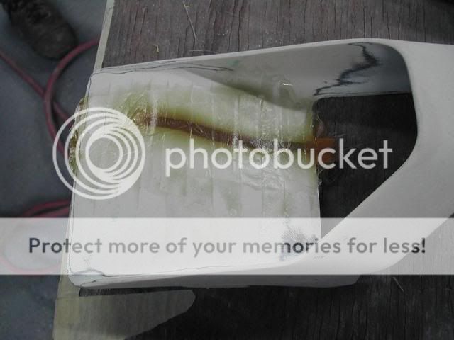

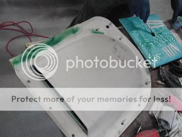

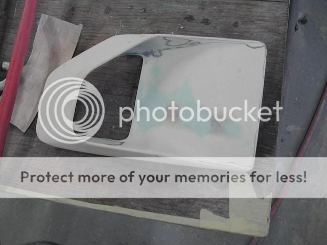

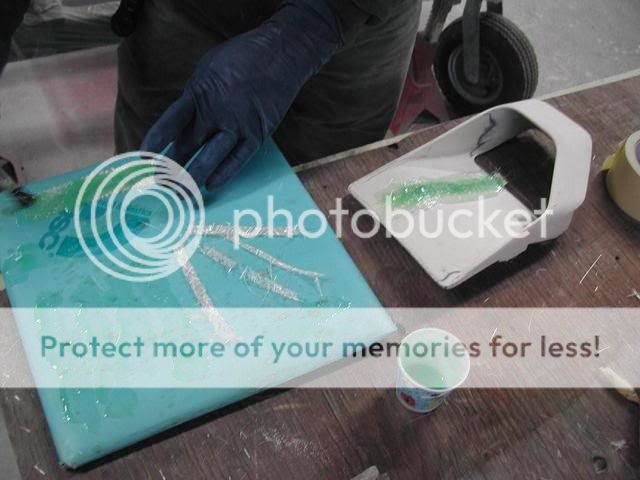

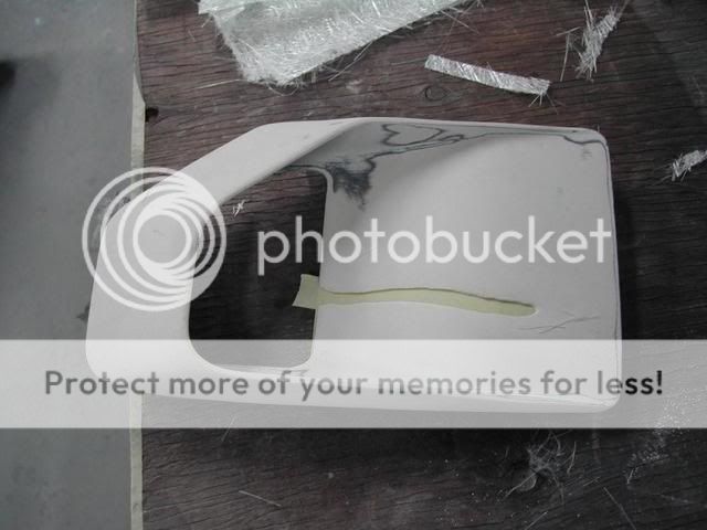

They have been working on the scoops and stuff. Here are some step by step photos on the fiberglass items. The fender scoop had a crack that needed some attention and the shaker had stress cracks around all the rivet holes as well as a cracked edge.
http://i466.photobucket.com/albums/r...15268b/197.jpg
http://i466.photobucket.com/albums/r...15268b/198.jpg
http://i466.photobucket.com/albums/r...15268b/199.jpg
http://i466.photobucket.com/albums/r...15268b/200.jpg
http://i466.photobucket.com/albums/r...15268b/202.jpg
http://i466.photobucket.com/albums/r...15268b/204.jpg
njsteve 03-11-2009 04:30 AM
Re: 72 T/A progess

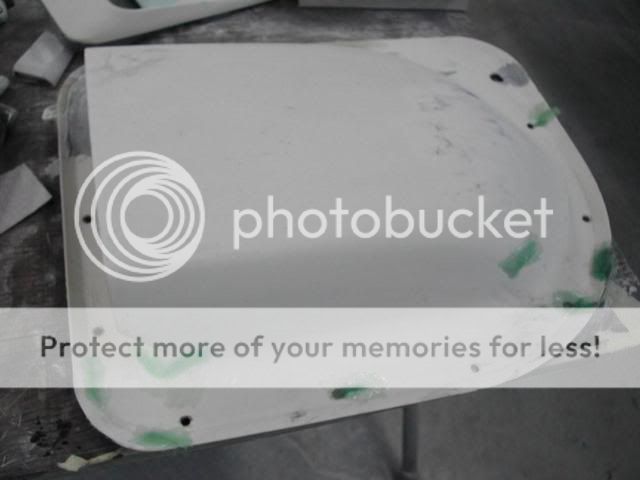

The shaker scoop:
http://i466.photobucket.com/albums/r...15268b/205.jpg
http://i466.photobucket.com/albums/r...15268b/206.jpg
http://i466.photobucket.com/albums/r...15268b/207.jpg
http://i466.photobucket.com/albums/r...268b/209-1.jpg
http://i466.photobucket.com/albums/r...15268b/210.jpg
http://i466.photobucket.com/albums/r...15268b/217.jpg

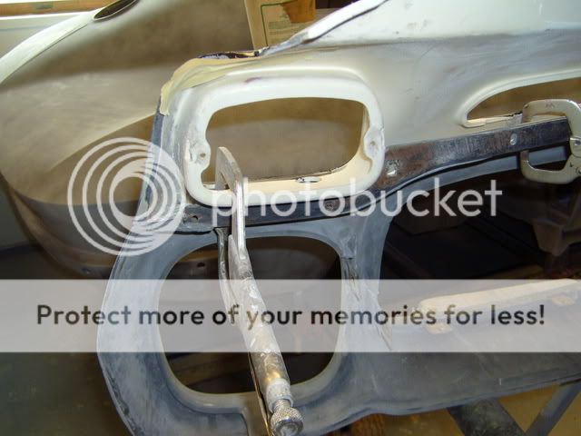

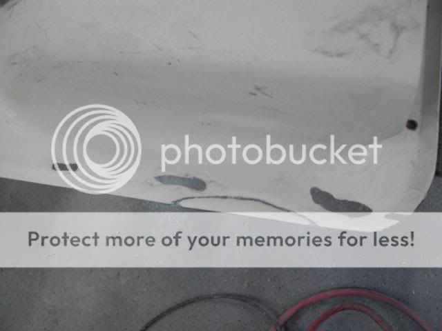

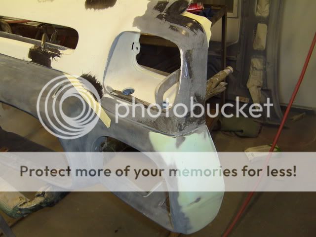

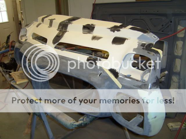

Some interesting work on the polyethylene valance.
They came up with an ingenous fixture to hold it in place so they could do the body work...they turned the nose/bumper upside down and clamped it to it. Now why the heck didn't I think of that. https://www.yenko.net/ubbthreads/imag...mlins/hmmm.gif
DOH!
http://i466.photobucket.com/albums/r...15268b/211.jpg
http://i466.photobucket.com/albums/r...15268b/212.jpg
http://i466.photobucket.com/albums/r...15268b/215.jpg
And here is the magic stuff they found to do the filler work. They actually found a flexible epoxy filler that works on polyethylene. The stuff was recommended for ATV fenders (which are made of polyethylene) It's called DYNATRON 660 and is actually made by the Bondo Company. It sticks to the valance material very well and feathers out when sanded. They were able to build up the sides to match the fender/bumper contours. That will also strengthen the sides of the valance immeasurably since that is the thinnest and most fragile part of the plastic valance.
http://i466.photobucket.com/albums/r...15268b/216.jpg
http://i466.photobucket.com/albums/r...15268b/214.jpg
http://i466.photobucket.com/albums/r...15268b/213.jpg

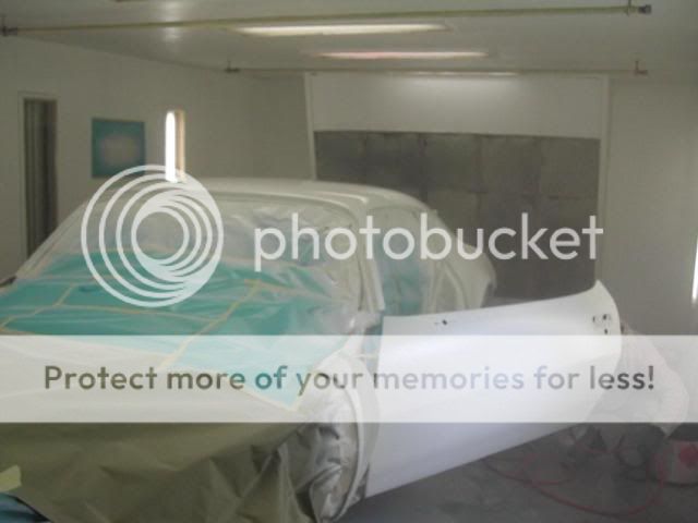

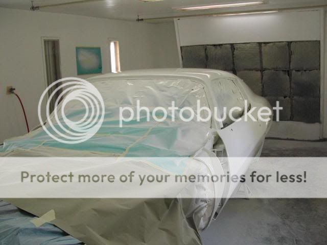

njsteve 05-20-2009 02:49 AM
Re: 72 T/A progess

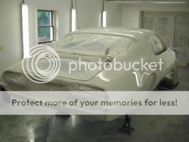

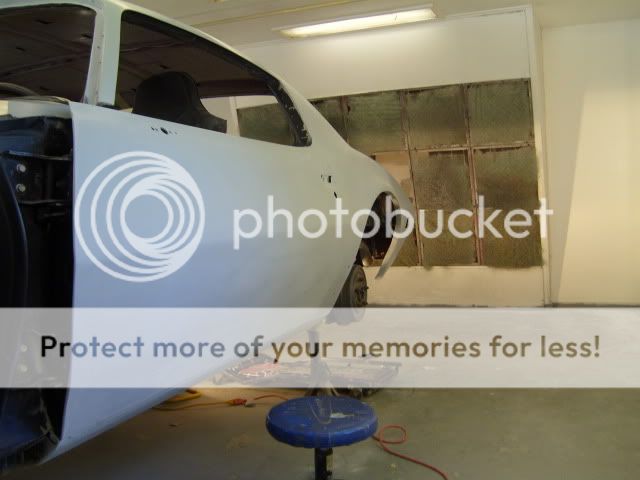

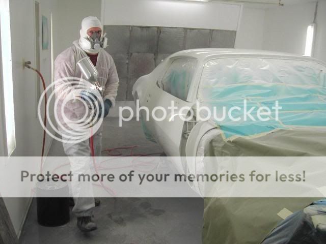

She's in the paint booth now. Some final finishing touches before cleaning and masking. Hopefully it will be white just in time for Memorial Day.
http://i466.photobucket.com/albums/r...15268b/236.jpg
http://i466.photobucket.com/albums/r...15268b/235.jpg
http://i466.photobucket.com/albums/r...15268b/237.jpg
http://i466.photobucket.com/albums/r...15268b/238.jpg

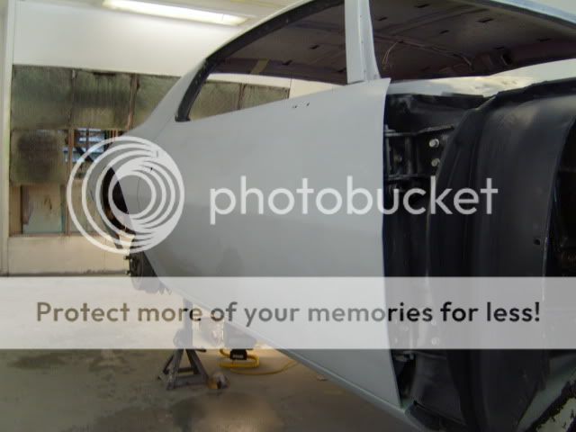

njsteve 05-20-2009 02:54 AM
Re: 72 T/A progess

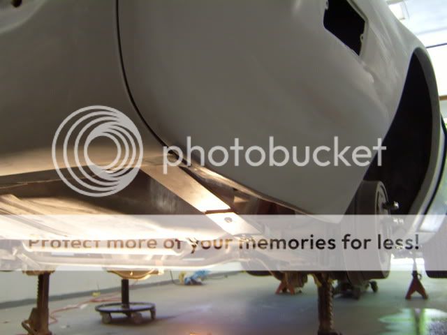

Final detailing on the lower quarter seam.
http://i466.photobucket.com/albums/r...15268b/223.jpg
http://i466.photobucket.com/albums/r...15268b/234.jpg

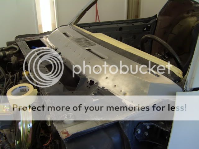

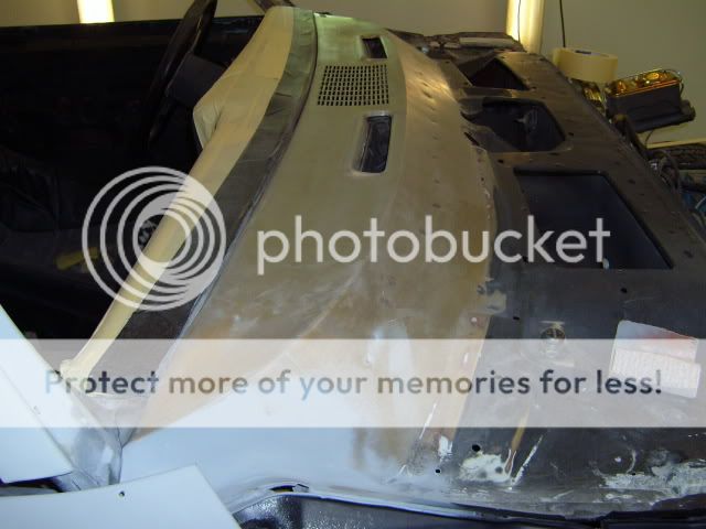

Some minor repairs to the dash edges. This is the spot where the water always collects on second gen F-bodies. The driver's side just had some minor pitting, while the passenger side had a small 1" square soft section that needed to be repaired.
http://i466.photobucket.com/albums/r...15268b/231.jpg
http://i466.photobucket.com/albums/r...15268b/229.jpg

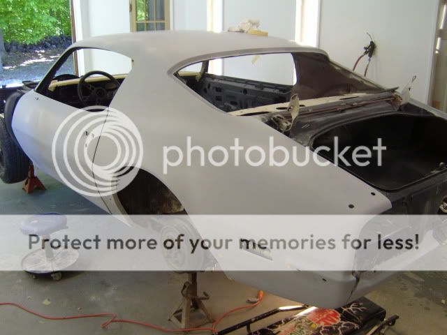

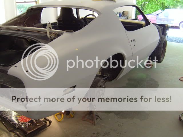

It's white, finally
Here you go, hot off the USB cable:
http://i466.photobucket.com/albums/r...15268b/252.jpg
http://i466.photobucket.com/albums/r...15268b/253.jpg
http://i466.photobucket.com/albums/r...15268b/254.jpg
http://i466.photobucket.com/albums/r...15268b/255.jpg
http://i466.photobucket.com/albums/r...15268b/258.jpg
http://i466.photobucket.com/albums/r...15268b/256.jpg
http://i466.photobucket.com/albums/r...15268b/257.jpg
