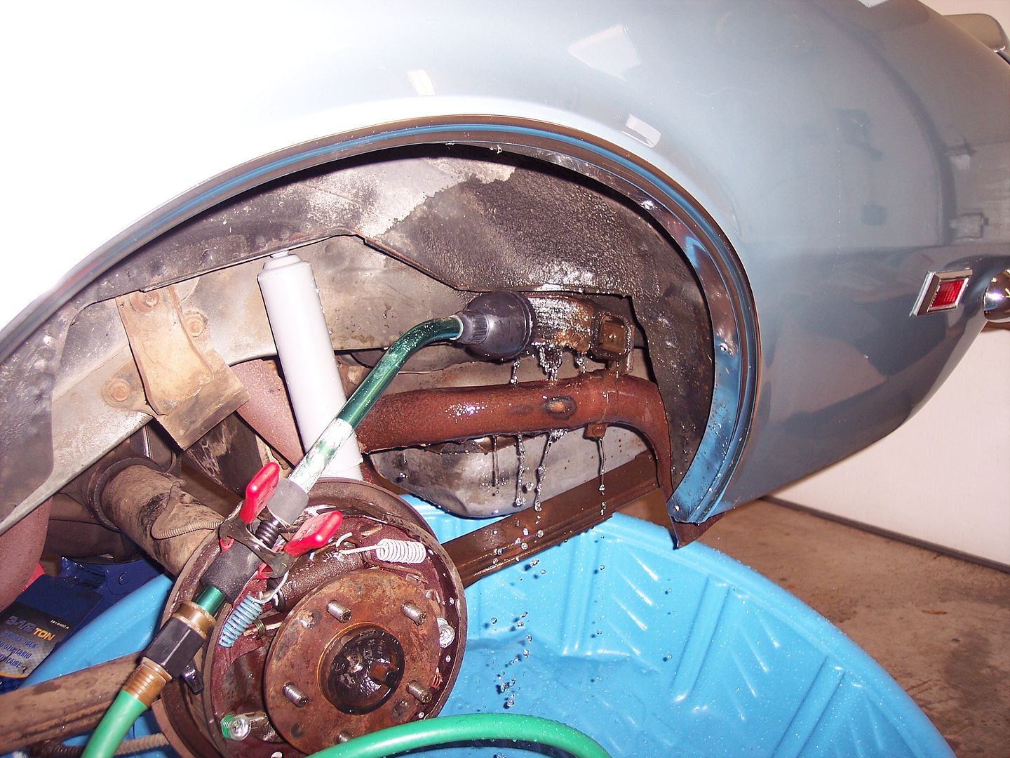

and we're off!
http://i1043.photobucket.com/albums/...ps3a738098.jpg

Nice! What is your air temperature out there? The stuff works a lot better when it, and the ambient temperature are warm.
If you cover the kiddie pool with a plastic sheet and put the sump in the bottom, it allows for the liquid to gather and flow down into one main spot instead of a big flat bottomed kiddy pool. Picture a swimming pool cover after a rainstorm, all the water gathers in the center. Takes much less liquid to do the job. Less evaporation, too.
Also, the process really works better if you steam clean and/or degrease everything first. You get much less contamination of the liquid and more clean surface area for the anti-rust liquid to attack.
napa68 01-17-2015 05:18 PM
Re: Harry Mann 68 L78 / L88 Camaro
I have the shop @ 72 degrees. I also have a heater in the solution and that ranges from 71 to 76 (depending where in the pool it is)
