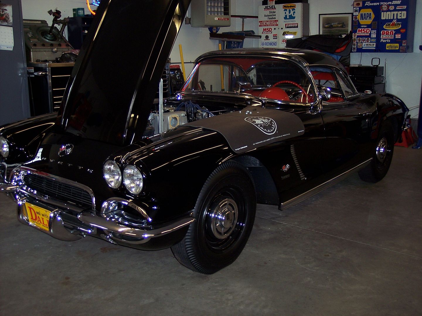

I'm waiting for parts before I can really progress much further. The air cleaner is mounted, fitted the ignition shielding as well as installed the left hand exhaust manifold. I am going to wait until the car is running and I am happy with the injection before changing the rocker arms.

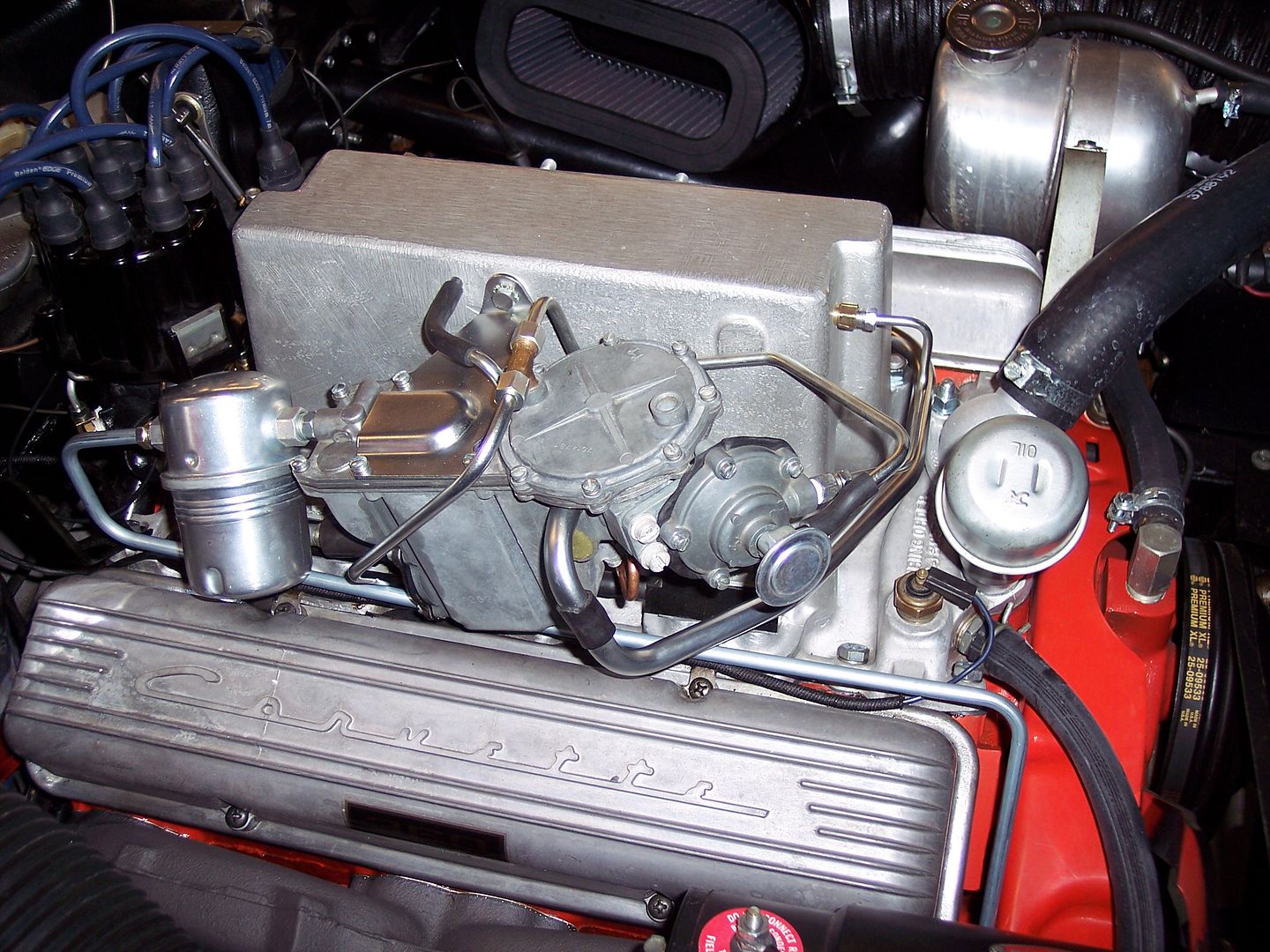

Per the suggestion of a site member (67 442) I contacted Sparky's Carb Service in Milwaukee for the zinc plating I needed. The work was excellent, reasonable, and quick. Time for an update.
I reassembled the rear diff with the new axles and new bearings in the center section. Back on all 4
http://i1043.photobucket.com/albums/...ps69dc548c.jpg

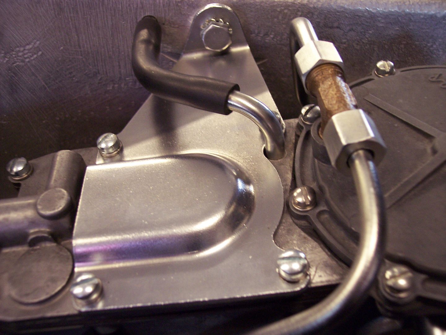

Reassembled the F.I. unit with aforementioned plated parts.
http://i1043.photobucket.com/albums/...psc0e30d20.jpg
http://i1043.photobucket.com/albums/...ps1a1c615e.jpg
http://i1043.photobucket.com/albums/...ps15471ea5.jpg
I fired the car up. Fixed a couple of small leaks....and it runs great, but could not get it to idle down (1700 rpm) Wouldn't you know.....the one thing I did not check..............the throttle body. The butterfly does not seal properly. You can throw a cat through the bottom side. Back to work!
