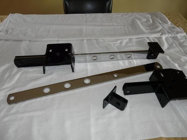

beater68427 05-30-2012 03:54 AM
Re: Traction bars
These are for my 68, I think they are Ansen Ground Grabbers from what I have seen, My car came with different ones mounted but these came with the car along with alot of other parts and I like the look better.
http://i226.photobucket.com/albums/d...ay2bars001.jpg
