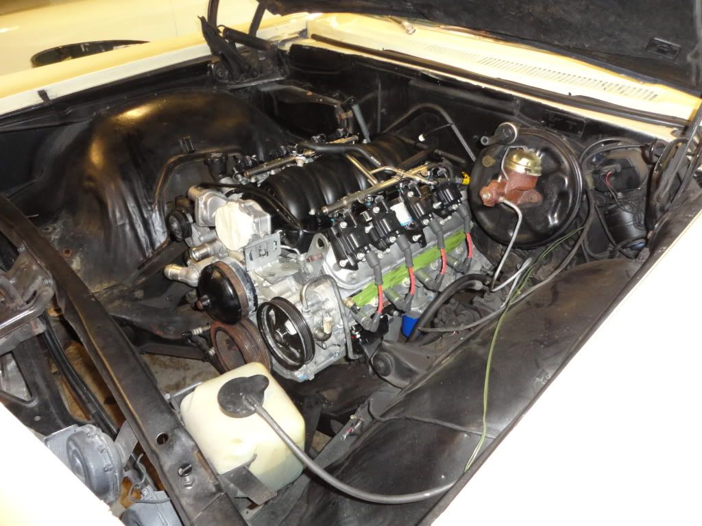

This is where I want to end up when this car is finished.....BUT......we have a few bridges to cross before I get there.....

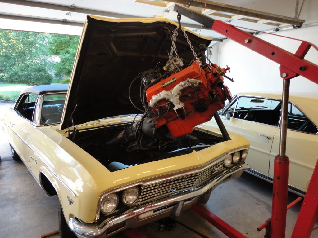

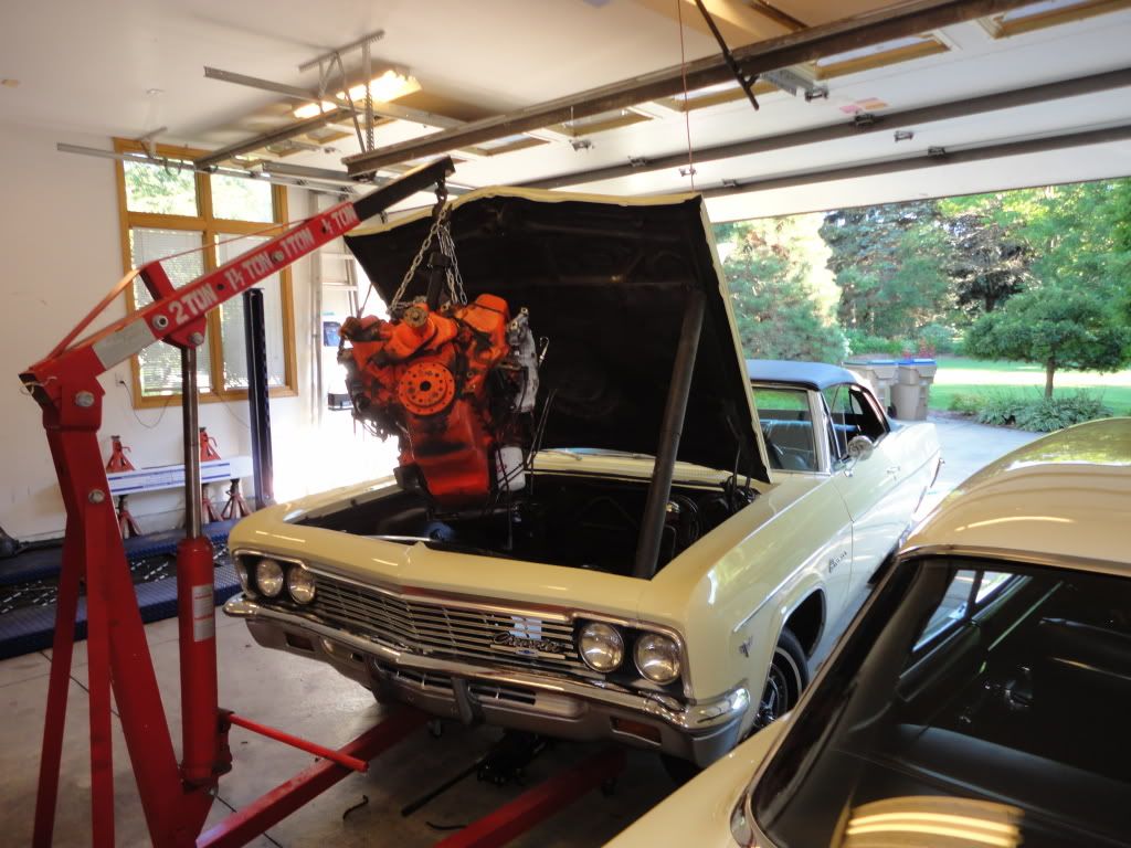

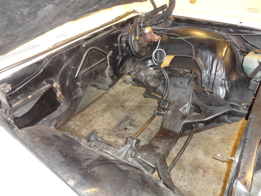

Got the engine pulled out tonight of my &quot;Perfect&quot; survivor car.....LOL
http://i13.photobucket.com/albums/a2...t/DSC03309.jpg
http://i13.photobucket.com/albums/a2...t/DSC03310.jpg
Actually, the sheetmetal in the Engine compartment is in relatively good shape.....things are looking up!!

Re: Next Years Power Tour Car
Perfect fithttp://i77.photobucket.com/albums/j7...res/dggggt.png
ORIGLS6 08-10-2011 05:37 AM
<div class="ubbcode-block"><div class="ubbcode-header">Originally Posted By: IM RARE</div><div class="ubbcode-body">Perfect fithttp://i77.photobucket.com/albums/j7...res/dggggt.png </div></div>
Dang! That was easy! [img]<<GRAEMLIN_URL>>/biggthumpup.gif[/img]

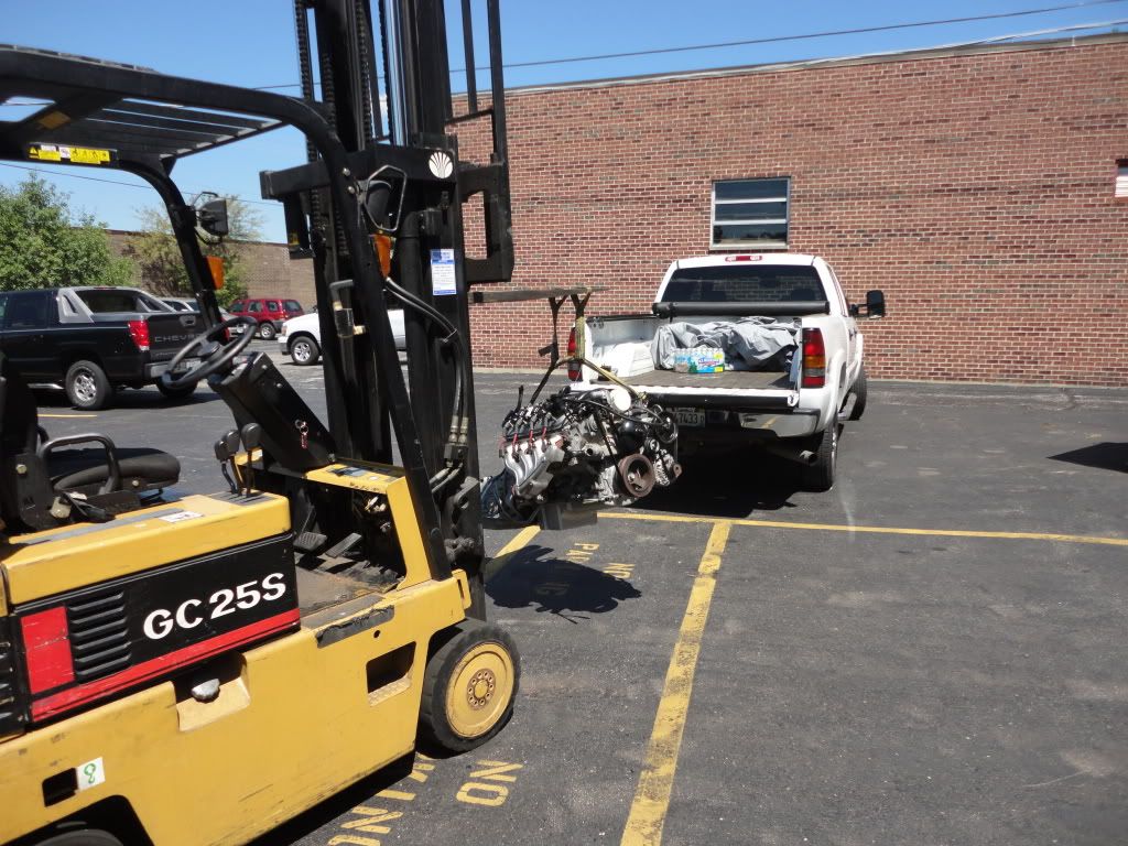

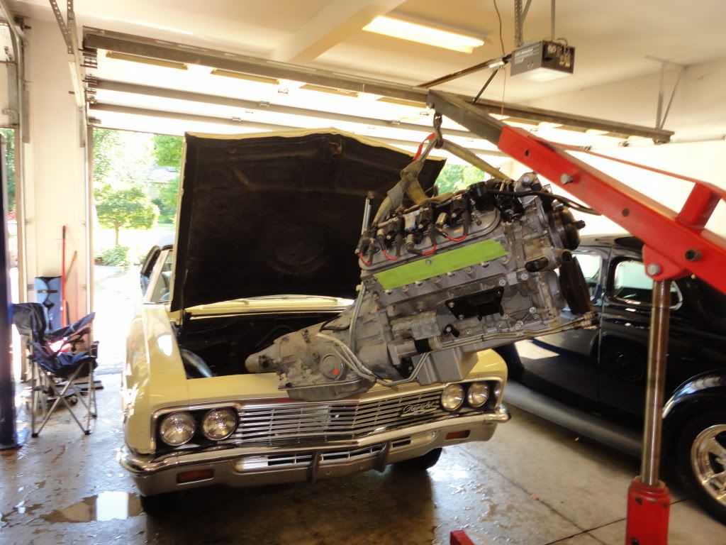

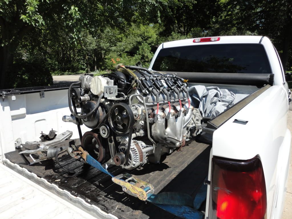

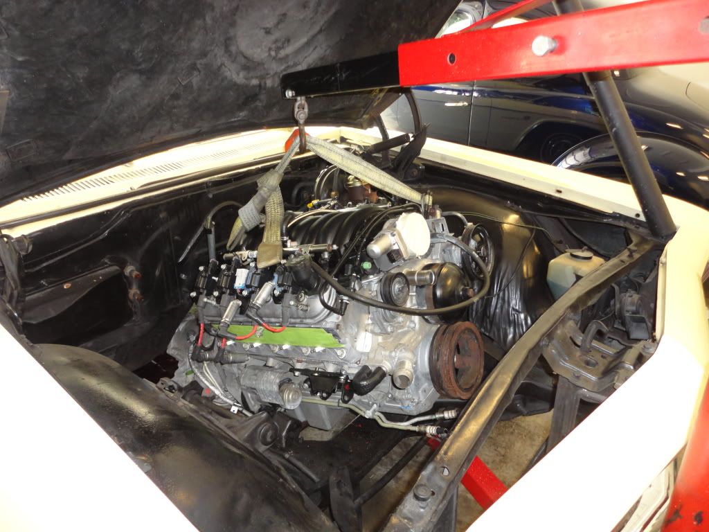

Brought the Engine home from the shop today and decided to play with the car a little.....
http://i13.photobucket.com/albums/a2...t/DSC03433.jpg
http://i13.photobucket.com/albums/a2...t/DSC03436.jpg

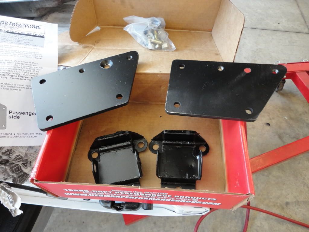

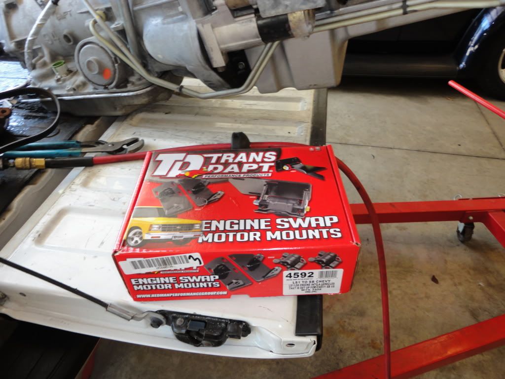

So......I dig around in the garage and find the Purchased parts for the install........Let's see how this is gonna go.......Adaptor plates and mounts for the LS conversion....
http://i13.photobucket.com/albums/a2...t/DSC03438.jpg
Wrapping Paper in the box........Hummmmm!!!....
http://i13.photobucket.com/albums/a2...t/DSC03440.jpg
http://i13.photobucket.com/albums/a2...t/DSC03439.jpg
Adaptor Plates and mounts........
http://i13.photobucket.com/albums/a2...t/DSC03441.jpg
Blood Pressures going up.......two of the bolts go in and the other two won't start....
http://i13.photobucket.com/albums/a2...t/DSC03442.jpg
http://i13.photobucket.com/albums/a2...t/DSC03444.jpg
Called Trans Dapt/ Hedman Headers and told them about their holes being off....the plates were Laser cut and the holes were off.....Come on guy's, this isn't Rocket Science......Got out the Carbide Burr and elongated the holes ..........Damm!!!

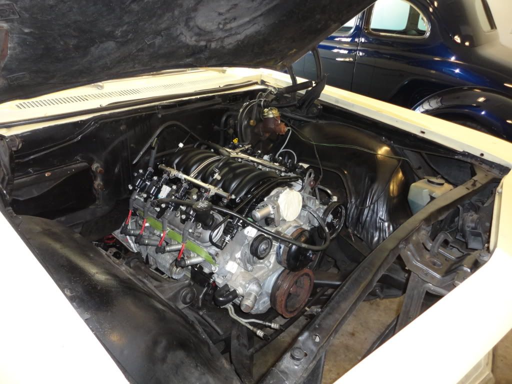

Moment of truth......Mounts, Holley Pan.......Is it gonna fit...
http://i13.photobucket.com/albums/a2...t/DSC03447.jpg
http://i13.photobucket.com/albums/a2...t/DSC03448.jpg
No Photoshoping allowed here....LOL.....
http://i13.photobucket.com/albums/a2...t/DSC03450.jpg
http://i13.photobucket.com/albums/a2...t/DSC03451.jpg
The Holley pan fits perfectly.....
http://i13.photobucket.com/albums/a2...t/DSC03456.jpg
http://i13.photobucket.com/albums/a2...t/DSC03452.jpg

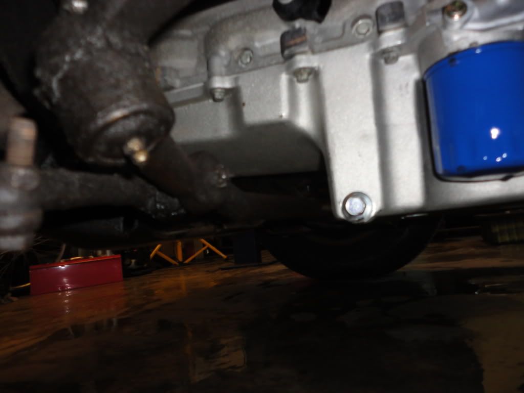

got a small jack on the back of the trans.....I was worried about the size of the 4L65E and it fitting in the tunnel....lots of room......I just need to modify the crossmember slightly for the trans mount........Gonna get it mounted and take it apart, going for Media blasting on the 23rd and then off to the body shop........
