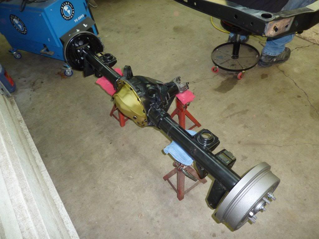

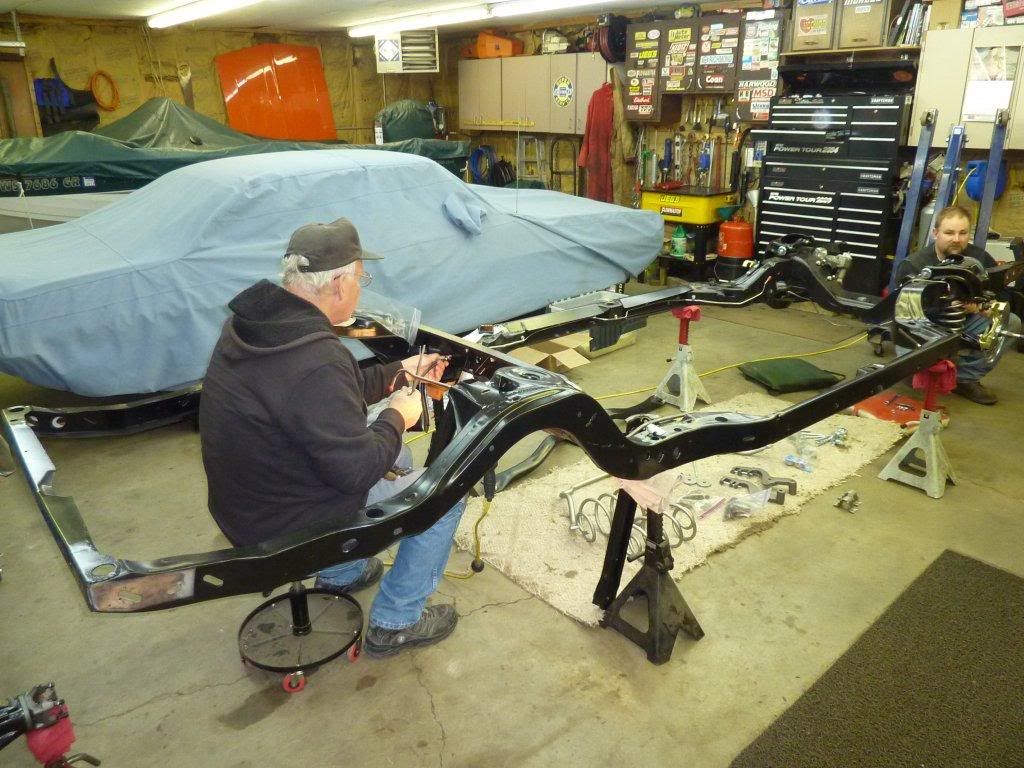

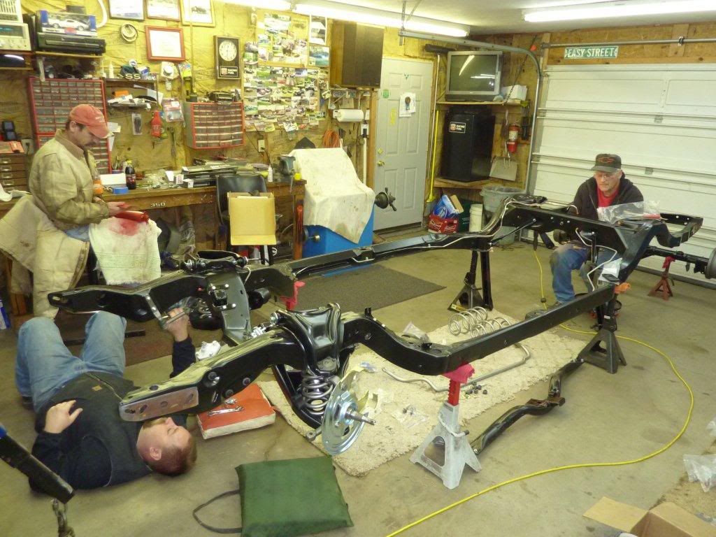

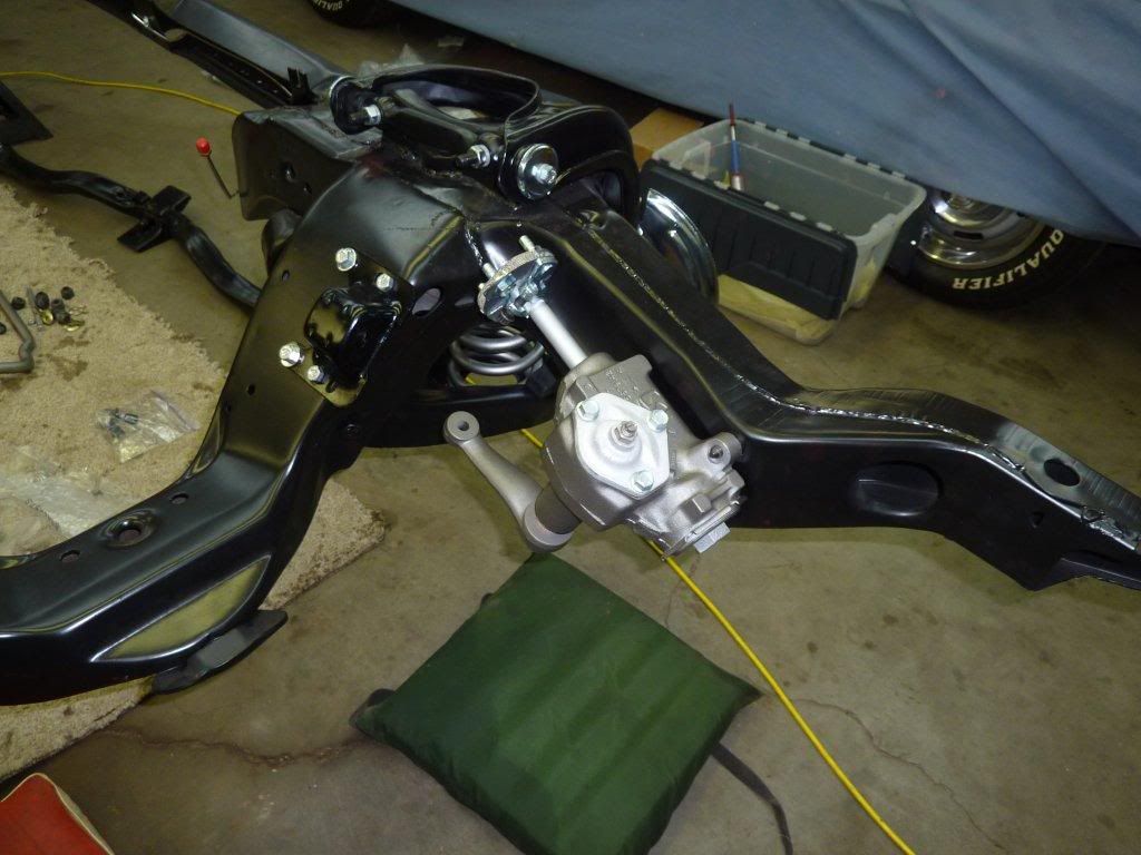

Here are the latest pictures of Jerry's Chevelle courtesy of Boomer.
Kurt
Here's Jerry in the foreground and Rip in the background.....having fun!!
http://i300.photobucket.com/albums/n...e/P1060744.jpg
http://i300.photobucket.com/albums/n...e/P1060745.jpg
http://i300.photobucket.com/albums/n...e/P1060746.jpg
http://i300.photobucket.com/albums/n...e/P1060747.jpg
http://i300.photobucket.com/albums/n...e/P1060748.jpg
http://i300.photobucket.com/albums/n...e/P1060749.jpg
mockingbird812 11-24-2011 06:33 AM
Re: 1969 Chevelle L78 Monaco Orange
Nice progress and looking good. I noticed in your last photo above that your friend is putting on those adapters that relocate the upper rear-control-arm mounting point higher (shortens the instant center). The David Bunn LS6 (see avatar) used a similar Lakewood piece which was permitted in the stock class that he raced in. Were those brackets in the photo used on the L78 back in the day?
http://img.photobucket.com/albums/v6...s/P1080188.jpg
69 Post Sedan 11-24-2011 06:46 AM
Yes Sam, Jerry had them installed on the original rearend. They can be seen on the original frame/rearend on page 4.
I'm not sure if he's going to use them on the current rearend. I kinda hope he doesn't as they will have to drill holes in the webbing and it's a real &quot;KK&quot; rearend.
Kurt
