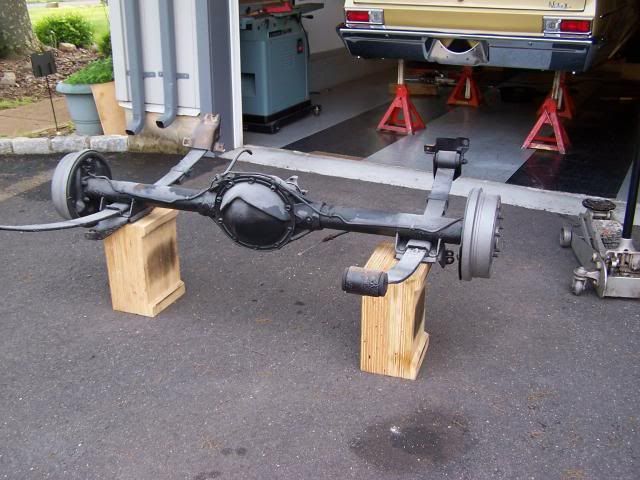

<div class="ubbcode-block"><div class="ubbcode-header">Originally Posted By: Bill Rose</div><div class="ubbcode-body">The regulator is now working. My fault. You guys were right. There are 2 ground wires in the front light harness, near the left side headlight. One should go to one of the 3 screws that hold the reg to the fire wall. I had them both on the horn relay screw. I have 14.6 volts now. It is a new Delco reg, but this one is working fine, if it's grounded correctly. </div></div>
Noticed that when you first posted this photo 2 mos. ago and thought you're just laying things out &amp; will get to them.
Glad to hear you did.
http://i533.photobucket.com/albums/e...psed67b720.jpg

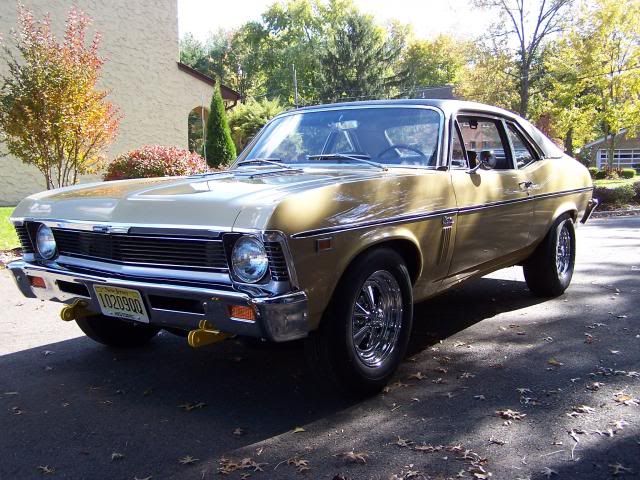

Ok, this is it. Had it out for the front end alignment today. It actually moves under it own power. Hasn't done that for a while. This build has been a lot of fun. I will be putting another set of wheels together for it. I'll be going with white steelies and cheater slicks on the rear, and a somewhat skinny wheel/tire combo up front. Not sure which wheels yet, up front. Probably a 15&quot; X 6&quot; of some sort, with black wall bias ply's....
I appreciate all the great advise, comments, emails, pm's and phone calls, over the past 6 months. I'm new to Nova's so I had a lot to learn, but it was one of the more pleasurable builds I've done. Now I have a new garage/storage building to build. I'll be thrilled if that goes as well as the Nova project went.
Here's a couple final shots for those who aren't sick of looking at it yet.
http://i533.photobucket.com/albums/e...ps91e9601d.jpg
http://i533.photobucket.com/albums/e...ps538b29e4.jpg

I got the Cragars with cheater slicks, and the skinnies up front. Had the car out for the maiden voyage today, breaking in all the new parts, like the Moser rear, trans, clutch, and the engine of course. The Nova is real hoot to drive now. It has some serious power and torque. I was taking it easy on the new motor, getting the rings seated, etc....
The new power steering and brakes are great too. It's tight, handles great, but has a smooth ride. I have a couple bugs to get out of it but simple stuff. Here's a shot with the new wheels.
