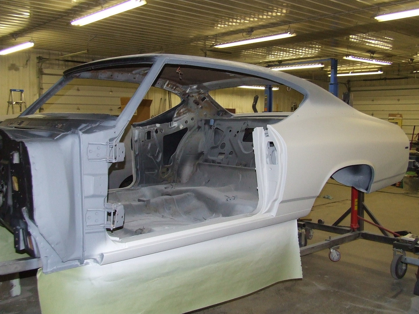

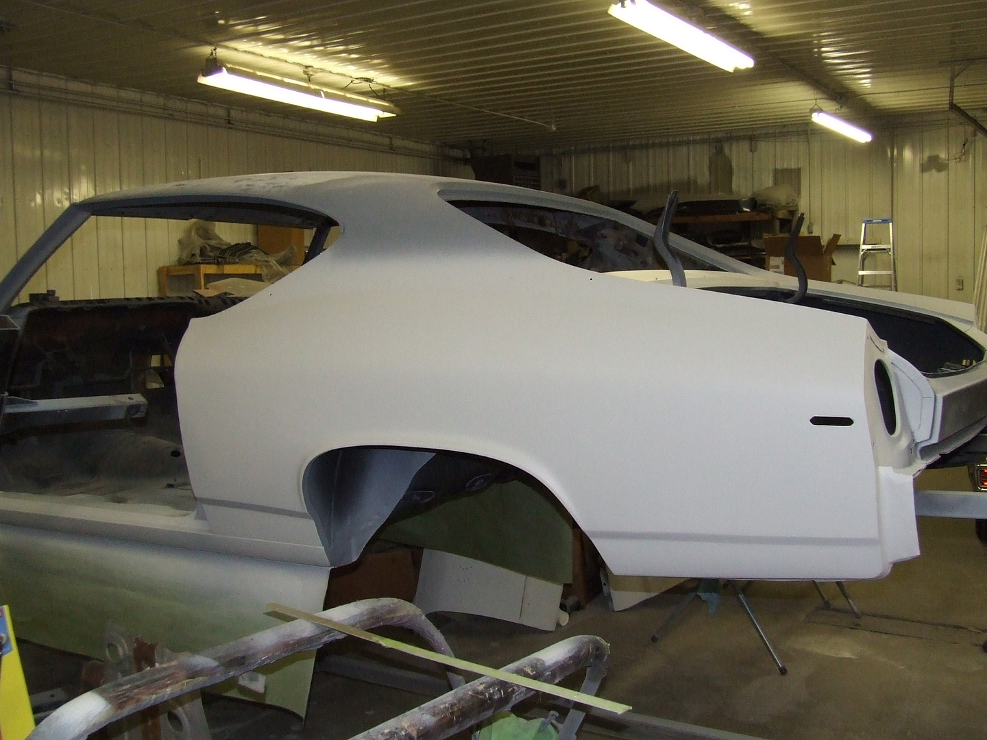

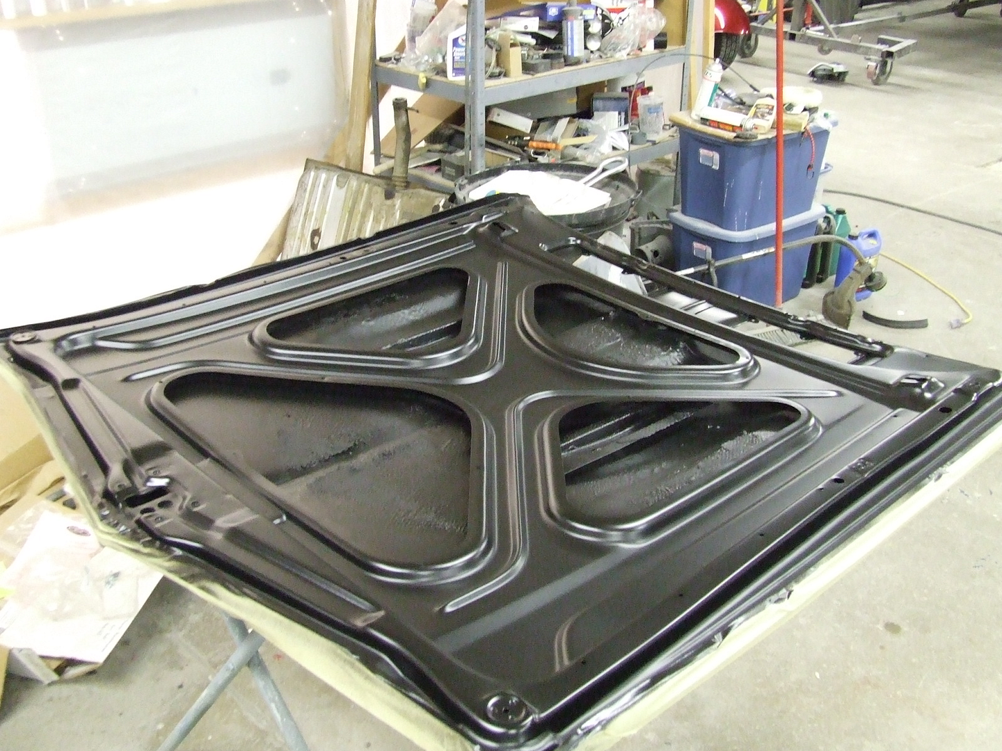

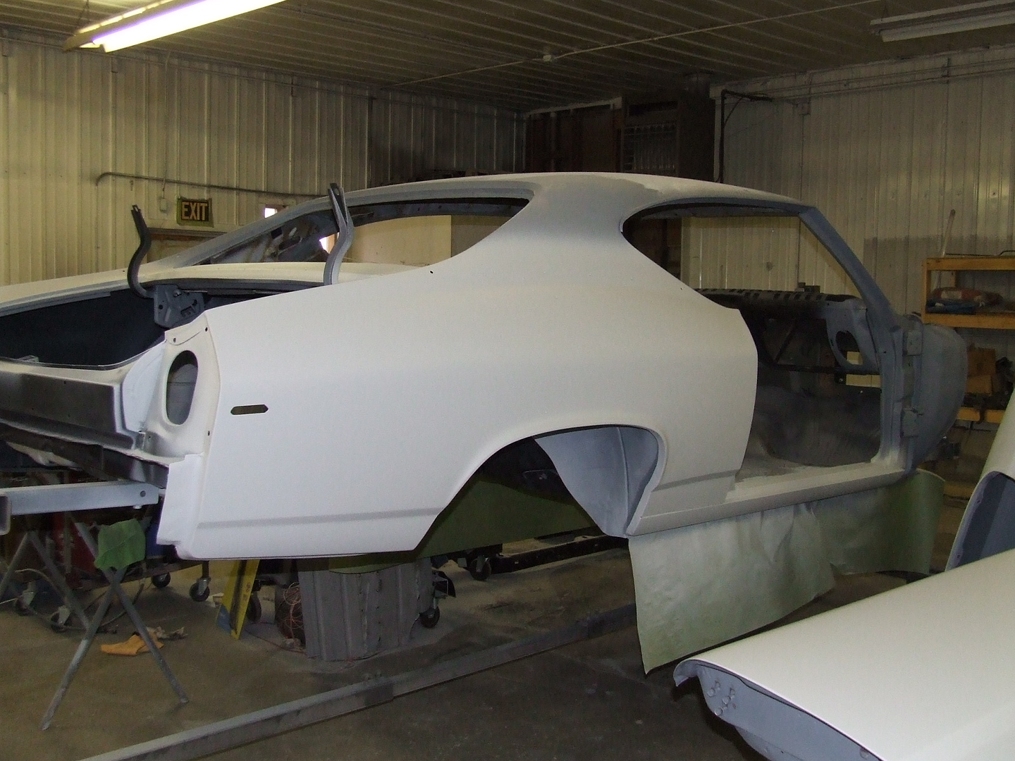

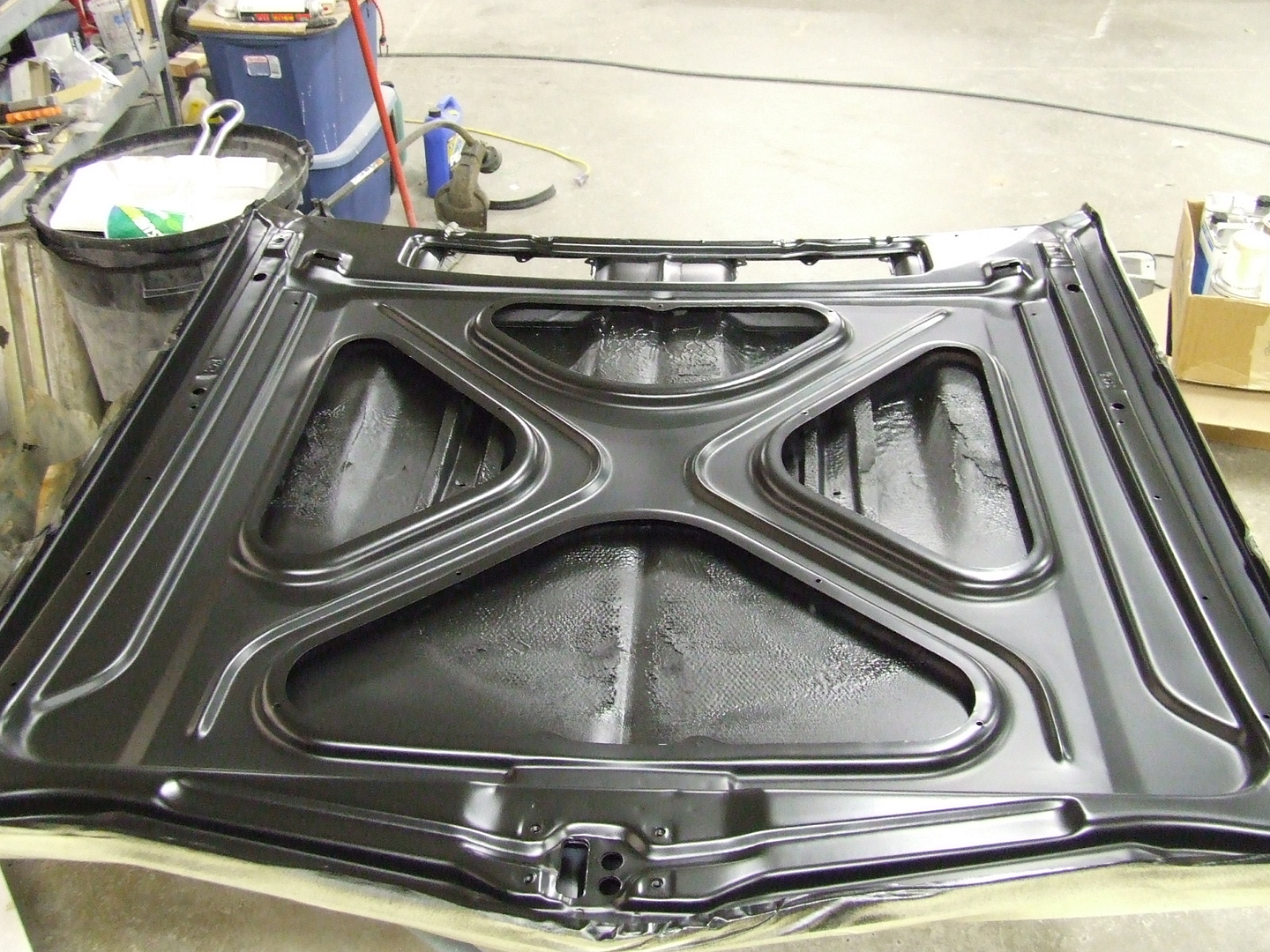

Donnie 10-16-2012 12:06 AM
Re: Donnie`s new 1969 Dover White L78 Chevelle

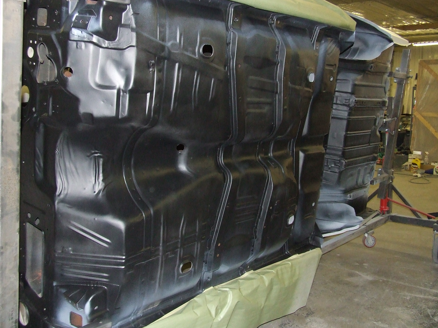

Body is getting close to paint. floor pans have a coat of epoxy on them one more to go then top coat. fenders, doors, trunk lid and quarters are epoxyed primed and ready to start blocking. underside of hood is finished.

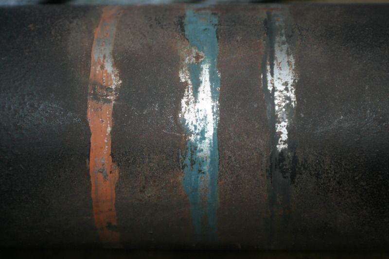

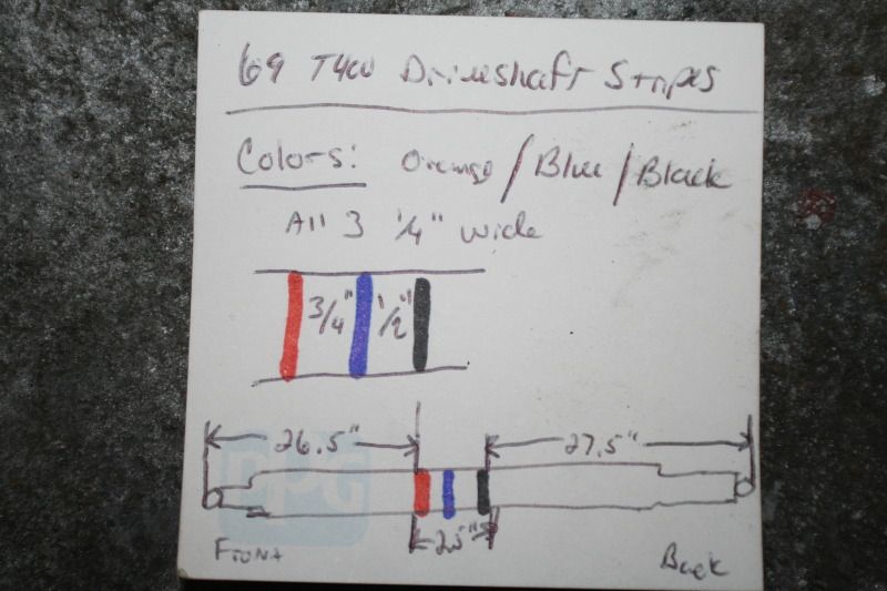

I thought I would add in a little piece to Donnie's restoration. I stopped at his place on my way back from MCACN to drop off some parts to him. I also brought his drive shaft back with me to drop off to Quanta for restoration. Since we all know how picky Donnie is in regards to his attention to detail [img]<<GRAEMLIN_URL>>/grin.gif[/img], I decided to clean up a part of the drive shaft to reveal the original stripes painted on it and take some measurements.
Cleaning revealed stripes in this pattern... Orange Blue Black. Each one is approximately 1/4&quot; wide and spaced 3/4&quot; between orange and blue, then 1/2&quot; between blue and black. The orange stripe begins 26.5&quot; from the front of the drive shaft (outer edge of the U joint casing) The black stripe is set 27.5&quot; from the back
http://img.photobucket.com/albums/v2...C/IMG_5981.jpg
I even used correct colored Sharpie markers to illustrate!
http://img.photobucket.com/albums/v2...C/IMG_5980.jpg
I am going to drop it off at Quanta on my of my journeys to Maryland in the next couple weeks.

Quanta does 98% of all of mine. They are not technically assembly line correct as an original is cold rolled steel with a welded seam and welded ends which are blued from the heat but it beats paint! Only virgin shafts or NOS shafts can be saved with plastic media blasting and retain an the original appearance. Below is an example of a Quanta restoration after I reapplied the stripes.

Greg Gorniak in Dayton, OH does a beautiful job on driveshafts and even replicates the heat affected zone. He also will replicate the extrusion mark.
