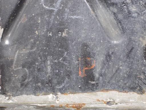

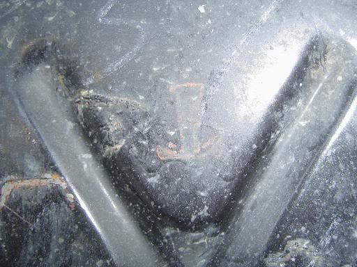

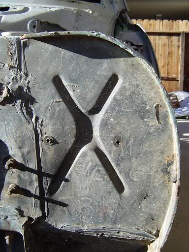

JChlupsa 10-29-2004 01:52 AM
Re: L89 Resto!!
Not all BTP markings are on the firewall check out where these were found on the outer cowl areas along with other marks
http://img.photobucket.com/albums/v9...lip20panel.jpg
http://img.photobucket.com/albums/v9...20marks202.jpg
http://img.photobucket.com/albums/v9...PTB20marks.jpg
musclecarz 10-29-2004 01:57 AM
Re: L89 Resto!!
Hi Jon, I think the 37 code is a 437, Not written well but didn't need to be.. No bumper guards on the car.. The information and knowledge on this board is impossible to put a price on!!! https://www.yenko.net/ubbthreads/imag...mlins/flag.gif

musclecarz 10-29-2004 05:59 PM
Re: L89 Resto!!
Hi Jeff, I have seen these marks on Some of our F body Pontiacs, 1970-71 Trans am's, I have seen the markings on the forward face of the cowl as well as around the sides of the cowl. These cars obvoiusly were inspected with the fenders off the car. https://www.yenko.net/ubbthreads/imag...lins/beers.gif
