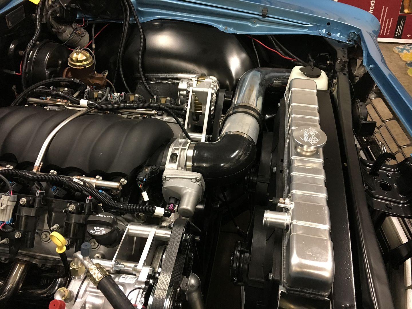

Mocking up the air intake system...........Getting closer
http://i13.photobucket.com/albums/a2...A9089C29_1.jpg
