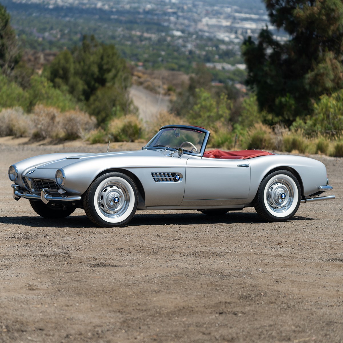

https://images2.imgbox.com/f3/18/iyUFtSM2_o.jpg
