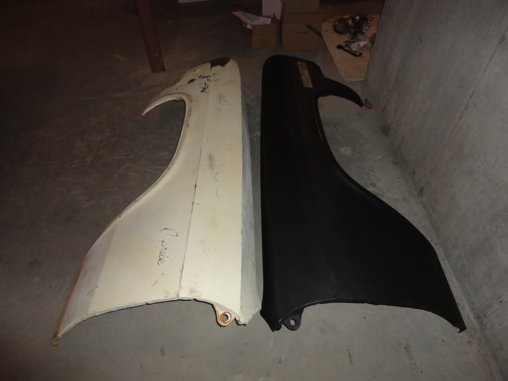

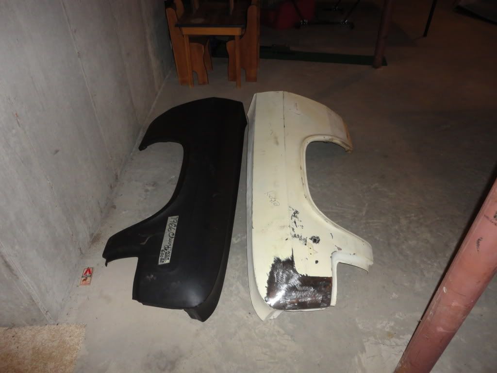

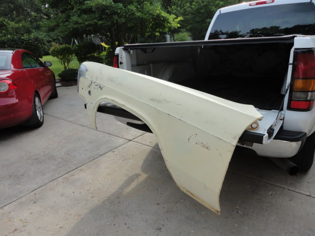

Got the NOS Passenger side last week......Today I got my eBay Drivers side &quot;used&quot; fender.......Must have lived it's life out by Bruce and the &quot;Painter Guy&quot; as it has just some very light surface rust.....
http://i13.photobucket.com/albums/a2...t/DSC03038.jpg
http://i13.photobucket.com/albums/a2...t/DSC03036.jpg
http://i13.photobucket.com/albums/a2...t/DSC03035.jpg
http://i13.photobucket.com/albums/a2...t/DSC03034.jpg
Both fenders together......
http://i13.photobucket.com/albums/a2...t/DSC03040.jpg
http://i13.photobucket.com/albums/a2...t/DSC03039.jpg

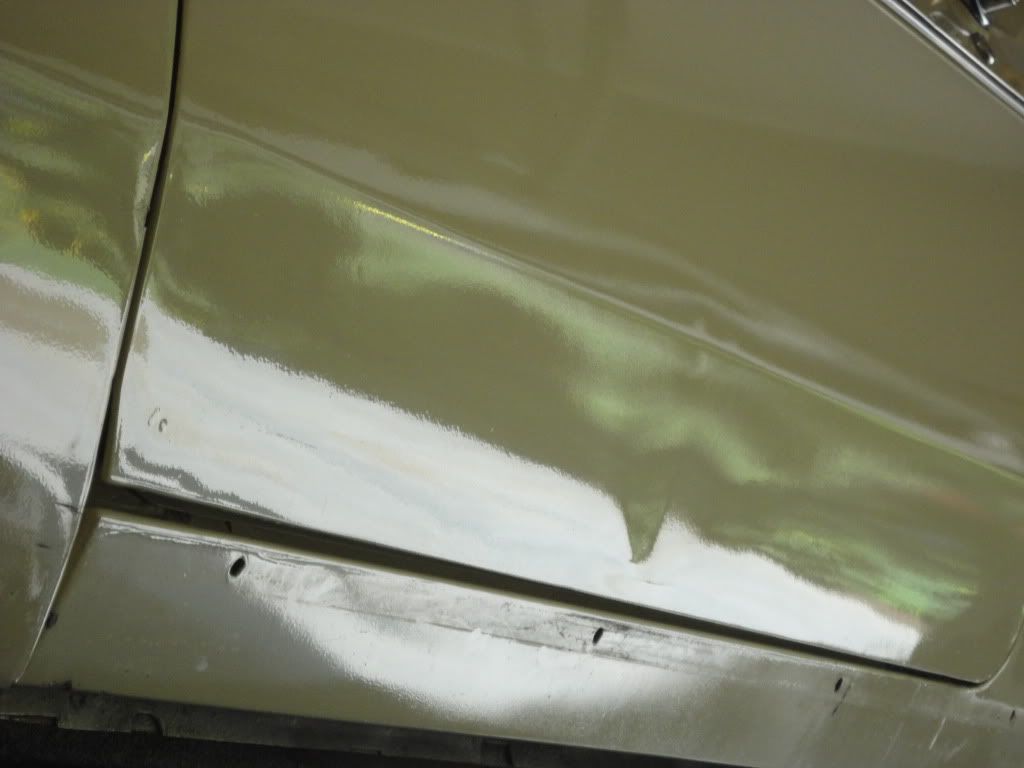

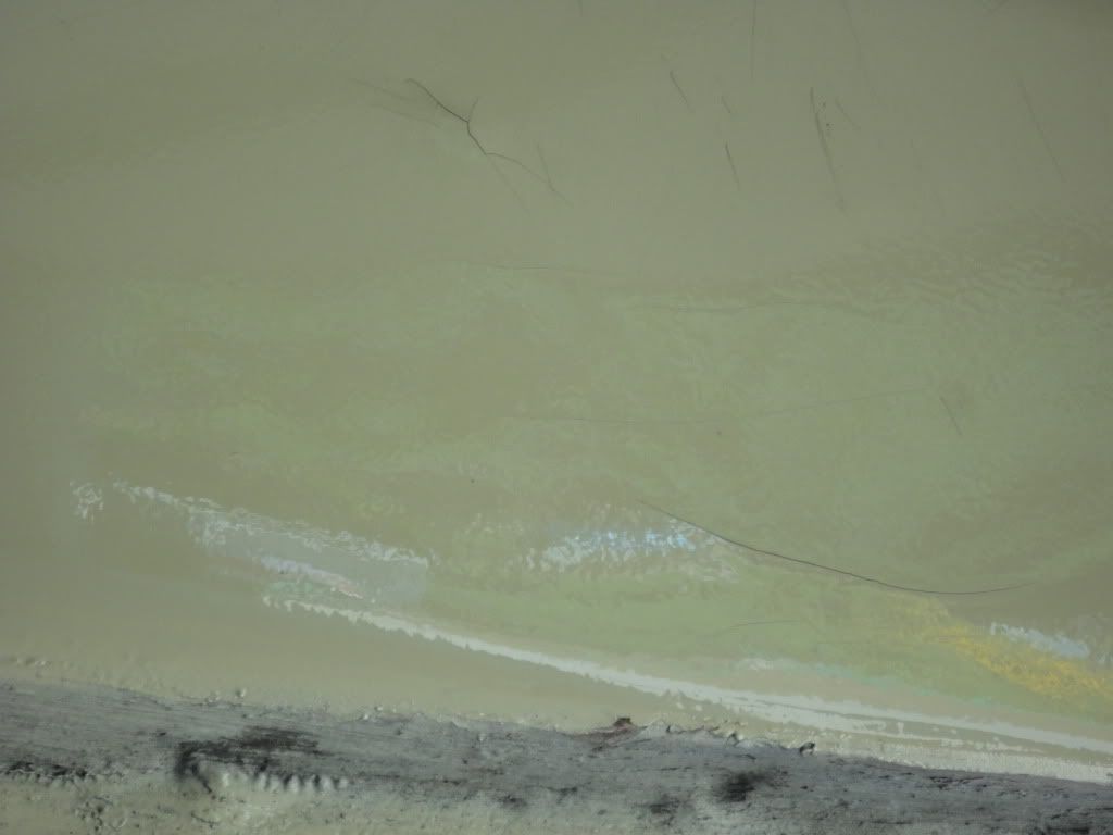

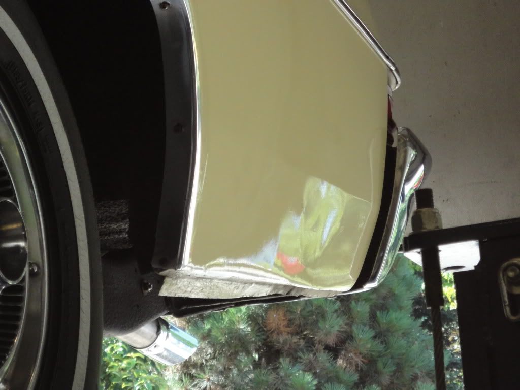

Took some more pic's of my &quot;Beautiful&quot; original paint survivor car.......The color and orange peel hides the dents as even taking these closeups it's really hard to see the true flavor of whats there.......LOL.......But, as I said before......the guy's at Puleras (Body Shop) said it's not a big deal....and with getting the two new fenders it should make their job a lot easier......now they just have to deal with the doors and quarters.......here are a couple of pic's.....
http://i13.photobucket.com/albums/a2...t/DSC03015.jpg
http://i13.photobucket.com/albums/a2...t/DSC03016.jpg
http://i13.photobucket.com/albums/a2...t/DSC03017.jpg

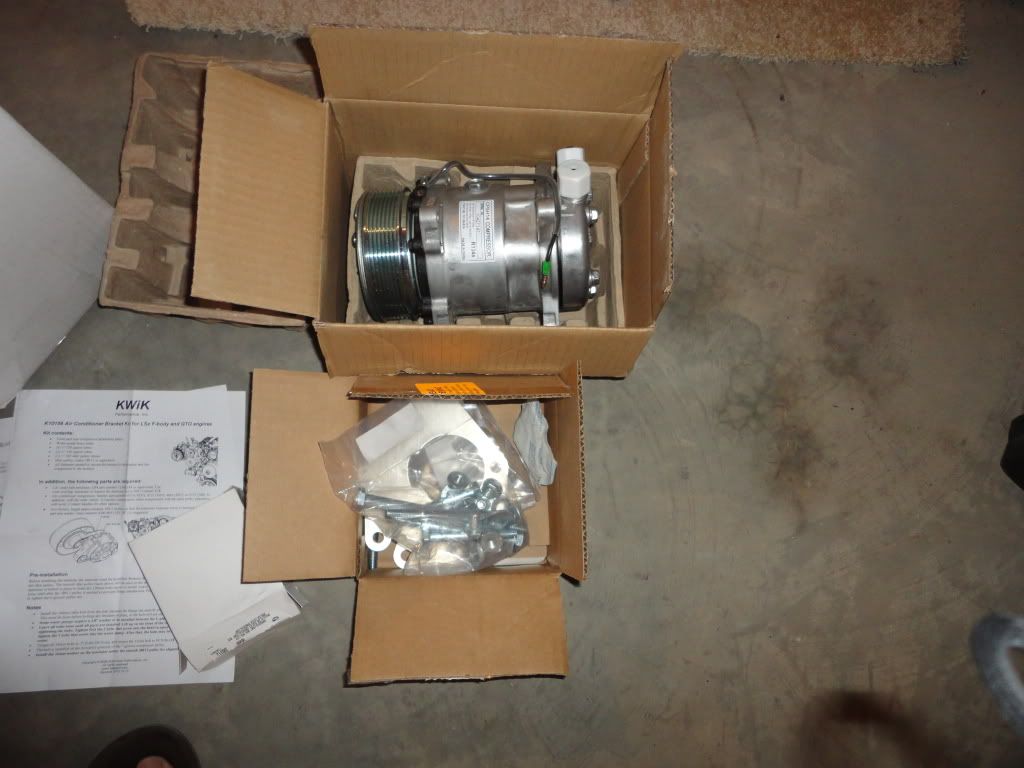

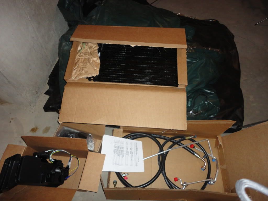

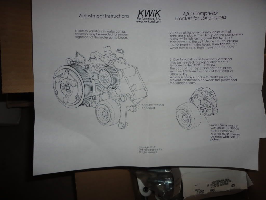

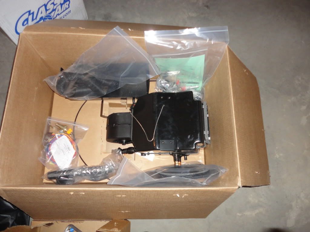

The a/c syatem showed up today also.....a sure fit system for Classic Auto Air.....when I called the other day to order it....I asked if I could get a serpentine pulley on the compressor.....the sales guy why I wanted that type of pulley rather that the stock &quot;V&quot; belt....I explained that I was putting in a LS2 from a 06 GTO and I knew I was going to have to play with compressor positioning to make it fit as I knew there were clearance issues and in the end I would be using the serpentine belt....He then asked why I just didn't buy their kit to move the compressor up out of the way and it included brackets, Idler Pulley and a belt that was designed for the GTO set-up.....I said really.....so....I bought it all and my job is getting easier again as I won't have to re-invent the wheel again....So, now the compressor is driven off the main drive belt (stock, it had a seperate belt)
This Project is getting too easy.......Here are some pic's
http://i13.photobucket.com/albums/a2...t/DSC03043.jpg
http://i13.photobucket.com/albums/a2...t/DSC03045.jpg
http://i13.photobucket.com/albums/a2...t/DSC03042.jpg
http://i13.photobucket.com/albums/a2...t/DSC03041.jpg

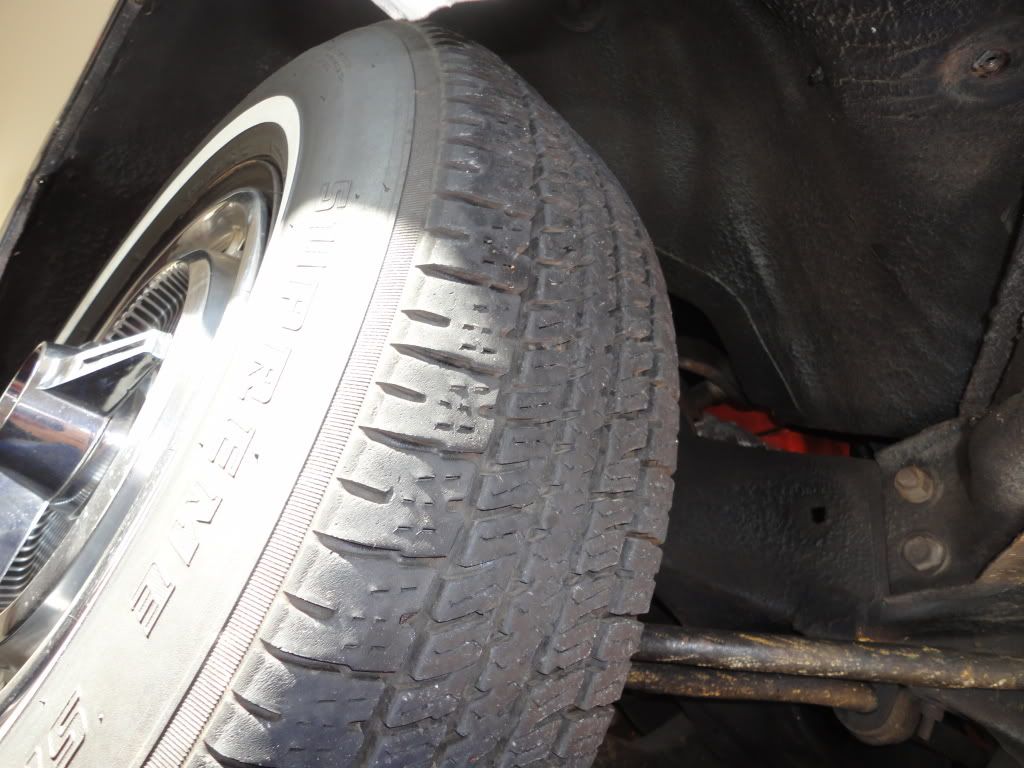

I also started disassembly of the car....I started under the car getting the engine ready for removal.....only got in a hour or so before the heat and humidity got to me and had to go in and take a nap!!....(It's what old guys do).....While under the car I noticed why when I drove my &quot;Perfect&quot; Survivor car and turned the wheels slightly, I could feel something wasn't right with the steering......Look at the front tire.....LOL....(Previous owner......&quot;This car is perfect mechanically and I would drive it to California&quot;.......LOL......My Bad)
http://i13.photobucket.com/albums/a2...t/DSC03019.jpg
Xplantdad 08-02-2011 02:46 AM
Re: Next Years Power Tour Car
That's cool! (forgive the pun!!)
Edit: Dang, you're too quick. I meant about the AC...the steering issues suck [img]<<GRAEMLIN_URL>>/frown.gif[/img]
