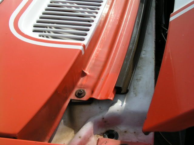

My 69 NOR Z has white overspray on the cowl. Not as much as Mike's pics above, but one side it full white, the other is lighter overspray.

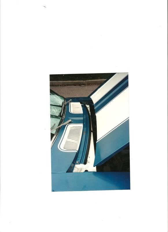

So from our collective eyes and brains...have we established that the image above shows the paint format has only been found on NOR cars so far? And the larger full-cowl paint format has been found on NOR and LOS cars?
Thanks,
Tony Huntimer
Camaro Performers Magazine
al8apex 07-29-2009 12:56 PM
Re: 1968 Z28 COWL COLOR
"So from our collective eyes and brains...have we established that the image above shows the paint format has only been found on NOR cars so far?"
correct
" And the larger full-cowl paint format has been found on NOR and LOS cars?
I would restate that to say:
And the larger full-cowl paint format has been found on all LOS and some NOR cars.

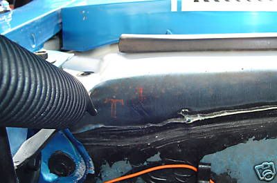

And also that many LOS cars had the area partly masked off and painted as I have stated mine and many others are.
