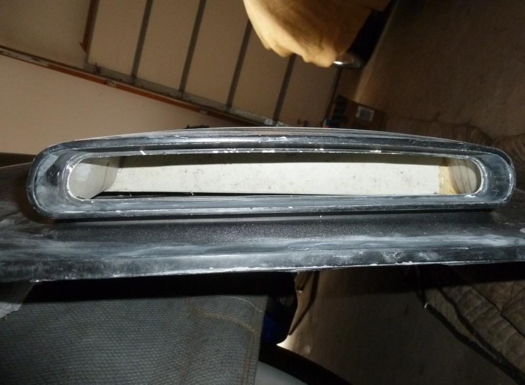

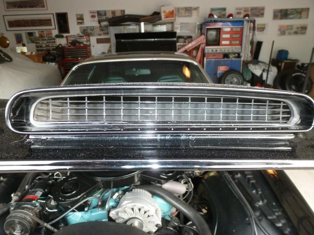

Some more tinkering on the NOS Formula hood today.
I used a Dremel tool and a file wrapped in sandpaper to reproduce the factory cut outs in the scoops. I formed the rounded edges on both ends by using a Chevy fuel pump push rod wrapped in sandpaper. It was a perfect fit for doing the curved edge areas. It was very difficult to keep the same 1/8&quot; inner edge as the original. The reason is that there are molded-in decorative grates in the scoop area that you have to transect. Some of the edges of the grates remain and some have to go, to maintain a consistent permimeter on the curved inner surface.
Here is the original Ram Air hood cut outs. The metal grates slide into a slot from the underside of the hood and are held in place by two screws.
https://www.yenko.net/ubbthreads/pics...9-p1000606.jpg
And here is my version on the NOS hood:
https://www.yenko.net/ubbthreads/pics...-p1000610a.jpg

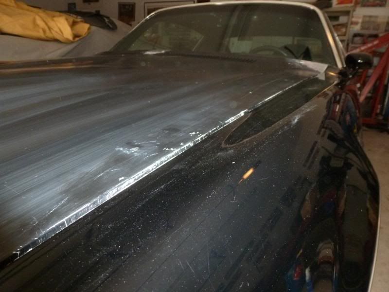

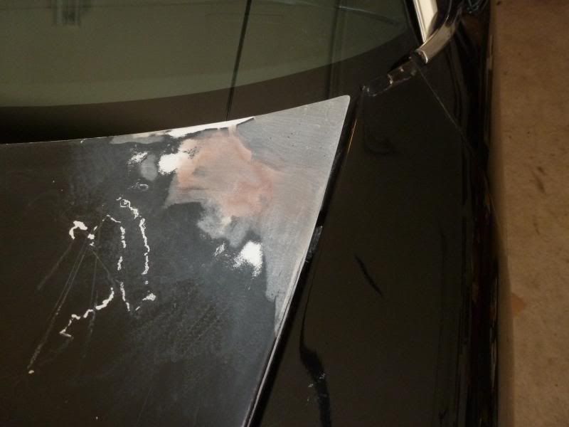

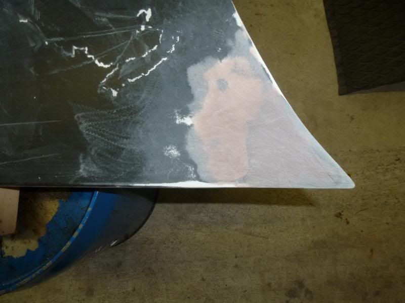

I finished the other fiberglass repair work on the missing corners by the windshield and the chipped front corners. I also spent a while grinding and fiberglassing the three cracked defroster ribs. I used a Dremel tool to make a deep groove, 9/10ths of the way through cracked area and then used the fiberglass gel repair to fill the trough I made. It worked out nicely. I even trial fitted the press-on stainless steel edge molding. (That was rather nerve wracking as you have to tap it in place with a rubber mallet to seat it fully).

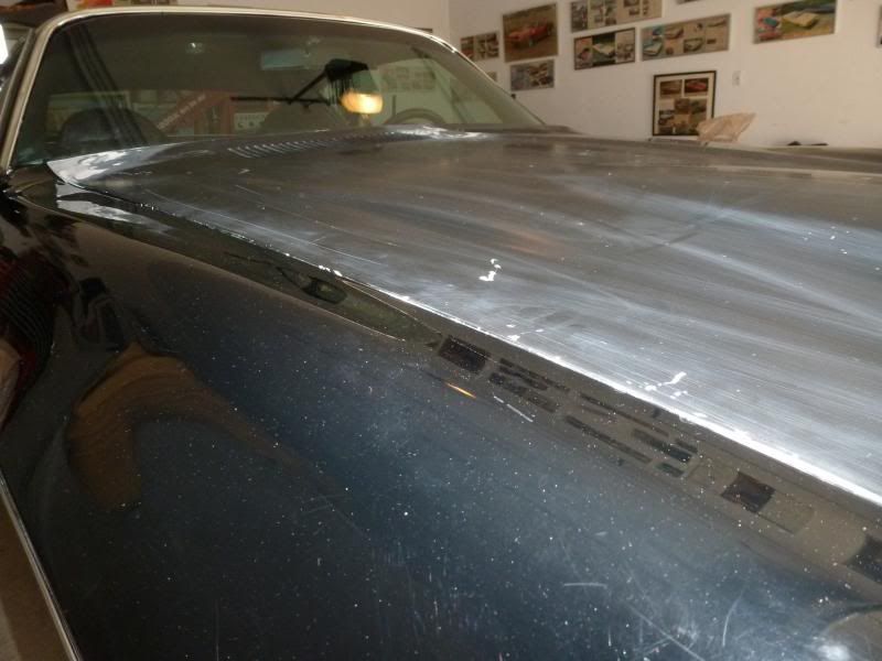

njsteve 05-27-2013 10:33 PM
Re: The New Project: Part Deux!
With the help of the wife and daughter I swapped the NOS hood onto the car (that was entertaining to say the least). I then set the hood in the right spot and readjusted all the gaps on the fenders. I noticed that I had both peaks on the hood at too high of an angle so I had to add another 3/8&quot; of an inch of the fiberglass gel to the underside of the tips and then sanded away the top sides until they matched the contours of the fenders, exactly. I then recruited the wife and daughter to once again to pull the hood off so I could do the finish work on the added material on the bottom side. After getting the hood off, they promptly went shopping.
That gave me time finish up the underside and also trial fit the screens into the scoop openings and drill the two mounting screw holes. There are actually built-in bosses that the screws go in to on the inside of the scoop area. There was also a bunch of excess bonding adhesive from the original manufacturing process that had to be ground away so the grills would slide into the factory slots. Dremel time once again.
Once the &quot;hood crew&quot; returned from their shopping spree they assisted in installing the hood back on the car. Here is the finished product before I drop the hood off at the local bodyshop to get it prepped and painted black.
http://i599.photobucket.com/albums/t...k/P1000625.jpg
http://i599.photobucket.com/albums/t...k/P1000628.jpg
http://i599.photobucket.com/albums/t...k/P1000627.jpg

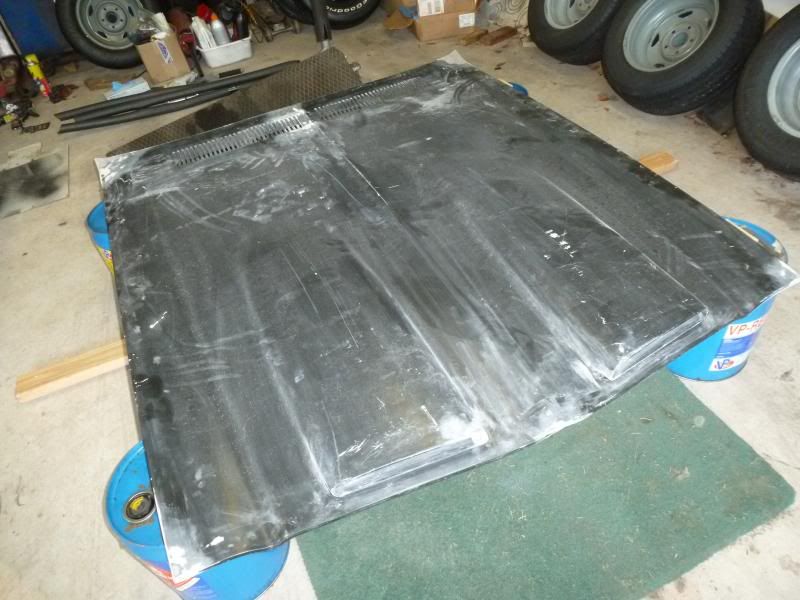

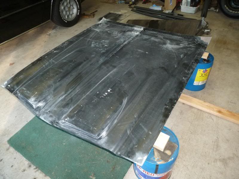

And this is the best part: the hood is dead flat with no bow in the center like all the other 40+ year old hoods out there. Right now I have the original hood sitting on four drums spanned by 2x4s with 30 lbs of weight in the middle to try to flatten the old hood back into shape. We will see what happens.
http://i599.photobucket.com/albums/t...k/P1000629.jpg
http://i599.photobucket.com/albums/t...k/P1000630.jpg

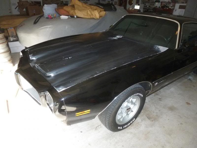

I drove the car over and dropped the hood off yesterday at the painter's shop. I then went home and bribed the wife and daughter into helping me reinstall the original hood back on the car since there is supposed to be a cruise night this weekend and maybe I'll take it out somewhere for the first time since I bought it. (I have been driving it - almost 600 miles so far, since the engine was finished, but with no particular place to go.)

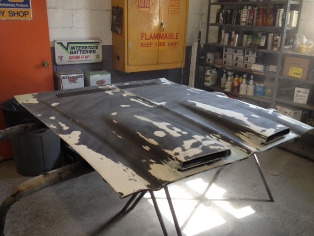

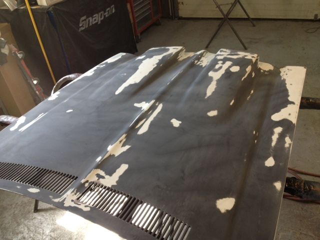

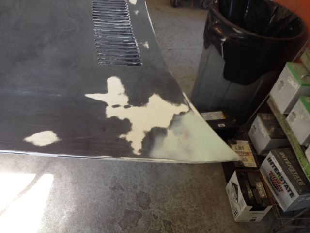

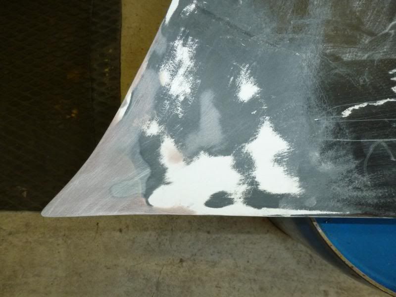

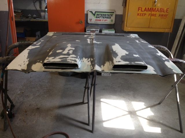

njsteve 06-05-2013 08:33 PM

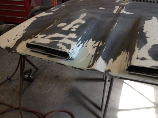

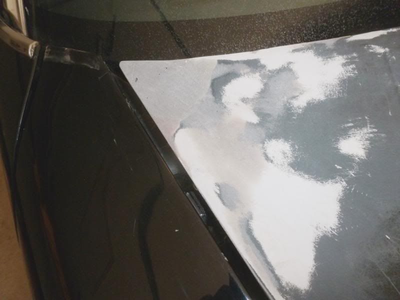

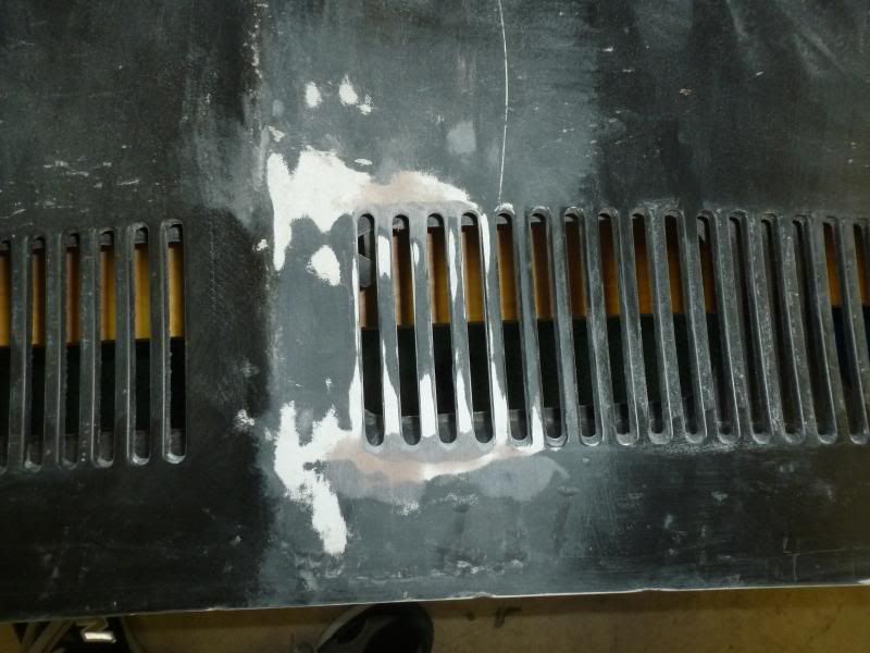

Hood in progress. The painter sent me these cell phone shots from earlier this week. He said the hood is much nicer than he thought and only needs minor surface work. (Fingers crossed). The main areas that need smoothing are the seams where the lower part of the scoop joins the upper part, along each side. There was a noticeable bonding seam.
http://i599.photobucket.com/albums/t...rk/image6.jpeg
http://i599.photobucket.com/albums/t...rk/image5.jpeg
http://i599.photobucket.com/albums/t...rk/image1.jpeg
http://i599.photobucket.com/albums/t...ork/image.jpeg
http://i599.photobucket.com/albums/t...rk/image2.jpeg
http://i599.photobucket.com/albums/t...rk/image3.jpeg
http://i599.photobucket.com/albums/t...rk/image4.jpeg
