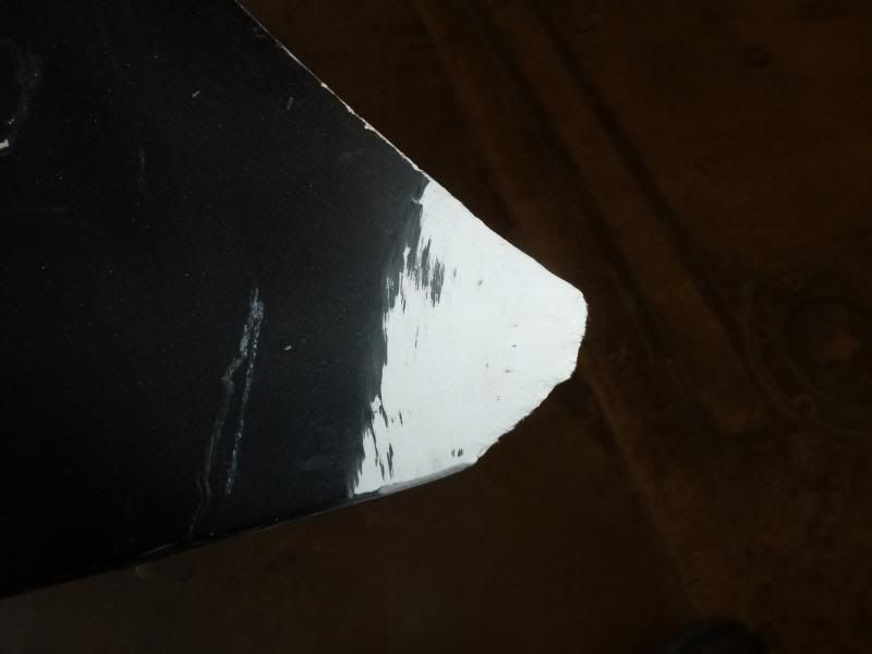

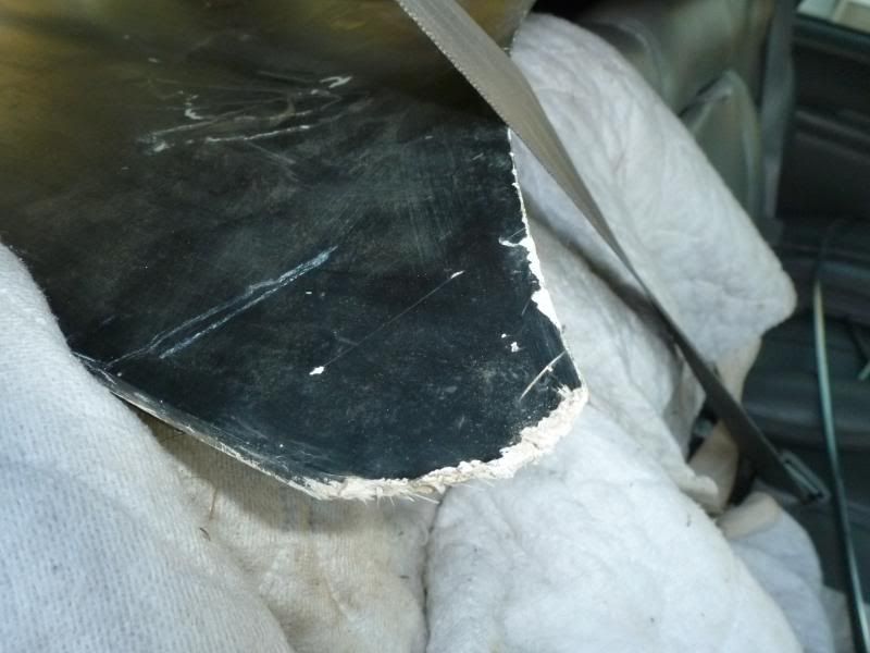

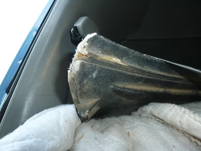

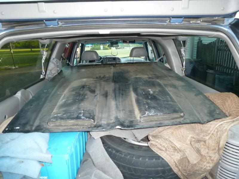

I bought an NOS Formula hood from PerformanceYears site member "The Boss," (chris) today. Definitely a great guy with some really nice cars! I went out and picked it up this morning. This will be the next project - it needs some (hopefully minor) repair work. It has been sitting in his shed for several years and before that in someone else's parts stash. Its a very nice hood, other than it being the victim of bad storage practices, most likely when it was new. Someone way back when, stood it on the windshield end and both of the fragile fiberglass corners were broken off. Ugh!
I decided to go for this NOS hood, as mine is heavily bowed up in front of the hood hinge area (a common problem with Formula hoods), some of the defroster grills are cracked, and there are stress cracks in my hood that look like they were badly repaired at the scoop bases in the front. Probably from someone closing the hood way too hard, a few hundred times.
Now I can devote less repair effort on a nicer, flatter hood. The hood is made of the same white molded glass material as the spare shaker scoop that I repaired a couple years ago. That shaker coincidentally had a similar sized section of its corner broken off. I used the bondo fiberglass filler gel and it came out really nice.

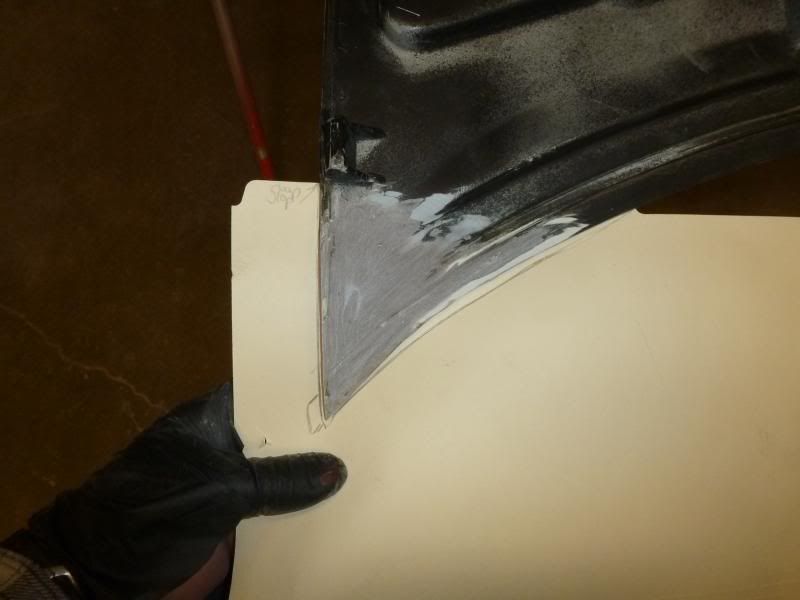

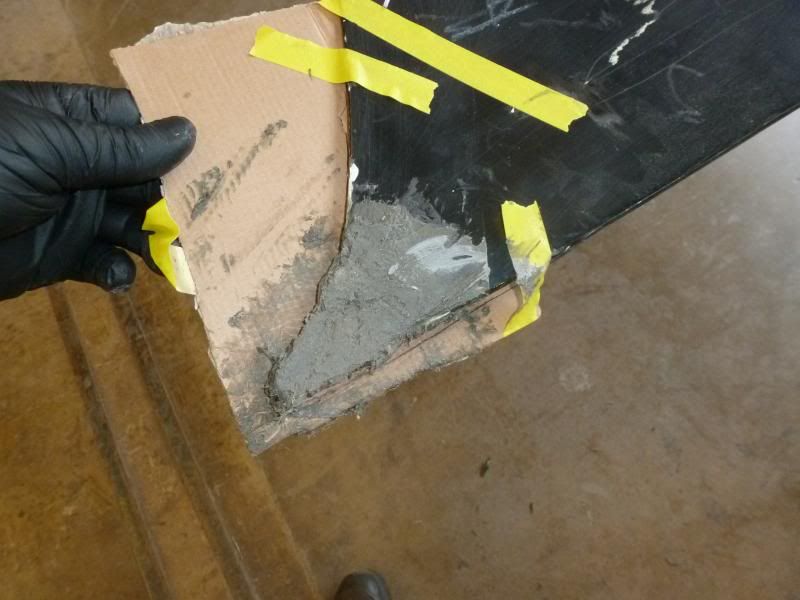

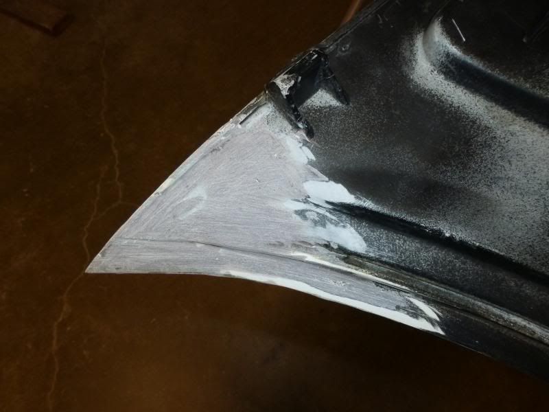

I brought the hood to the Tuesday evening Votech class and had some fun. I used the Bondo Fiberglass Resin Gel repair compound which is a fiberglass resin mixed with fiberglass powder in it.
I made a tracing of my good hood on the car, locating the template at the last molded alignment bumper about 5 inches from the back of the hood. This way I could align the tracing with the damaged hood in the same spot.
The repair compound works great. I ground down the leading edge of the break by an inch or so so there would be a longer mating seam for the compound. I taped some cardboard underneath to hold the goop and applied it "liberally." I also used a small piece of fiberglass mat and mushed it into the mixture for added strength.
http://i599.photobucket.com/albums/t...k/P1000486.jpg
http://i599.photobucket.com/albums/t...k/P1000487.jpg
I then did like Michelangelo did with his sculpture of David: When asked how he could sculpt something so realistic, he said &quot;I simply remove everything that isn't my subject.&quot; So I followed his guidance and I carved away everything that wasn't the hood. [img]<<GRAEMLIN_URL>>/grin.gif[/img]
Here's is the preliminary view with the stencil underneath. Still have a ways to go.
http://i599.photobucket.com/albums/t...k/P1000494.jpg
http://i599.photobucket.com/albums/t...k/P1000493.jpg
After getting to this stage I then used a Dremel tool and ground grooves across the seam area and reapplied the firberglass gel. I will also do this from the top as well so it gives two sepearate layers of &quot;finger joints&quot; above and below the seam, strengthening the bond so it is not just a flat surface to surface bond, but a sandwich of several bonds overlaying each other.

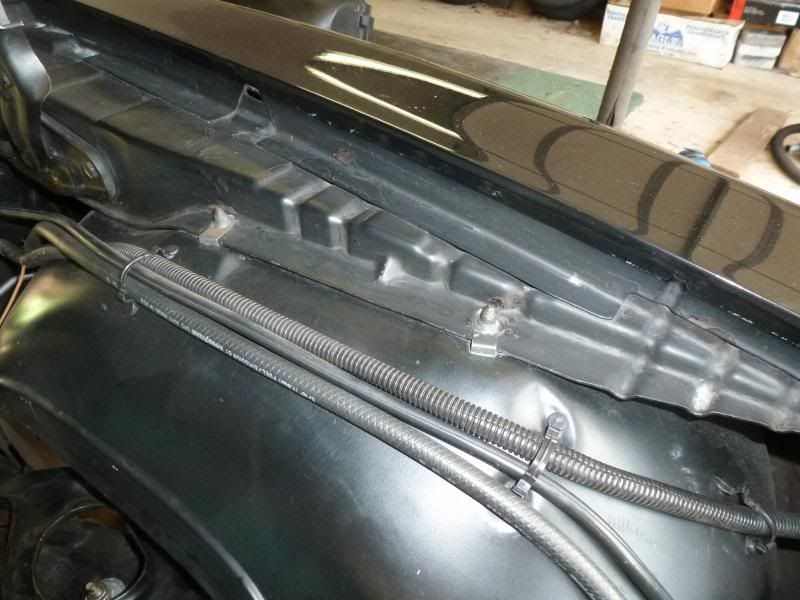

Since everyone's pet peeve on the 70-72 cars is the wrong style fender support structure on the 73 and up replacement fenders, I decided to convert the passenger side fender that was installed a year or so after this car was originally built. I have an original-owner engine compartment shot that shows the replacement fender in place with the brace mounts sticking out like a sore thumb.
I was able to obtain a donor inner fender support structure from a 70-72 fender thanks to another member of the Performance Years board and brought it all to the final night of the votech class yesterday.
Here is the passenger side fender marked, preliminarily cut and the two spot welds cut, where the incorrect raised brace mount is:

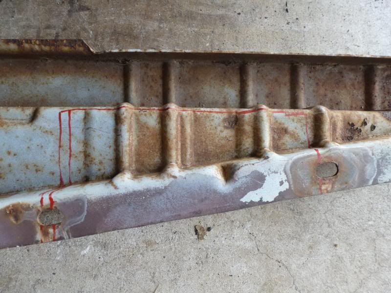

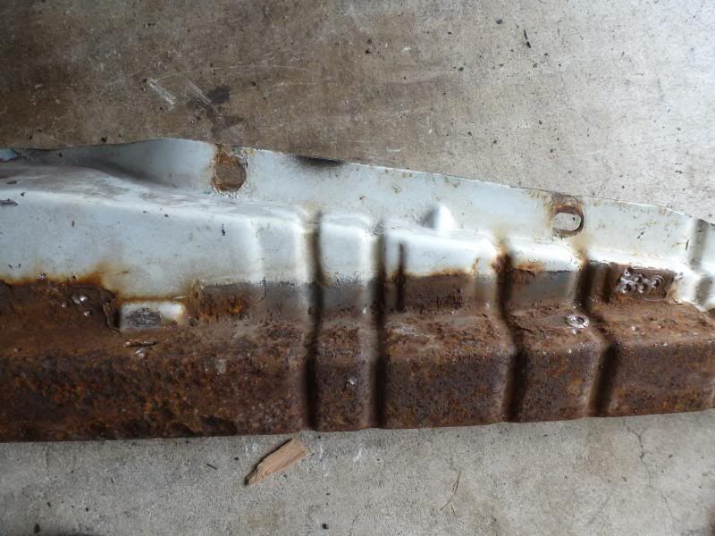

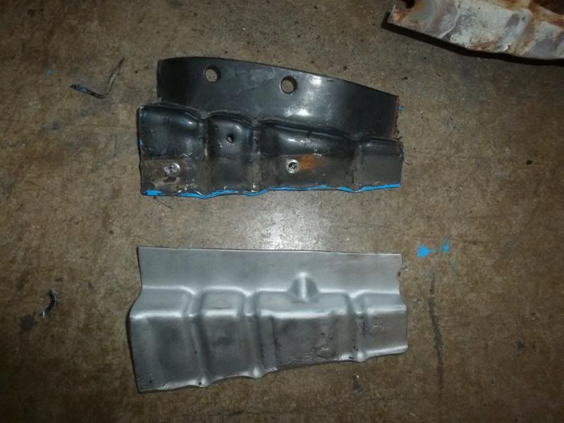

Here is the donor inner framework that was removed from a 70-72 fender. It is thick heavy gauge steel, not sheet metal.
http://i599.photobucket.com/albums/t...k/P1000573.jpg
http://i599.photobucket.com/albums/t...k/P1000572.jpg

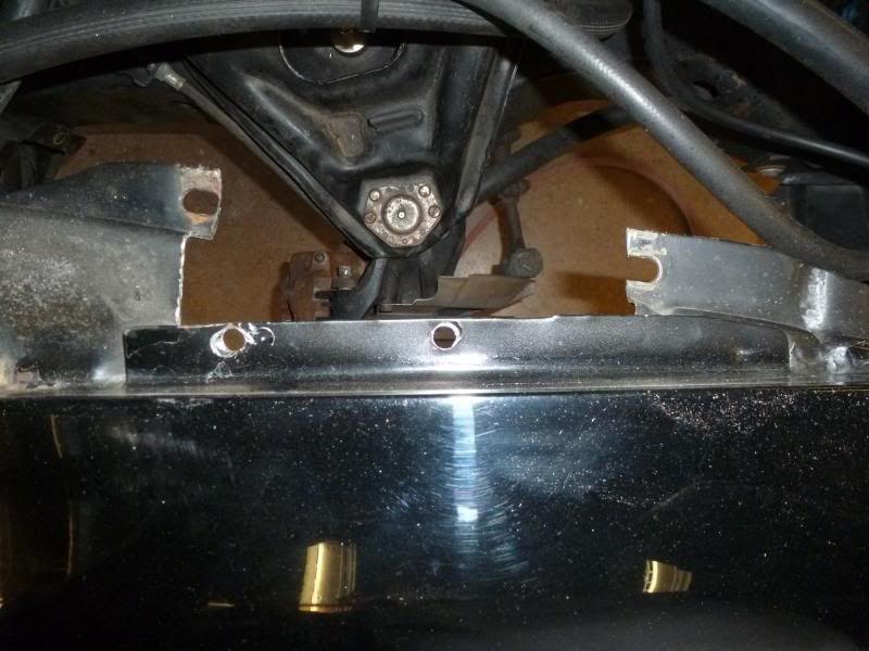

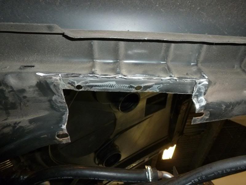

I used a cut-off wheel to carefully trim up to the upper wrap-around area of the fender sheet metal and then went underneath (after removing the inner fender), and cut the remaining portion away. I also used a spot weld cutter to detach the fender flange from the inner brace (the two holes visible in the photo).
http://i599.photobucket.com/albums/t...k/P1000580.jpg
Underside view:
http://i599.photobucket.com/albums/t...k/P1000579.jpg

I then marked the same sized section from the donor frame and used the cut-off wheel to remove it. After some final trimming, grinding and sandblasting, it primed with weld-through primer and clamped into place.

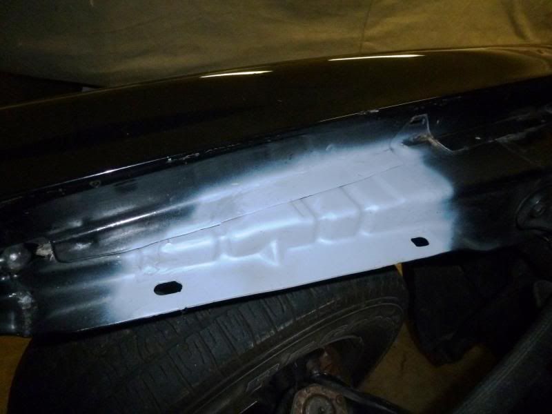

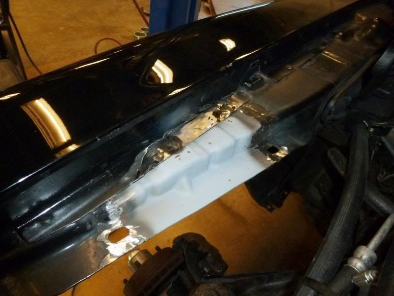

We then welded the topside and underside and ground away the excess.
http://i599.photobucket.com/albums/t...k/P1000589.jpg
Here is the semi final repair in primer, prior to any final cosmetic bodywork. Now it looks like correct year fender for 1972.
http://i599.photobucket.com/albums/t...k/P1000592.jpg
Much better than the &quot;sticking out like a sore thumb&quot; 1973-81 replacement fender.

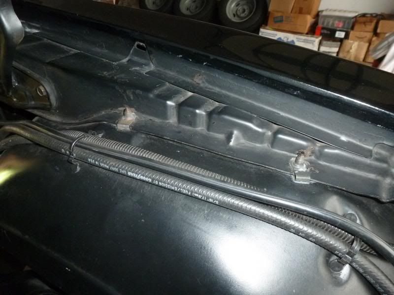

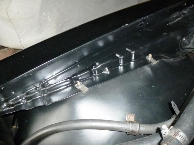

njsteve 05-24-2013 10:37 PM
Re: The New Project: Part Deux!
I got the section painted and reinstalled the inner fender. Here is the finished product. Looks like a 1972 fender once again.
http://i599.photobucket.com/albums/t...k/P1000603.jpg
As compared to the actual 1972 driver's side fender:
http://i599.photobucket.com/albums/t...k/P1000604.jpg
